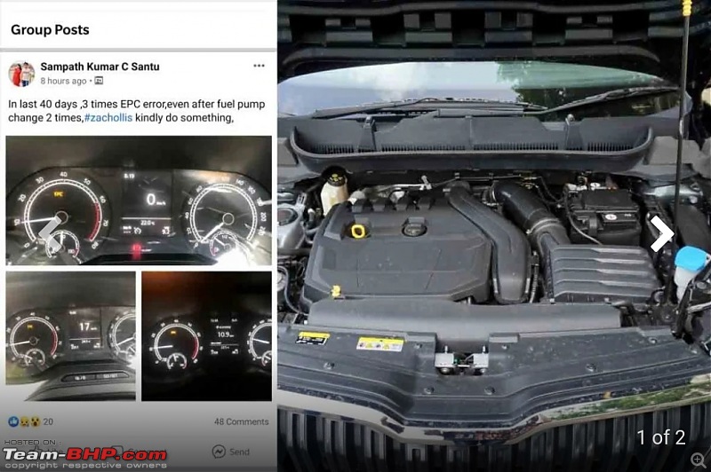

A Kushaq with a replaced fuel pump breaks down, apparently the "robust" pump, but may not be due to fuel pump issue this time.
According to the Kushaq owner, he has faced the EPC error 3 times in just 40 days. He had his SUV towed away to the service centre. During the first time, it took one week to get the sensor replaced. After facing the EPC error the second time, the fuel pump was replaced with a more robust unit. That took 2 days and the owner still experienced the EPC issue after that. The third time, the Skoda officials told him that they will do a software update. Being a doctor by profession, the owner is struggling to spare so much time on the repairs of a brand new car. He had posted this information on a FB page to make Zac Hollis aware of this. Zac replied to him asking about his details to get in touch with him to get the issue fixed. The Kushaq owner has attached various photos of the multiple EPC errors.
Source -
I see Zac Hollis later clarified that the third EPC issue was not due to the fuel pump and there are no reported breakdowns of the robust fuel pump.
Meanwhile, we are not done with the sight of Kushaqs on flatbeds as Skoda is still working on getting the robust fuel pumps for all existing customers -
