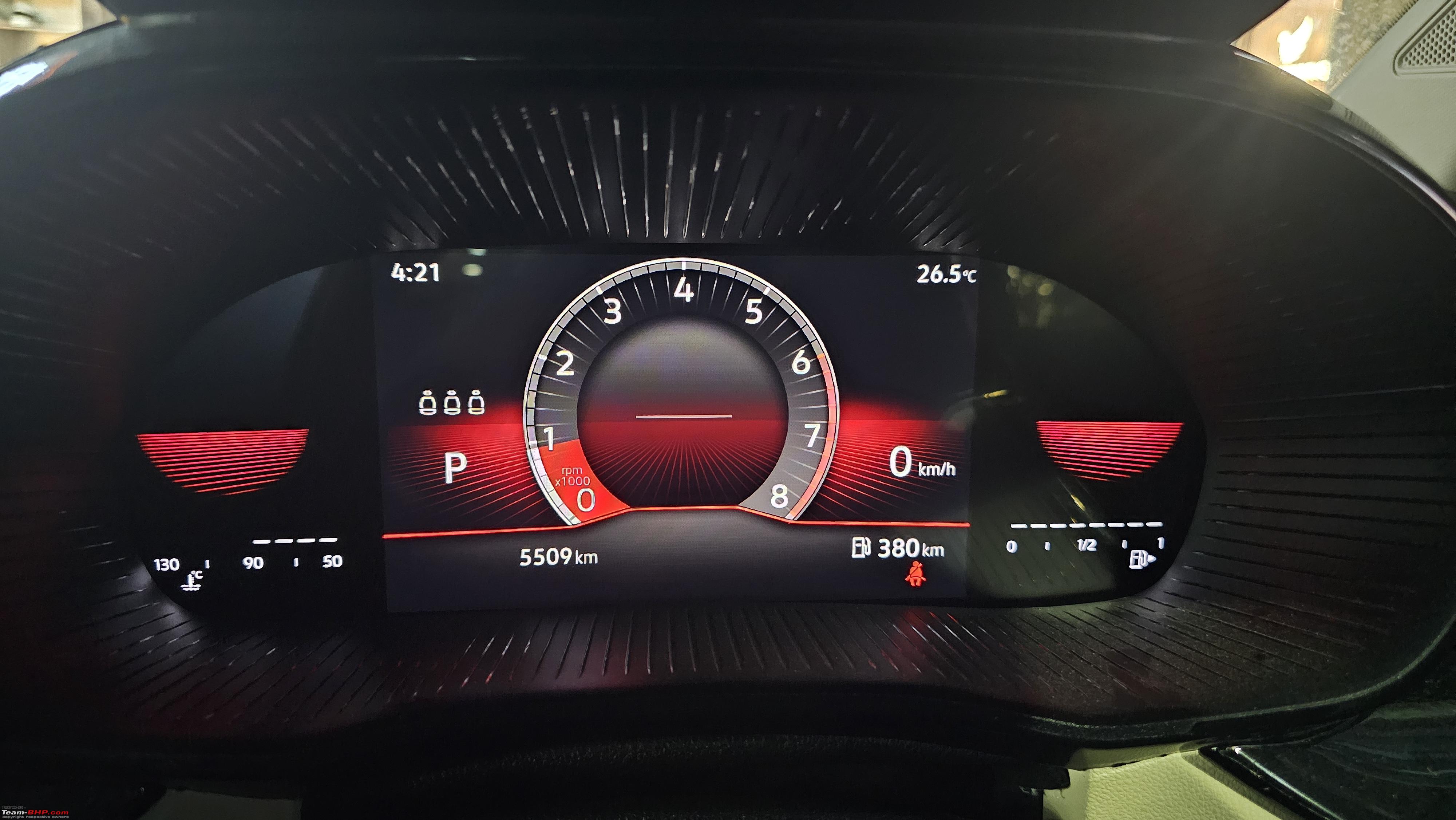

Thats surprising. Mine is mid-March 2023 manufactured GT, OBD2 and E20 compliant, and I dont have rear seatbelt reminders. Can you please post a snapshot of the rear seatbelt reminders in your cluster?
mtnrajdeep is offline
Old 3rd May 2024, 21:25   #51
Join Date: Jun 2023
Posts: 87
Thanked: 107 Times
Re: VW Virtus - Tweaks, Mods & Adaptations using VCDS
Sure, here it is:

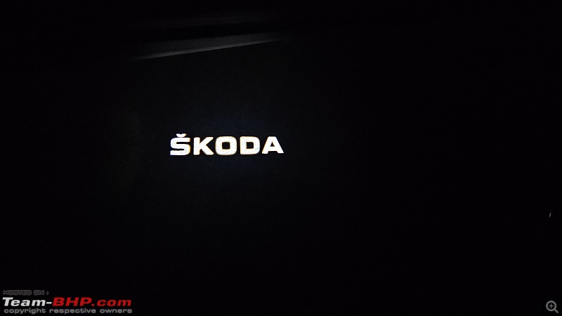

Also, I got the puddle lamps installed from PPS Skoda, Mysore Road today. Costed me 3999 and installation took about 45 mins. Nothing was charged for the installation.

Sure, here it is:
Thanks. I guess VW started providing this much later than Skoda. Mine is a Virtus GT Plus.
