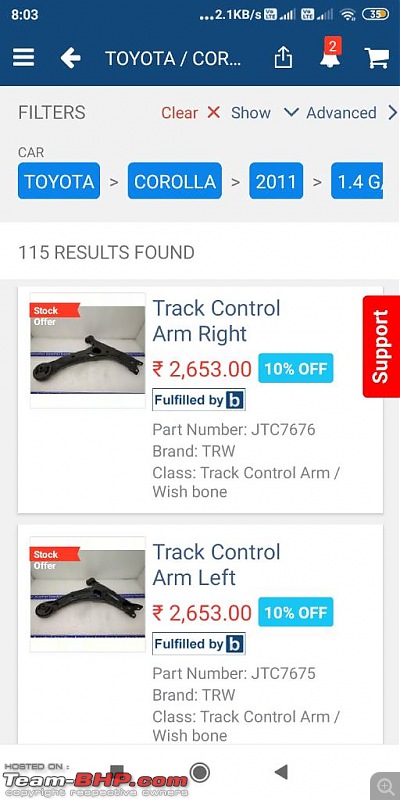

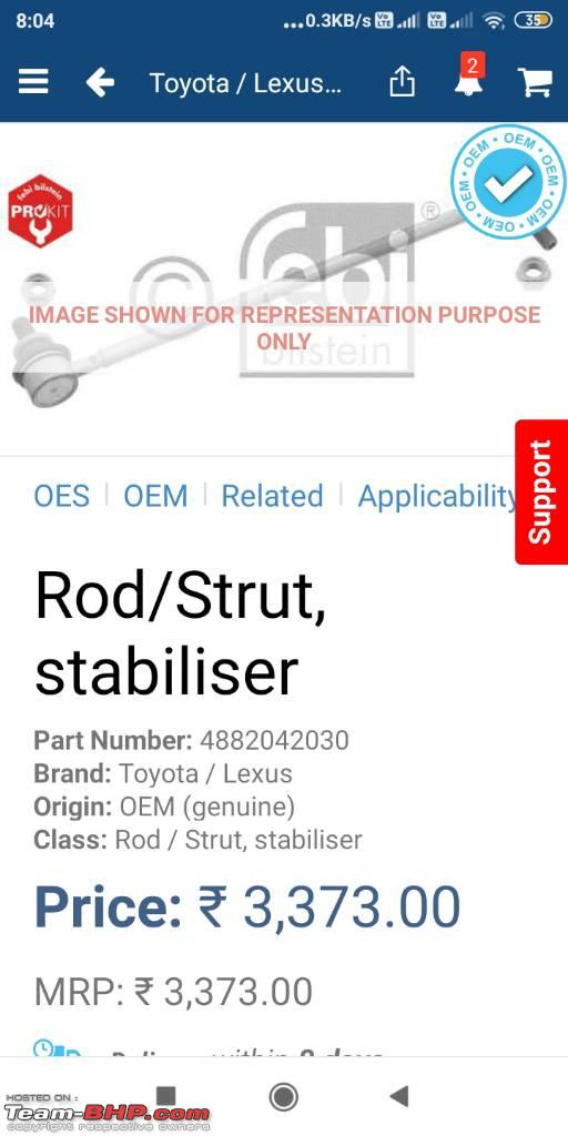

Hi, there are different components in steering rack and suspension set up which would cause sound issues starting from outer ball joints , inner ball joints, and tie rods. Please get it checked at FNG, and you can get it fixed in minimal costs, say 10K to 15K. Generally these above components tend to fail in steering rack, not 'internal components' like powersteering pressure pump and rack and pinion system. So it doesn't make sense to change complete steering rack. Service center people in general don't do repairs, they just do replacements. OEM manufacturer for these parts are Toyota/Lexus themselves. But you can get aftermarket parts from RANE, etc for tie rods and ball joints. Also get your control arms checked, wornout bushes can also cause these sounds while driving on potholes.
Coming to clutch, Toyota/Lexus manufactures them. I bought the same for my Innova. There is Toyota name engraved on it. You can get aftermarket from Valeo, Luk too. But I suggest buy original clutch plate, pressure plate and release bearing and get them changed at your FNG. We changed our Innova's clutch plate at 1,50,000 kms not it is worn out but the release bearing was producing noise. Instead of changing only one component , we got complete set replaced, clutch is very light now.

Thanks a to me for your help. This clarifies why i wasn't able to find a manufacturer for both these parts.
I don't think it's the control arms that have failed as I had those replaced about 10000 km ago.
I will take your advice and visit a FNG for the steering rack though, they might be able to get me an alternative.
About the clutch, my car has completed 127000 km, and I face gear slotting issues sometimes when the car is not moving, so I guess a clutch replacement is now due. There is a slight play in the clutch pedal as well. I was just not sure about how much it would cost at the showroom, will inquire there.
