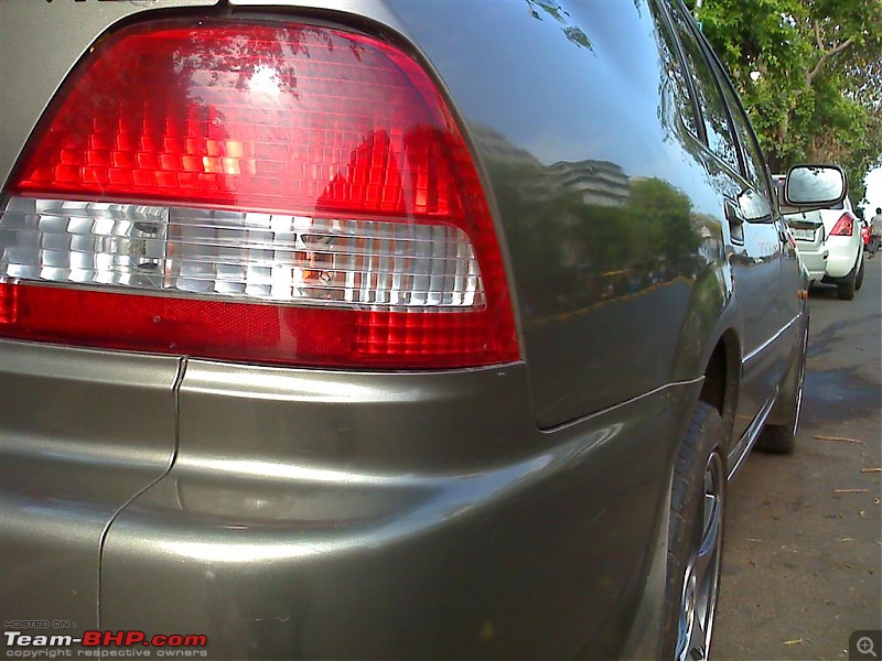

I got this magnetic paintless dent removal job on my Vtec. Worked like a charm.
My post elsewhere on the forum:
4. Two dents removed : His friend has that magnetic device which can suction-remove dents (only a 15 minute job...no need of painting). I had two on the right side, from the tight parking spot below my office (pedestrians & motorcyclists). Take a look at the pictures:
The bottom part of the door (below plastic moulding) had a deep annoying dent. That magnetic thingy has removed 99% of the dent. Only if you stick your eyes to the door can you tell of some minor unevenness (spell check)
The entire body panel behind the rear door was dented (probably by a pedestrian leaning on it or a hard football hit). Again, it's 99% gone, though if you look very closely in person, you could tell.

I did use such service before in Mumbai, it was at kurla somewhere on the eastern highway, basically this is even done for coated steel sheets in factories if they get dented while handling. Very skilled job. They go about with little hammer and a flat base plate. The only condition being that the paint should be strong enough to bear all that little hammering (no paint peel off), and the deformed part must not be too deformed . Actually when dented the metal stretches a bit, if it deforms too much then it is difficult to put back.

Last week, a colleague of mine got a decent sized dent on his SX4's rear bumper removed using a dent removal service, and sent an email about it to a few of his colleagues and friends, in case we also wanted to utilise this service. I've seen the results, and they are quite impressive.
With my colleague's & the dent removing guy's permission, I'm copying the email contents below:
"I had read one article in Loksatta about a person who repairs the dents of your cars. I called him and tried getting my car dent repaired from him. He comes to your house / office with his kit (a cream of some sort, a halogen lamp to heat the bumper and a magnet to create a vacuum on the bumper), and works at your site. He took less than 30 mins to remove this dent from my bumper. He charges Rs 500 per dent (Metal or bumper). See if you need his services. I had asked 3 service stations before getting this done. All had quoted Rs.1500 to 2000"
Contact: Sudheer Gaikwad - +91 9552629516. [You can give my colleague's reference (name: Kedar Kulkarni) to this gentleman]. He operates in Pune only.
NOTE: I am not associated in any way with this dent removal service. Am just posting this as an FYI message, and to help out a budding entrepreneur. Interested folks can call him directly to avail of this service.
Photos - Before and after:
