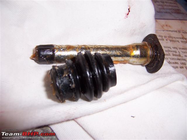

You will need to have the following equipment/tools with you:
  1. Jack
  2. Wheel Spanner
  3. Ring/Socket spanner (10-12mm)
  4. Caliper Pin Grease
Removing the caliper pins:
  • Jack up the front wheel one at a time.
  • Remove the wheel
  • You will now be able to see the brake caliper (Refer sample image below)
(Pic Courtesy: Google Images)
The 2 bolts that you see marked in Yellow are the ones which secure the caliper pins that look as below:
How to remove the pins:
  1. Using a Ring/Sprocket spanner, loosen pull one bolt out
  2. After pulling the bolt out, the caliper assembly is now held only by the second bolt.
  3. You can now move the caliper assembly over the pivot (since the first bolt is still secure) and now you will now have access to the caliper pins. By merely pushing the rubber sleeve pull the caliper pins out.
  4. Grease the caliper pin thoroughly and put it back into the designated place ensuring the rubber sleeve is also fixed in place
  5. Tighten the bolt again
Follow the steps 1-5 again for the the second caliper pin.
CAUTION: Please do not fiddle with anything else except for moving the caliper assembly to access the caliper pins. Ensure the car is resting on Handbrake or slotted in gear and no attempt if made to depress the brake pedal while the caliper is moved from its position.

This is a known issue that crops up very frequently depending on the kilometers driven and the nature of roads. This is absolutely nothing to worry about and regular greasing and periodic replacement will do.
Additionally, there are various fixes like putting a rubber ring or wrapping the aluminium tape (from a soft drink can) over the caliper pins but eventually the noise crops up later on.
Basically, the Dryness of these pins results in metal-metal contact whenever brakes are applied or driven on bad roads.
Caliper pins should not cost you more than 500/- for 2 pairs for a Santro.

This problem started happening after a suspension job was performed by H.A.S.S. on the front left tyre. So I'm inclined to believe that the issue is lack of lubrication on the back side of the caliper.
How serious could this issue be ? Can I wait till my next service visit to get this problem rectified ? I hate unnecessary visits to the service centres.

^^ if you know a FNT(friendly neighbourhood technician) ,you could get the thing inspected - and have the caliper pins greased just to eliminate this doubt.
No other place in the brake mechanicals need lubrication- a wee bit of grease on the caliper pins is about it.
