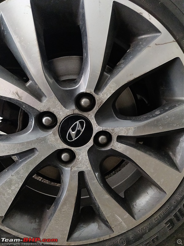

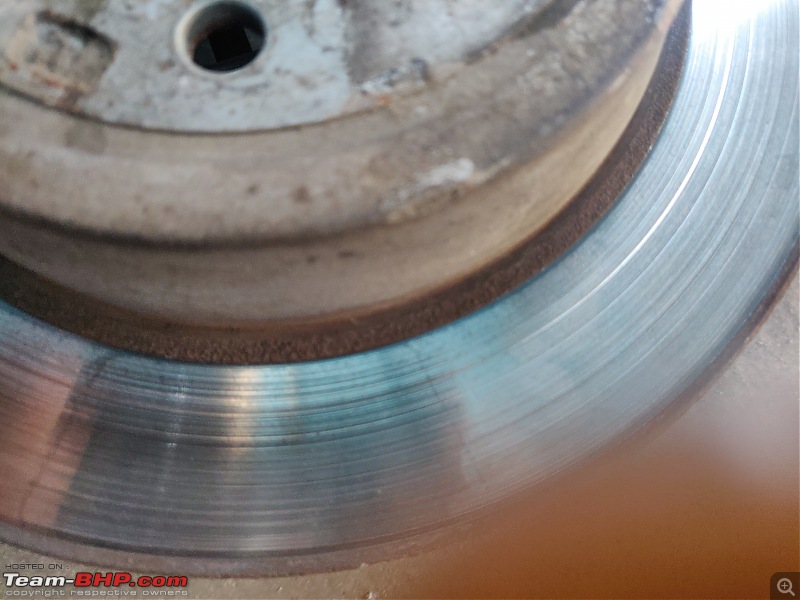

Thanks again sir. I have done the brake servicing as suggested. Done the disc rotor skimming, and new brake pads. Brake bleeding was also done.
After bedding in my brakes are definitely better then before. The bite is as good as it was when car was new.
Attaching photos of brake disc before after rotors
drsachin is offline   (2) Thanks
