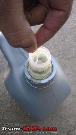

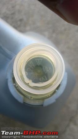

Recently did an Engine-oil change in my Aria here's my experience so far:
1. Stock Oil (Castrol GTX Diesel)- Too early to comment
2. HP Milcy Super 20W 40 - NVH very high
3. Castrol GTX 20W 40 + Bardhal - NVH very low compared to HP
4. Mobil Delvac1 - NVH Much lower than Castrol GTX in a cold start, once the engine heats up no noticeable difference.
Bought the Mobil Delvac1 5L can with MRP Rs. 5000/- @ Rs. 4000/- i.e. 20% discount.
20W40 is the wrong grade. Use 15W40 or lower.

Anna, he is using 5W40 (see the can) - so should be good ..
