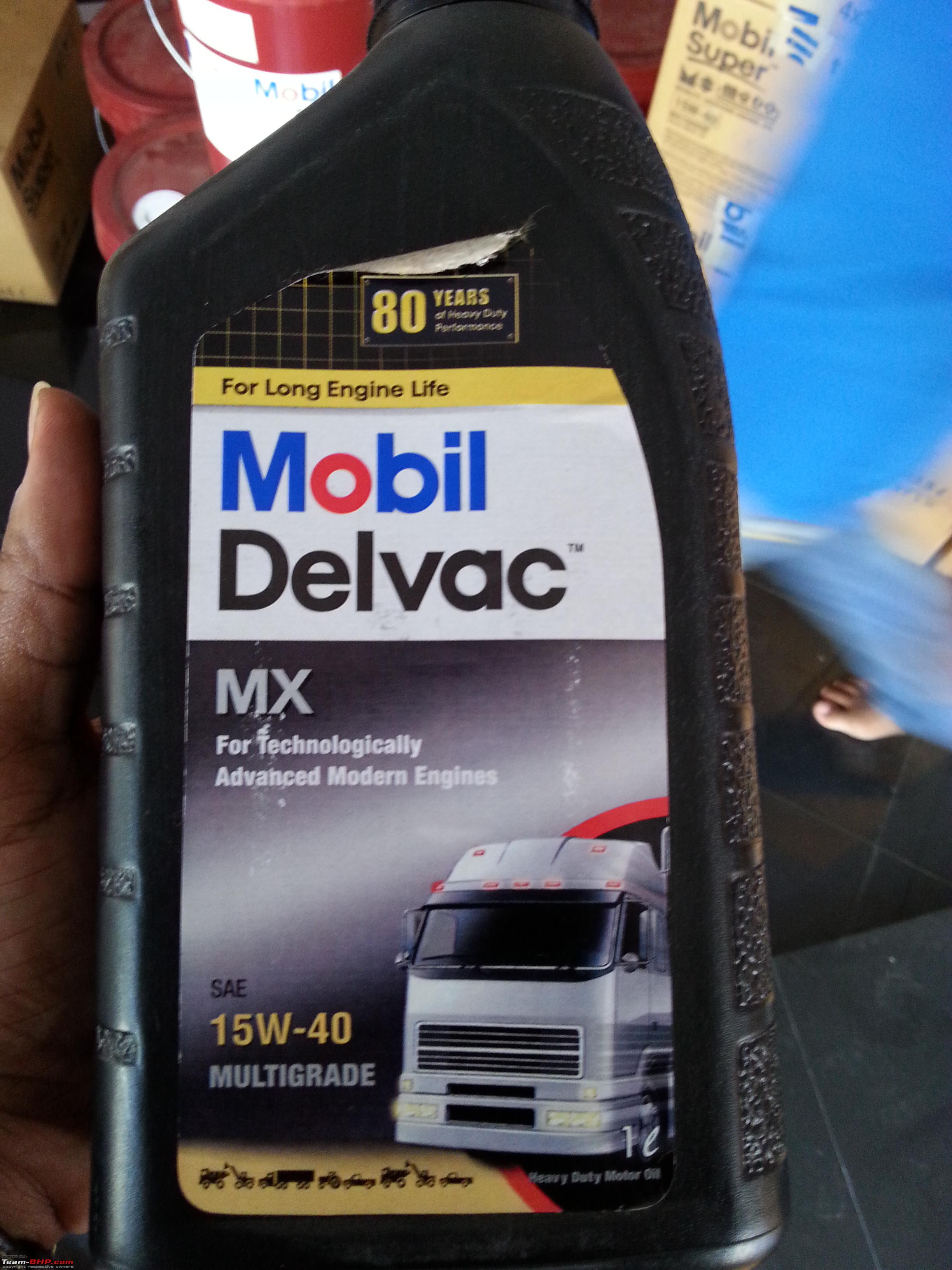

in my 4+ years, 1 Lac+ KM of Xylo E6 ownership, I had always used the M&M supplied oil, which was SERVO OEM. Earlier the MMASS used to pour Maximile, and then they migrated to FEO variant. Both oil match the specs as mentioned in the handbook - SAE 15W40 API CH-4. I have been replacing it every 10-12K KM (sometimes even at 8K KM), as opposed to the handbook saying of 20K KM !
I was in Vadodara few days back, the ODO was ~102K KM. Since I had some time in hand, thought of a task. Though very prematurely (~2500 KM), I decided to change the oil and selected the much praised Mobil Delvac MX 15w40 API CI-4. After hunting in many shops, I could locate only 1 ltr packs at the distributor himself, which he was kind enough to serve & offered in Rs.290 per pack. Took 7 packs and from another spares shop got the oil filter (Rs.150/-). With this raw material went to a local garage, which I knew of doing decent works.
It has been about 2K KM running on this MX oil, including another trip (yes!) to Vadodara n back. So far I havnt observed any significant changes in the vehicle feel, maybe the good work is internal initially!
I have tried Mobil Delvac MX 15w40 on Bolero DI engine and have observed no major differences compared to Maximile. Infact i observed the mobil delvac becoming darker & thicker soon in my Bolero. So I stick to Maximile or Valvoline for my Bolero. Keep a watch and update us.
regards,
At 1 lakh km difference will be very difficult to fathom over feel, if you really want to experiment then go back to OE oil and see if there is any difference
Oil darkening and thickening is a sign that it is doing its duty, these oils with higher detergent should work better and darken faster. If it stays clean longer means either you have a squeaky clean engine or a lazy engine oil.

in my 4+ years, 1 Lac+ KM of Xylo E6 ownership, I had always used the M&M supplied oil, which was SERVO OEM. So far I havnt observed any significant changes in the vehicle feel, maybe the good work is internal initially!
Well I echo your findings if vehicle is well maintained and oil was changed regularly you won't find any dramatic improvements with an excellent oil.
May be spending money in engine mount replacements will give better results then spending on more frequent oil changes.
However this does not mean that we should switch back to lower grade OEM oil
a CI4+ oil has better viscosity then CH4 anyday and cost is nearly same so it's worth sticking to Delvac MX or Shell Rimula R4 over OEM CH4 oil
