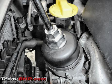

I too wish to change the oil filter. I have found the one as shown in the picture (this is not the actual image from my car). I suppose, I have to replace the filter cartridge. Which one to buy? I've not done any research on oil filters. so I will go with your suggestions.
The pic you have shown,seems to me of that of the Fiat Mjd.I dont know what type of oil filter the i20 diesel has.The thumb rule is when you change the oil,change the filter too.It's always better to buy from the HASS.
You might be aware that all Hyundai Original parts are now available off the shelf from Advaith Mobis. If you have an outlet near your loaction, just walk in, give the VIN number of your vehicle and they will be able to identify parts which your car has. Oil filter cartridge can be procured based on that. Last couple of services on my Verna CRDI was done this way. Bought Air filter, Oil Filter and Diesel filter from Advaith Mobis. Also bought the front brake pads as the car had crossed 50000km. Bought 5 lit Mobil Delvac 1 online from 99rpm.com. Took to the car to my friendly neighbourhood workshop and got the service done while I waited. Around 1.5 hrs total.

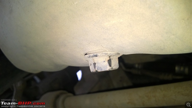

Came home and started working with my car. Tried to get under the vehicle and unbolt the Engine Oil Drain Plug. Cleaned the area around the bolt first.
I've read in the forum and seen many videos on Youtube for instructions. Everywhere they mentioned that the bolt will come loose without much effort. I didn't have the wrench tool but used all the following tools and tried to loosen the bolt.
To my dismay, the bolt is very reluctant to turn which resulted in this
I didn't wish to do much damage. So I stopped and left it as such. As it was a weekend, I didn't find any workshops in my locality.
Always use a ring spanner or a socket to loosen the drain bolt. An open end spanner will slip easily and damage the bolt head.
Lesson learned. I have the sockets with a ratchet (interchangeable). But one size didn't fit the bolt and the next size was loose. Thats why I tried with open-ended spanners. BTW, the drain plug was too tight as if it was welded. Think the mechanic would have tightened it with electric spanner (or he had good muscle power) the last time the oil was drained and replaced @50000km.
