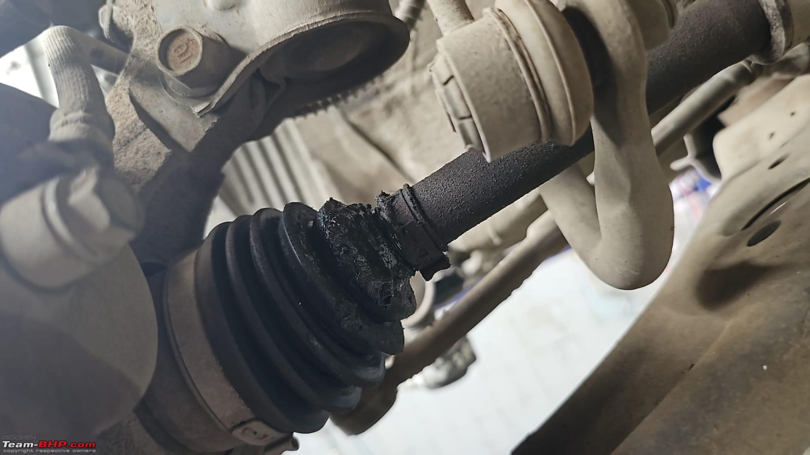

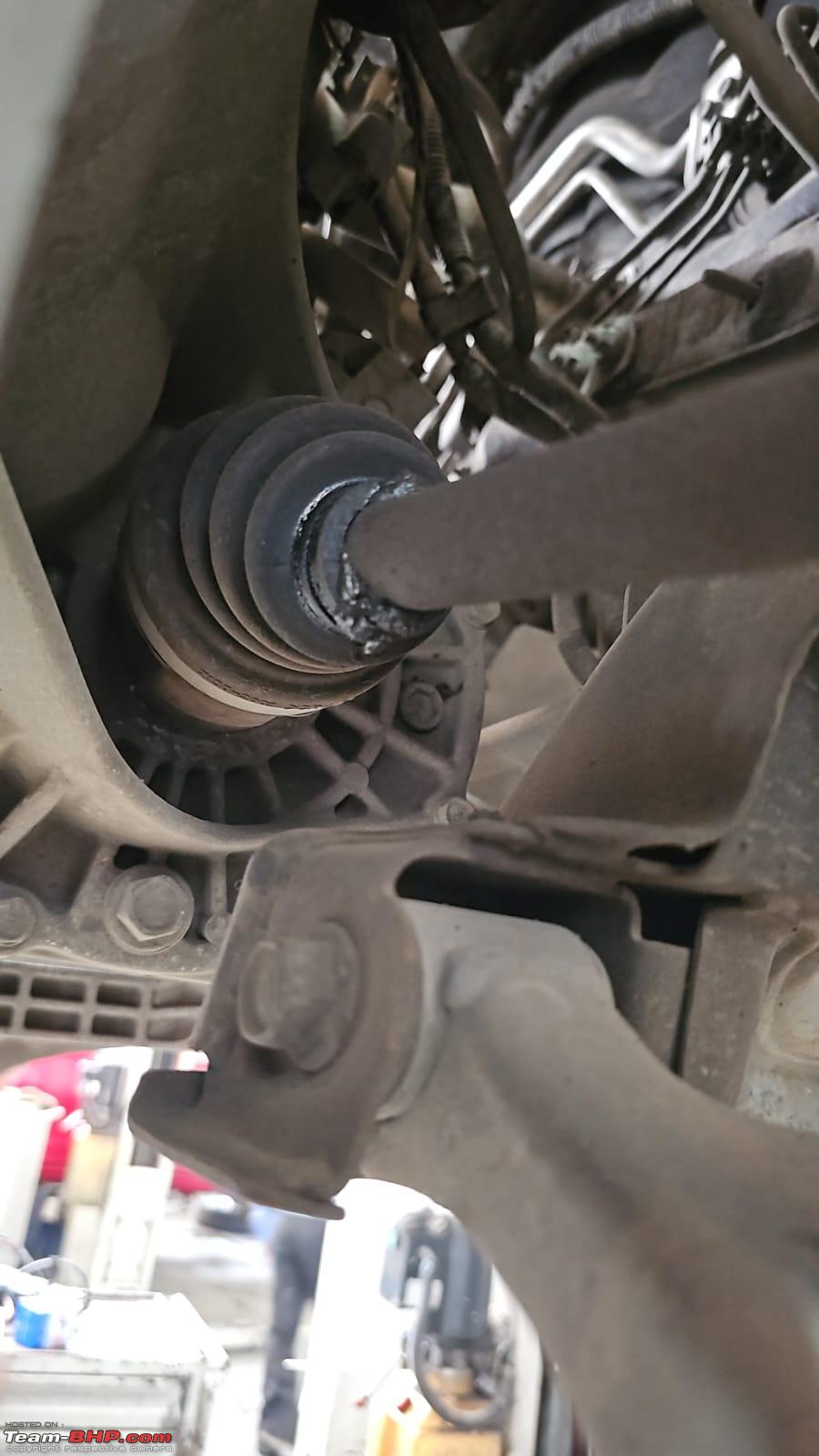

Hello friends,
I have an 2013 Hyundai i20 Magna (O) petrol run around 55,000 KM and used about 500 Km a month for short distances.
Recently in the last scheduled service at Hyundai Service Centre, the Service Advisor pointed out an issue related to grease leakage from both right and left axles as per the below pictures:
Driveshaft / Axle Maintenance-whatsapp-image-20240523-4.05.46-pm.jpeg
Driveshaft / Axle Maintenance-whatsapp-image-20240523-4.05.33-pm.jpeg
The SA advised to have both axles replaced at a cost of Rs 12,000 each for a total of Rs 24,000. He said that it might be cheaper to have an outside mechanic "repair" these for a lower cost.
Unfortunately, I don't know any reliable mechanics in my area that do this type of axle work (Thane city in Mumbai).
I am looking for opinions on whether I should have them replaced at Hyundai or repaired via an outside mechanic looking at the above pics?
Any suggestions or pointers would be extremely helpful on the next steps! Thanks!

Originally Posted by Virtualaman View Post
Hello friends,
The rubber boots are torn. Some ASCs don't change the rubber boot and insist on changing entire drive shaft, which in my opinion, is rubbish & quite irresponsible on manufacturer's part. Please find an FNG who can replace the rubber boots at a fraction of the cost quoted.
Hello friends,
Attachment 2623877
Attachment 2623876
If the car is not making any noise during turns or on bad roads due to the axle, then you can replace the boot kit. Hyundai sells them as spares. Costs around 1000 rupees for each side- Differential and the wheel side. Including labor you can get it fixed for under 3000 Rupees. I have got it done on my 2010 i20 which had a torn boot on the passenger side driveshaft
Repair kit for the differential side boot
https://boodmo.com/catalog/part-boot...de_lh-6654003/
Could not get the right part for the wheel side. But your HASS can surely find it and place order for it. Cost will be approx same as above part

Thanks so much for the prompt response!
Yes, the SA emphatically said they can't repair individual components and ONLY the whole Axle assembly costing Rs 24K!
At present, there is no abnormal noise or sounds while turning. Only while going very slowly on speed breakers, sometimes there is a 'khat' sound like something is creaking.
Was the replacement done at Hyundai Service Centre or outside FNG? I am not sure if the SA will agree to replace just the boots, even if they are available on BOODMO.
Was the replacement done at Hyundai Service Centre of outside FNG? I am not sure if the SA will agree to replace just the boots, even if they are available on BOODMO.
Part was ordered through Hyundai service and replaced at Hyundai service. Although, the service center took the repair kit and the axle to a nearby lathe workshop to get it fixed, since they were not having the right tools to compress the clamps.
Do not purchase on Boodmo and take it to them, they will not agree to fixing it. If the particular HASS is not agreeing to fit, take the car to some other service center.
The gear oil needs to be drained before the axles are removed. If the gear oil is more than 40,000 kms old then this would be a good time to replace the gear oil as well. Takes 2 Litres of 75W858 API GL4 gear oil

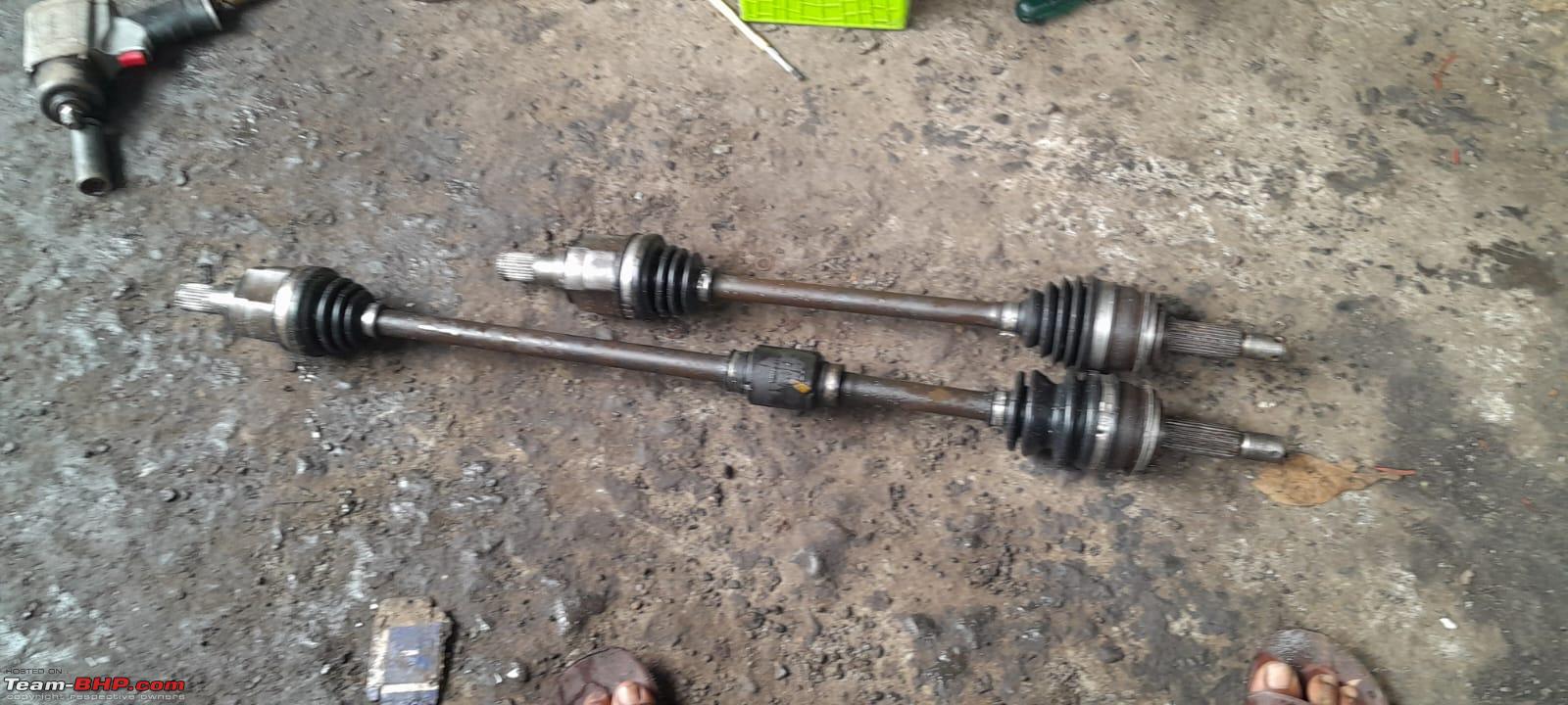

Happy to report that I've got these repaired at a small trusted garage
Both boots replaced for a total cost of Rs 2000.
Now let's see how well they last over time.
Thanks for the inputs!
