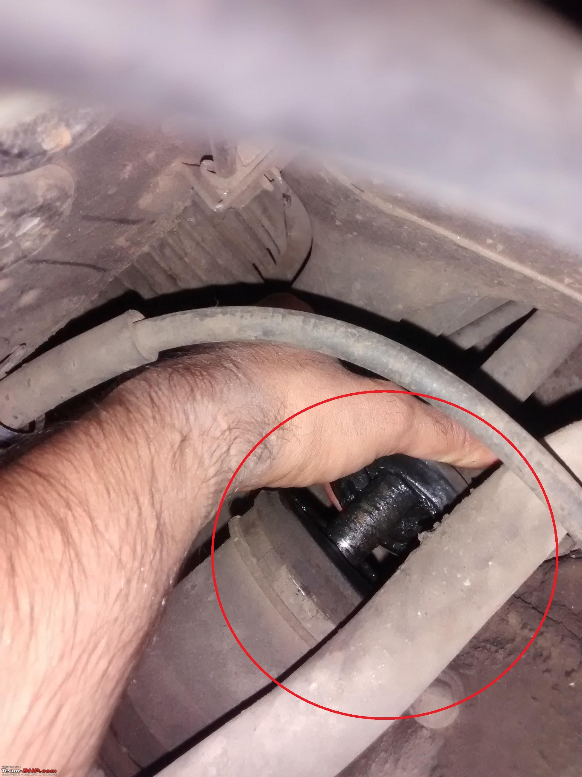

Guys, attached are pics of my Maruti 800's LH engine-side (inner CV joint) boot. It's torn and the grease is slowly coming out (it's not become dry yet). The wheel-side boot is perfectly OK. I was planning on driving about 500km this weekend. Can I continue with my plan or is this an urgent must-fix? Can I cover it with some duct tape until I get to having it fixed?
We recently concluded a 1000km trip and had no noises or problems whatsoever, but after I saw this today, I'm re-thinking about my plans.
I wouldn't have noticed it at all, but as I was topping up windshield fluid and coolant I shone my flashlight around and noticed this:
If sound is not comming and grease still wet. you are lucky. Hence would not recommend to drive even for 5 kms.
Axle boot and grease are cheap. drive shaft is not. so its your call.
You are right to tarry.... change the rubber boot asap.
BTW hope you don't get a click-click sound when turning the car on full steering lock. If you do - then I am afraid much more than the rubber boot has gone bad.
Okay.
Does anyone know if these are available in India? Split boots like these would help people like you and me install new boots without opening up anything!
Changing an axle boot is a VERY simple procedure for a MASS trust me. And NO, don't go for your trip without fixing a new boot. A 300 rupee fix will suddenly convert into a 3000 rupee replacement.
1) Lift the car on ramp,
2) Remove your wheel
3) Disconnect tie rod end, now the strut will move in any direction you want so that axle can be removed.
4) Replace axle boot
5) Refix everything back.
All this will take less than half an hour.
humyum is offline   (5) Thanks
i am afraid it will take much more than half hour. as replacing boot is not a easy DIY.
as you need a table clamp/vice and you need to remove the universal joint bearing.
Hey, if its the axle side boot, I ll just need a hammering or two to get it out, if its the one on the other end, I agree, will take sometime.
I had replaced my 800 boot back then in like an hour, but that was also because I hardly had the right tools that time.
Thanks!
Got the boot replaced at MASS for Rs.350, and took 30min exactly as you said.
