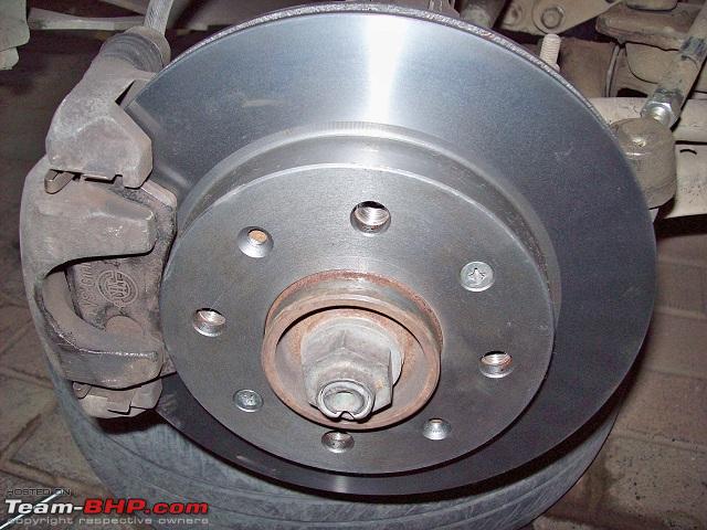

After suffering long enough with steering vibrations and jerky stops i decided to replace my indica brake rotors
got original rotors 500rs each from jc road.
Let the pics do the talking
Shuddering/Vibrations while braking! Need help!-1-1.jpg
old brake rotor
Shuddering/Vibrations while braking! Need help!-1-2.jpg
removed caliper and caliper bracket
Shuddering/Vibrations while braking! Need help!-1-3.jpg
two screws which attach the rotor to hub
Shuddering/Vibrations while braking! Need help!-1-4.jpg
old rotor out, needed a few whacks with the hammer to free it since its rusted
Shuddering/Vibrations while braking! Need help!-1-5.jpg
old rotor next to new rotor, guess which is new
Shuddering/Vibrations while braking! Need help!-1-6.jpg
back view
Shuddering/Vibrations while braking! Need help!-1-7.jpg
marks on the old rotor
Shuddering/Vibrations while braking! Need help!-1-8.jpg
new rotor, no marks
Shuddering/Vibrations while braking! Need help!-1-9.jpg
brake pads after sanding to get it flat
Shuddering/Vibrations while braking! Need help!-1-10.jpg
new rotor fixed and caliper installed.
max time per side approx 15 mins, now after doing brake bedding the car stops smooth and in a straight line and no steering wobbling when braking at any speed
