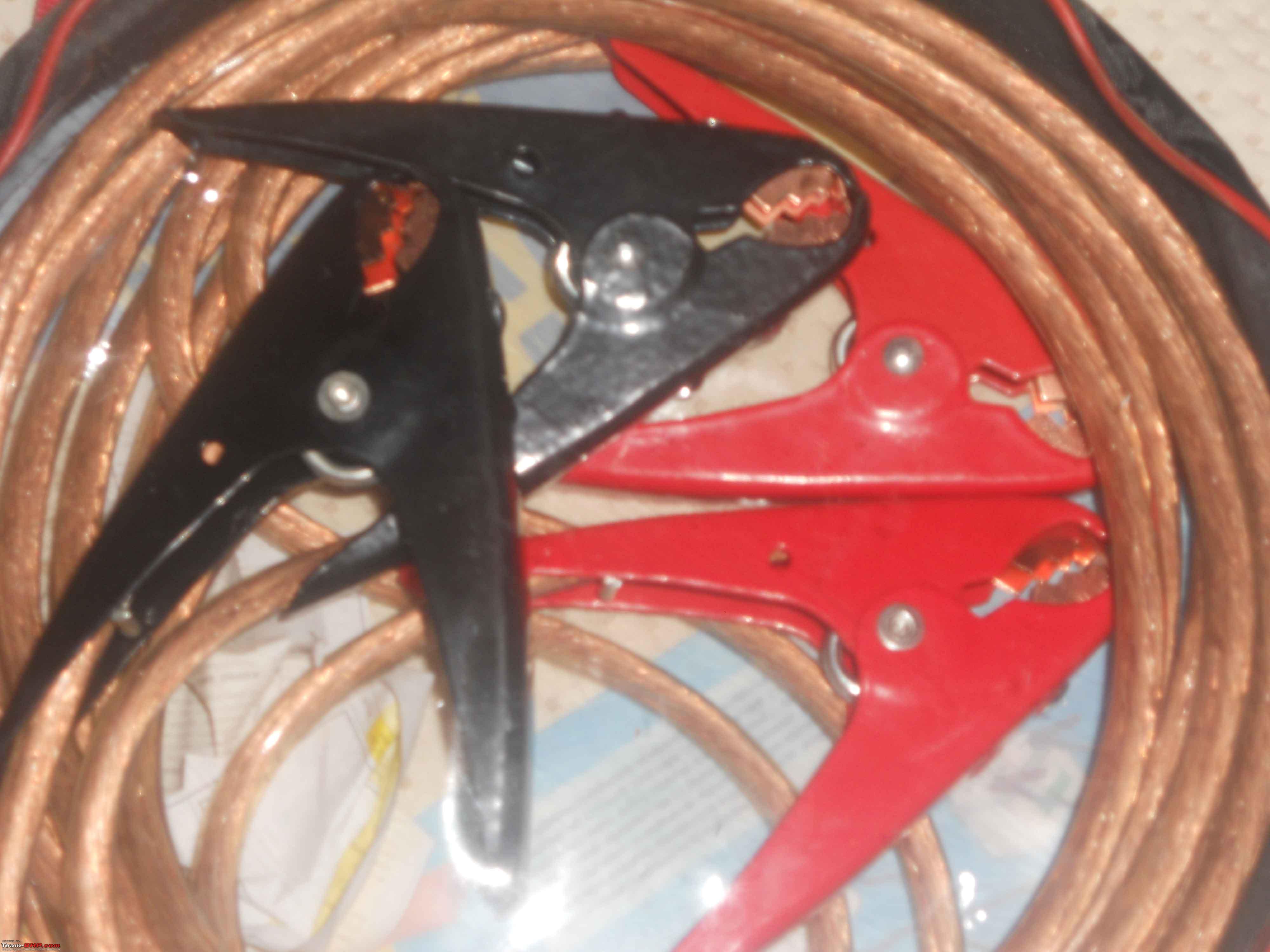

I am currently on a short business trip to Prague, and on a whim, looked up Auto Parts stores here. A name popped up : Autokelly. It's a chain of auto parts stores + garage with about 60+ branches across Czech Republic.

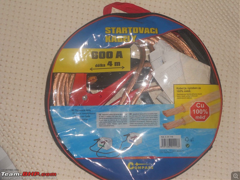

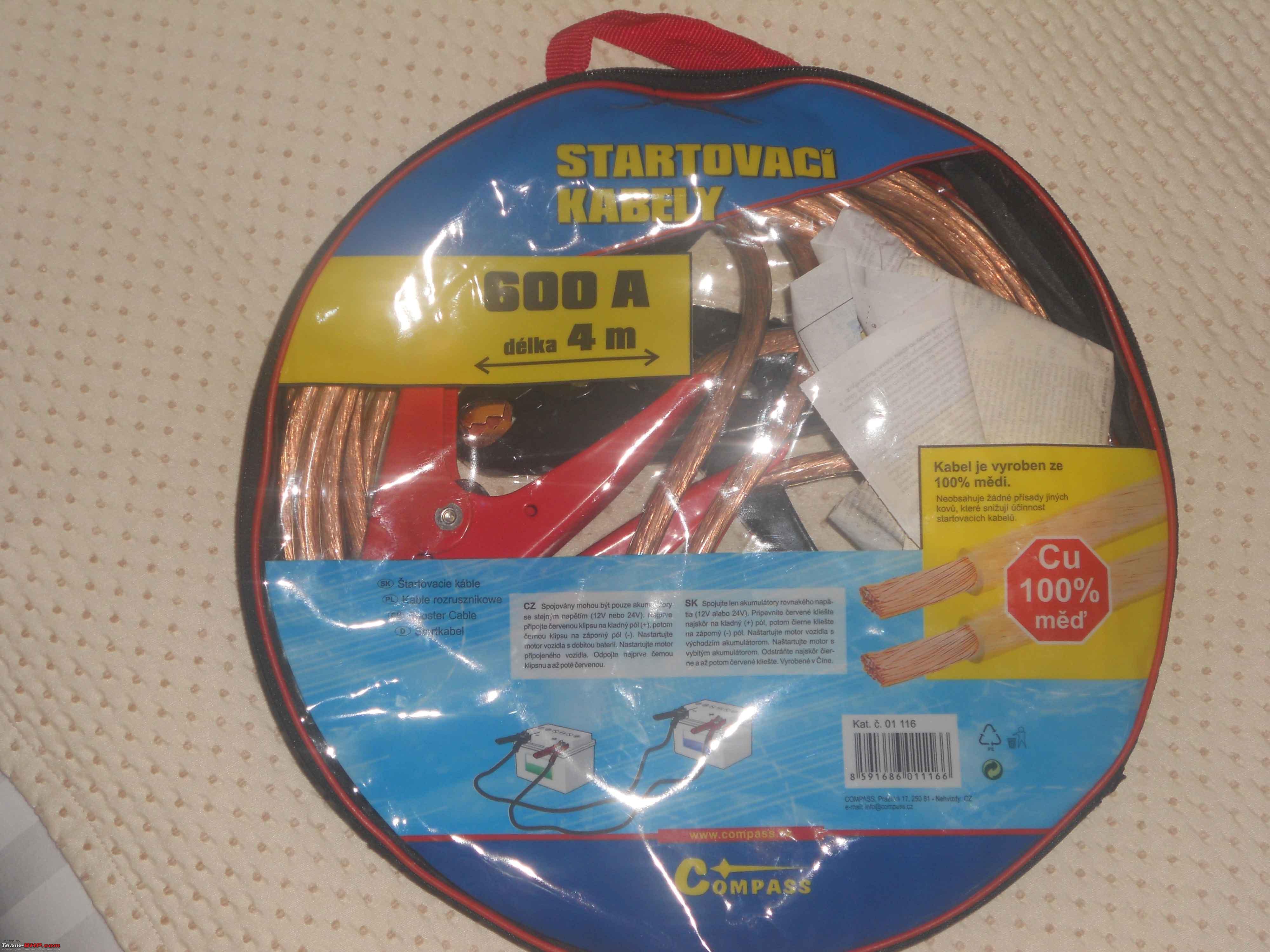

Yesterday evening, I went up to their nearest branch, and was a little disappointed to find the jumper cables on display were the usual Chinese made cable sets with brass clamps. Prices ranged from 350 CZK to 420 CZK (Rs 1250 to Rs 1500), for 350 A to 500 A.
So, I walked up to the till, and asked if they had something better (no mean feat - I can tell you because I don't understand Czech, and they don't understand English)
Anyhow, I finally wrote down 1000 A on a piece of paper, enlightenment dawned on the store clerk. He went to the back, and returned with a hefty cable - rated at 600 A. That was the highest rating he had. But it was pure Copper and not Brass. The price 924 CZK (Rs 3300) manufactured locally here- Compass
Some photos of the product...
What caught my eye at first - 100% Copper
The back of the pack

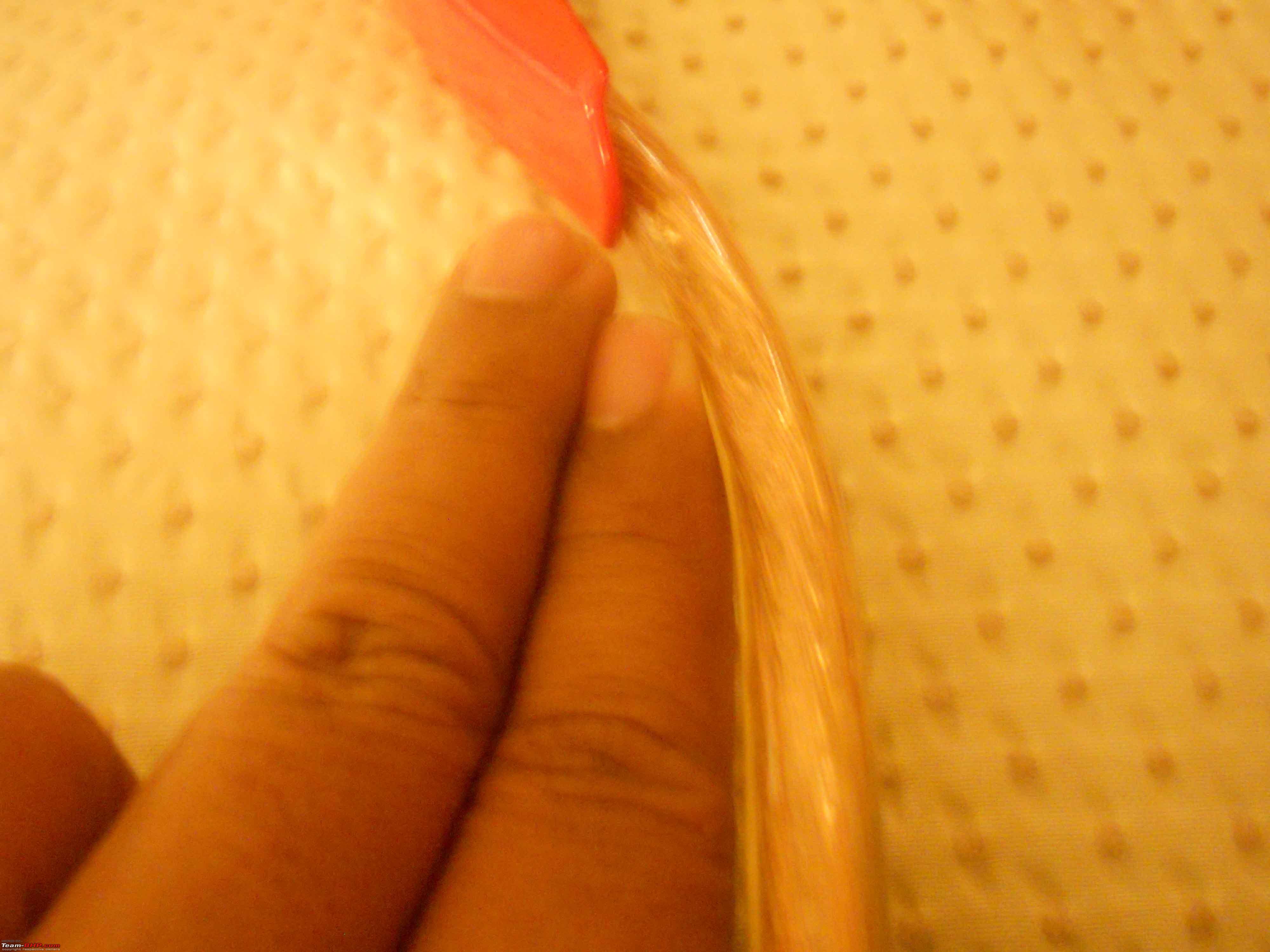

Comparison of the cable thickness with my fingers!

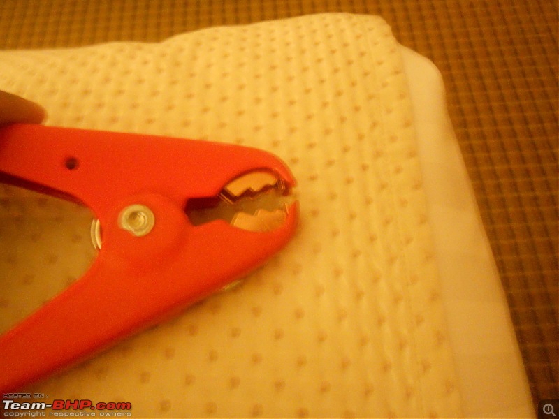

The Jaw : Notice the steel handle construction, but the actual clamp is Copper

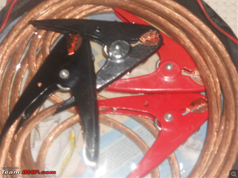

It is 4 metres. Reasonable length for usage I would think with the two cars parked with their heads on end.
I would have liked more length, but even with 4 metres, I think it may be a challenge to keep my suitcase limited to < 23 kg at the airport.
Hoping this purchase makes it back to India safely
