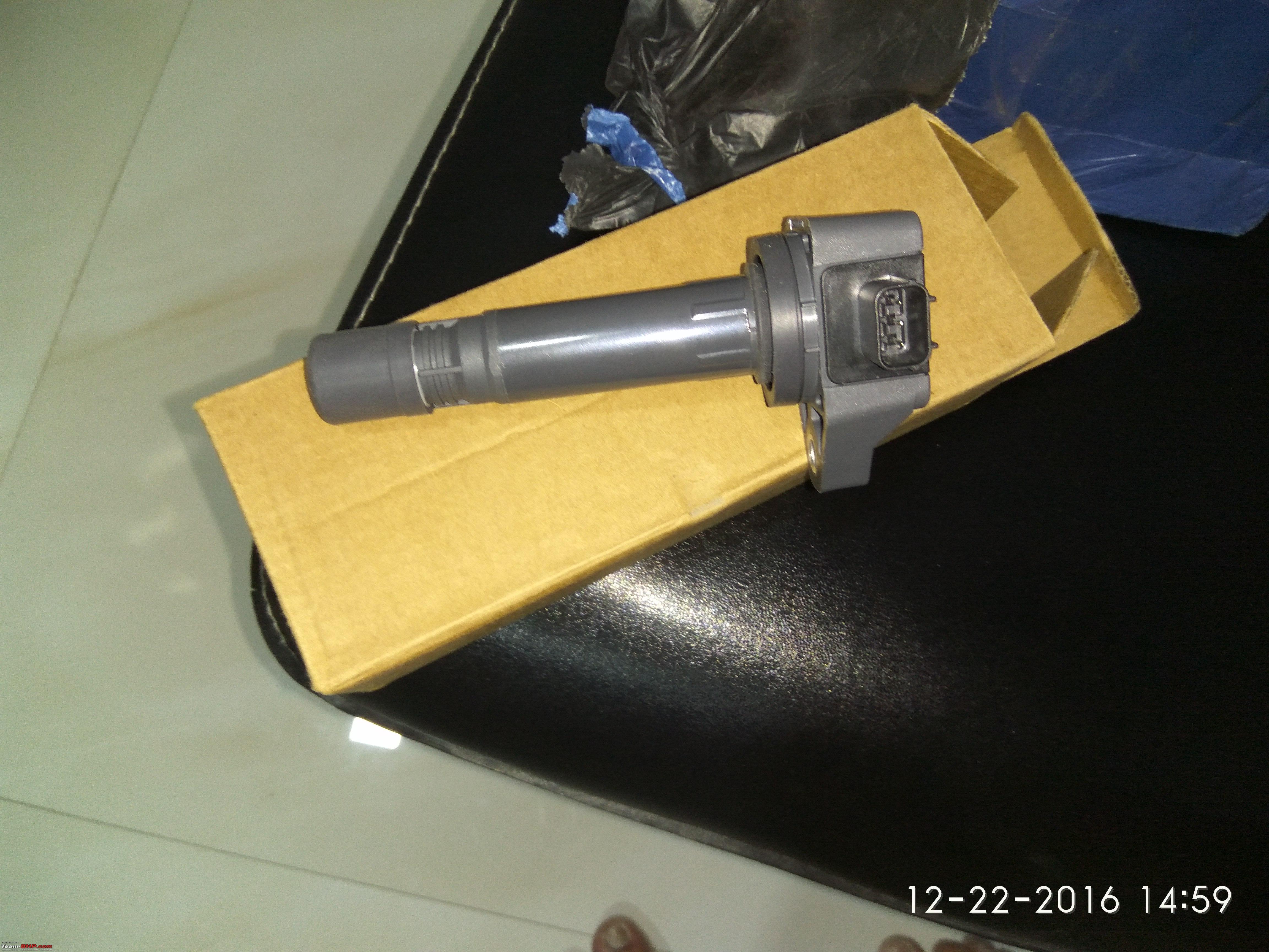

Hi Friends,
Hope the images come out proper.
Here you go. 7000 total damage.. works sweet, have already fitted them in the car.
Regards
Gary

I had experienced a little shuddering [right word?] post CNG fixing, however as per Mr.Arun, one of the reason was the different makes of ignition coil I had, and he had suggested to install DENSO original make or Hitachi which are cheaper.
On installation of all 4 Denso, I could immediately notice the different, you can feel the power. Well paisa vasool is my reaction right now
