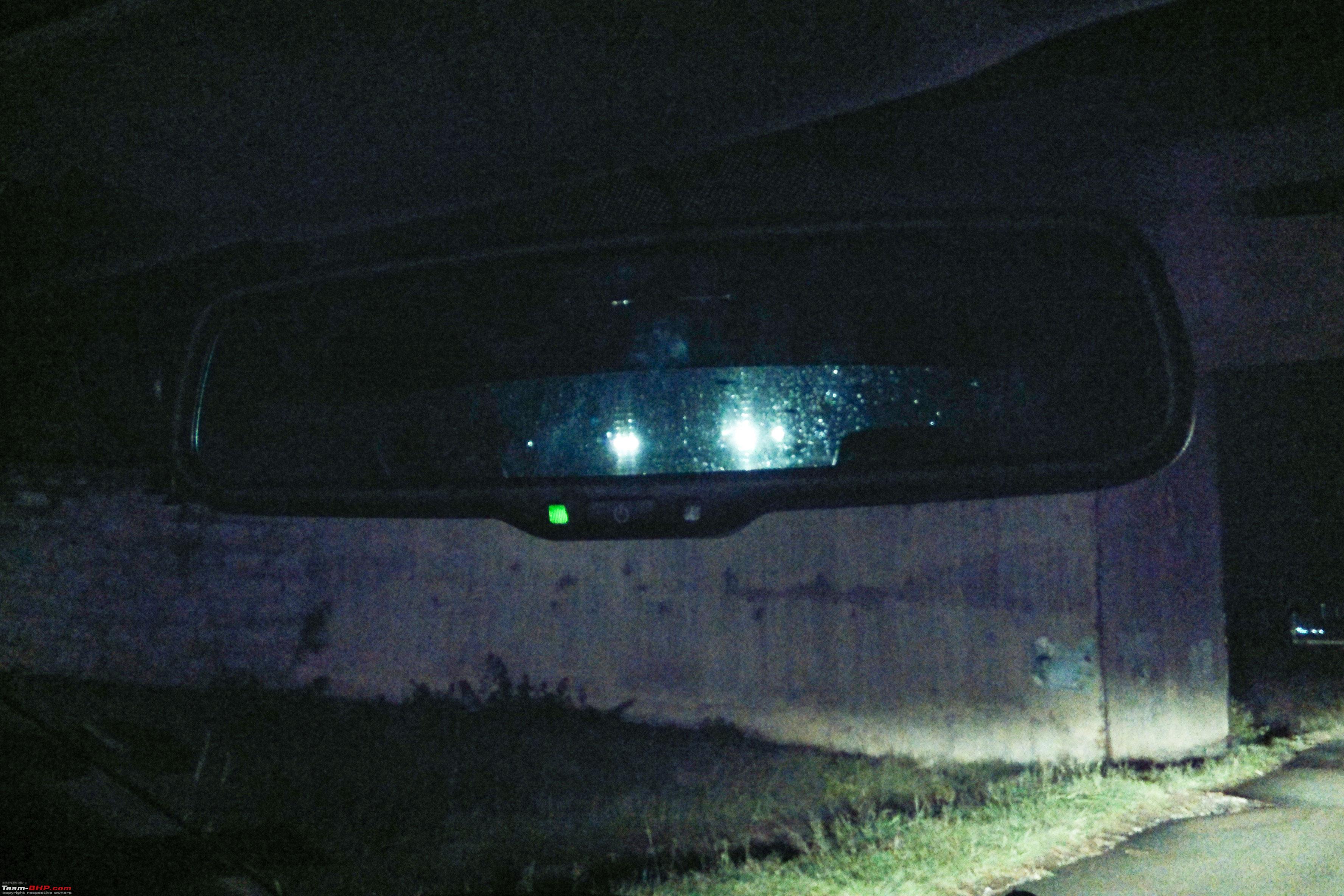

Finally managed to fix the auto dimming mirror at Sun combines, Coimbatore. The guy took ten minutes in all (including the time to go through manual, twist & pull off old one, plonk the new one). Wiring was done with a completely new line pulled from the ACC fuse for both dash cam and auto dimming mirror. So no cutting of wires and they charged only Rs.100 for this work. So in all, got this upgrade done for £70 + Rs.100.
One photo of auto dimming at work in Nice Road, Bangalore.

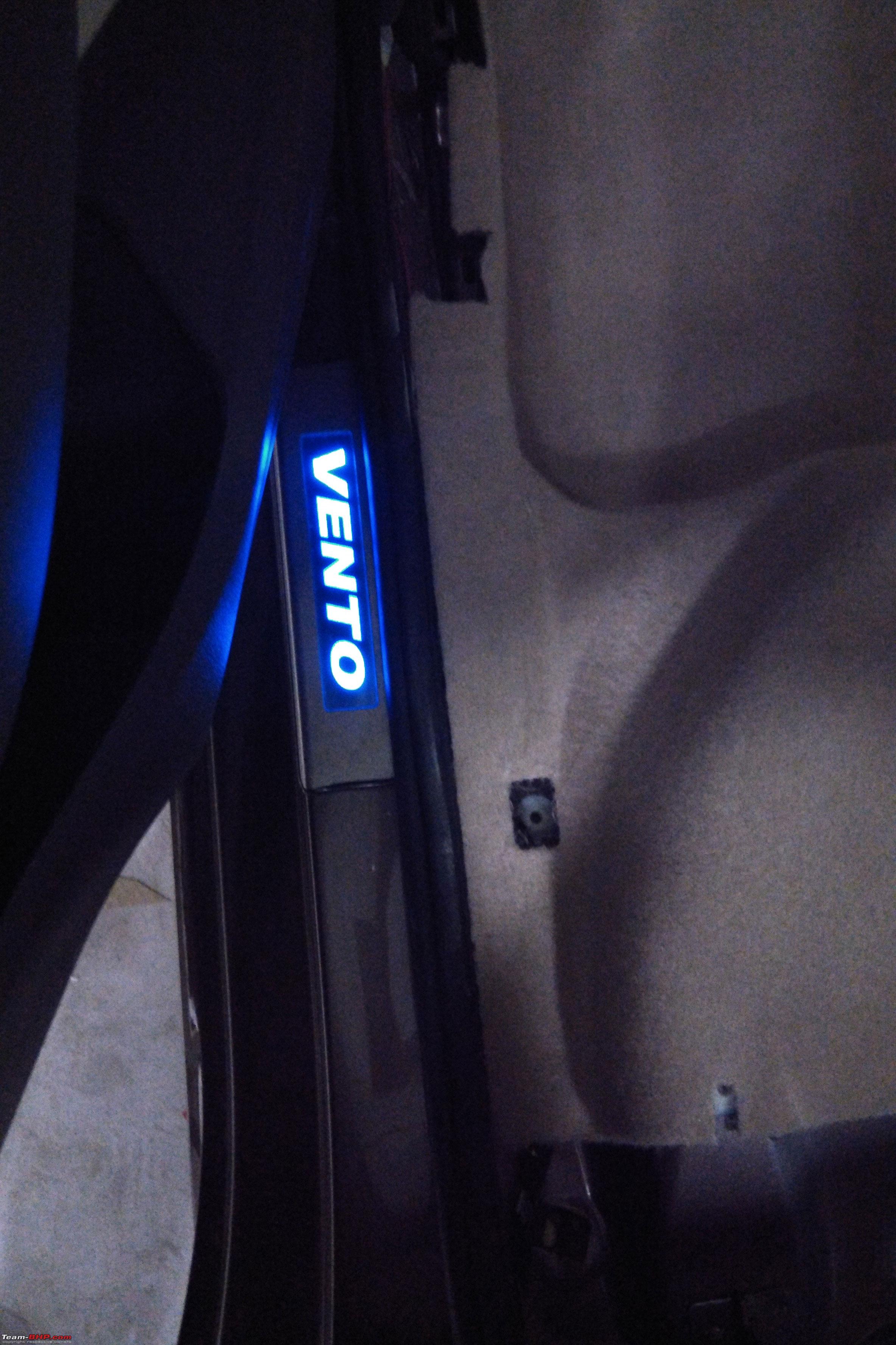

Illuminated door sill plate. This was ordered by mistake on ebay, as I wanted a plain one. However, this was finally fitted at Coimbatore as well for Rs.250/-. They illuminate and switch off along with door lights. Again no wires were cut for this fitting.

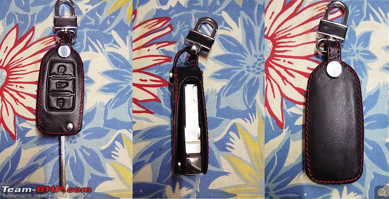

Finally this cover for the key chain. Costed about $3/- at Aliexpress.

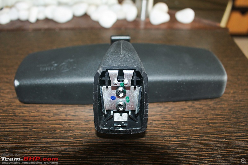

I bought the Gentex auto dimming mirror from Amazon UK for £70 during my business trip earlier this year (There are local options, but quite pricy). The OEM mirror is slotted into a groove plastered to the windshield. So, all that would be required is to twist OEM mirror clockwise to ~90 degrees and pull it off the slot. Gentex mirror fits nicely onto the OEM plastered slot. However this whole process will have to be done gently, else it could damage the windshield. Hence I got it done with a car accessory shop. Below are some images of the OEM mirror, which will help understand the setup.
Even the adaptor provided by Gentex (free along with the kit) was not required and now gathering dust.

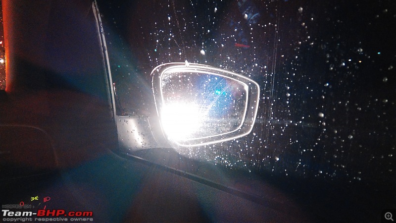

On a different note, my experience with Aliexpress has been extremely positive (barring the postal delays) and everything ordered so far has worked perfectly. Btw, anti glare blue tinted ORVM is on my list too, especially after seeing IRVM auto-dimming nicely and ORVM reflecting like this -

Drag out the sensor lead to a visible area in windshield; slot in new Auto switch to the slot and put back the side panels. All done.
Next in list -
1. Cruise control and dead pedal from the upgraded Vento. I'll be doing it along with the 6 month checkup due in August.
2. Auto dimming outer RVM. (order placed at Ali express).
