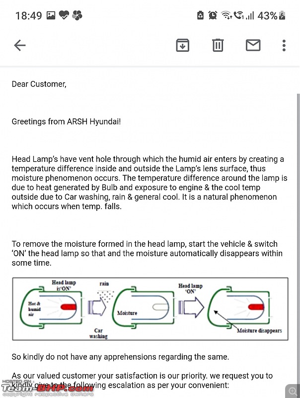

Is anyone seeing some fogging in the headlamps of the Tucson?? There's been a recent dip in temperatures in Mumbai and the service advisor says it's normal for this to happen... But I'm not too convinced. It's a very mild layer and goes off after some time. Not seen during the daytime
I think this is mentioned in the owner's manual too regarding mild condensation happening due to change in temperatures.
Can you check the dust caps present if they are seated correctly or not?
I did not observe this. On the one hand, Bangalore does not get that cold and on the other hand, I haven't paid attention to this point (I normally just jump in the car and start driving).
Based on what I have read, this is very normal and will go away by itself.

Thanks. The service folks also mentioned something about dust caps. Will get this checked.

OK, so here's an update from the Hyundai service center after I had written to Hyundai India directly on the fogging /condensation issue. Response is attached as an image.
My Black 2020 Hyundai Tucson GLS Diesel AT | An Ownership Review | EDIT: 30,000 km update-screenshot_20210201184946_gmail.jpg
