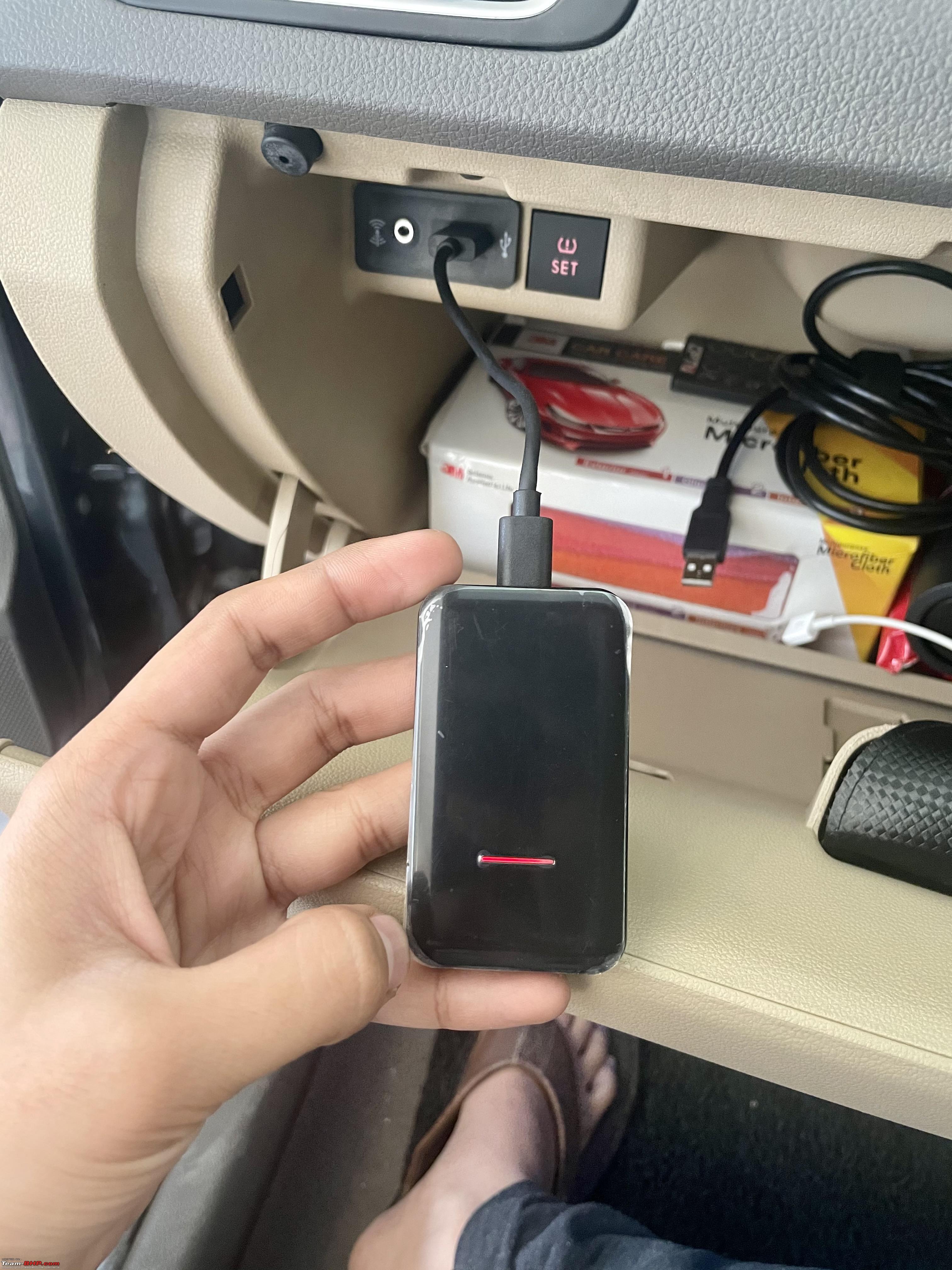

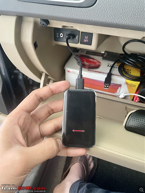

Since I've been getting DM's, and people have been asking on the thread, I want to make a detailed post about the Wireless CarPlay dongle.
There are two variants of devices, One is for Android HU's, and the other is for factory radios. In either case, it does not add CarPlay functionality to a non-supportive device, just enables wireless CarPlay on devices supporting wired CarPlay. There are two versions in each, v1 and v2, v2 is the latest. I've known a few people who used v1 devices and were pretty happy as well. Now, the beauty of this device is that it does not necessarily have to be a radio of the VAG group. It will support most company radios including Maruti, Honda, etc. This device uses BT to connect to the dongle and connects to the WiFi hotspot created by the device.
Ownership Review : Journey with my VW Vento 1.2 TSI Highline-image0.jpeg
The packaging is pretty simple, it's a no-fuss packaging with just the device, a tiny USB C cable, and a user manual.
Ownership Review : Journey with my VW Vento 1.2 TSI Highline-img_5727.jpg

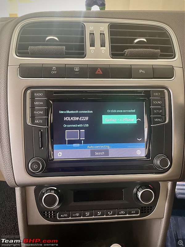

Setting up the device is a breeze, here are the steps :
1) Plug in the device and let it initialize.
2) Go to the Bluetooth menu on the iPhone and pair the device.
Note: If you don't follow the steps, unplug the dongle, turn off BT and repeat the steps.
Ownership Review : Journey with my VW Vento 1.2 TSI Highline-img_5729.jpg
The initial setup takes longer, about 2-3 minutes, but from the next time, it's very fast. There are absolutely zero performance or connection stability issues.
If your BT and WiFi were off initially when you got into the car, you can still turn them on and select your phone here on this menu.
Ownership Review : Journey with my VW Vento 1.2 TSI Highline-img_5728.jpg
Here is a product link from AliExpress: https://www.aliexpress.com/item/4001...archweb201603_
Unfortunately, we cannot order from AliExpress. So, I've found a Chinese source. He charges a bit higher, taking advantage of the situation. His price is 103$ after negotiating. Since we would be making the transaction over PayPal for security reasons, they charge 5% extra to the seller, which they push it on to us, making the price effectively around 108$. Since the transaction is in $, we will have to pay a little extra over the exchange value. There are again 2 options here, the first is PayPal conversion, and the second is by the bank. Most banks charge 3.5% of the transaction value plus a GST of 18% on the 3.5%, Bank conversion works out to be cheaper than PayPal. I was charged a duty of 200INR on the device, so the landing cost was about 8527.
If anyone wants to purchase, let's connect over DM.

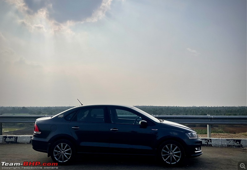

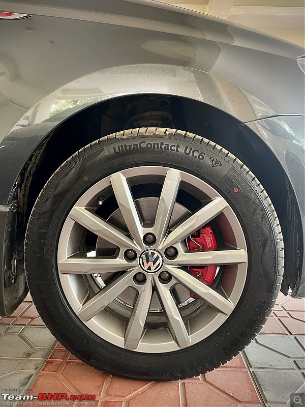

So, after a long consideration whether or not I should upsize my wheels, I’ve finally taken the plunge and upgraded to 16” Portago’s. For tyres, PS4 ST were available but were over an year old stock, so went ahead with Continental UC6 195/55 R16. Comfort wise, definitely it’s a slight step down, but the ugly rear wheel arch gap on 15” wheels is covered now and looks much better.
Ownership Review : Journey with my VW Vento 1.2 TSI Highline-6d734bbaec444ddfb3a98a787977b4cc.jpeg
Ownership Review : Journey with my VW Vento 1.2 TSI Highline-8a515344791c45e8ba755def88035f16.jpeg

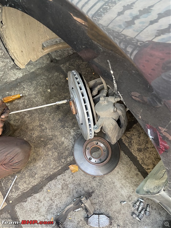

There is always room for more. It’s a well known fact that after VW started giving TVS brake hardware, the braking has been pathetic, just like the quality of the hardware. So I’ve upgraded and installed Big Brake Kit. The discs are now 288mm, so it demands a change of callipers and brake pads as well.
Ownership Review : Journey with my VW Vento 1.2 TSI Highline-15c2feebfb6f43bc96352cf1e2a23f7f.jpeg
A picture of all the hardware.
Ownership Review : Journey with my VW Vento 1.2 TSI Highline-15d7c4c3cb854fe4b9c337b61bc51619.jpeg
Zinc coated 288mm ATE rotors.
Ownership Review : Journey with my VW Vento 1.2 TSI Highline-8afa7ef8ce8e4b69819d9e1163addde7.jpeg
Need to bend the dust shield slightly to prevent it from obstructing the significantly larger rotor.
Ownership Review : Journey with my VW Vento 1.2 TSI Highline-cde978c05468468d95533e98fb2fa5b3.jpeg
Red callipers definitely look very good IMO.
The entire job was done in about 45 minutes. It is that simple. Everything was bolt on, and except bending the dust shield a bit, no alteration was required.

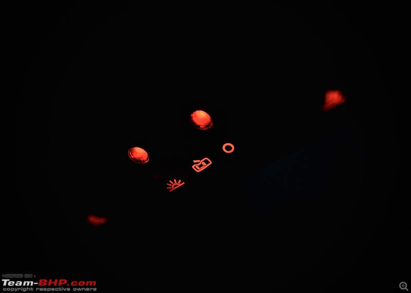

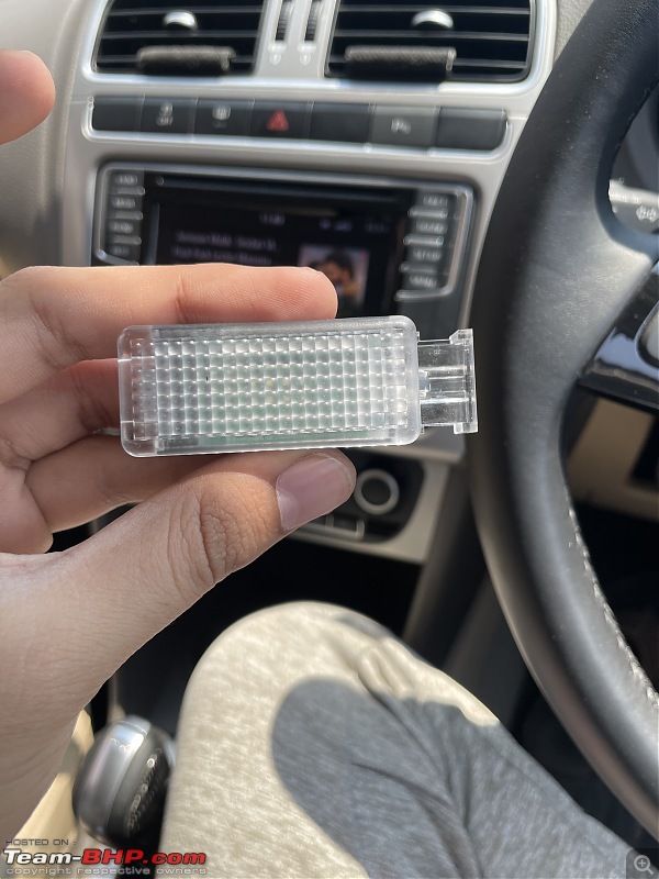

I have also changed the front footwell lights to VW OEM and I’ve also added footwell lights for the rear passengers.
Ownership Review : Journey with my VW Vento 1.2 TSI Highline-c6a77e47fef04941a77484ebc1929c7c.jpeg
Ownership Review : Journey with my VW Vento 1.2 TSI Highline-aa7b5e51d0b444588ea11fc28edeb2ed.jpeg
These lights are just 0.1 watts.
Ownership Review : Journey with my VW Vento 1.2 TSI Highline-5a301956759c42569146e7caa01c0c2f.jpeg
Ownership Review : Journey with my VW Vento 1.2 TSI Highline-51d13cd06f6140c78fdb3ff5575c22cc.jpeg

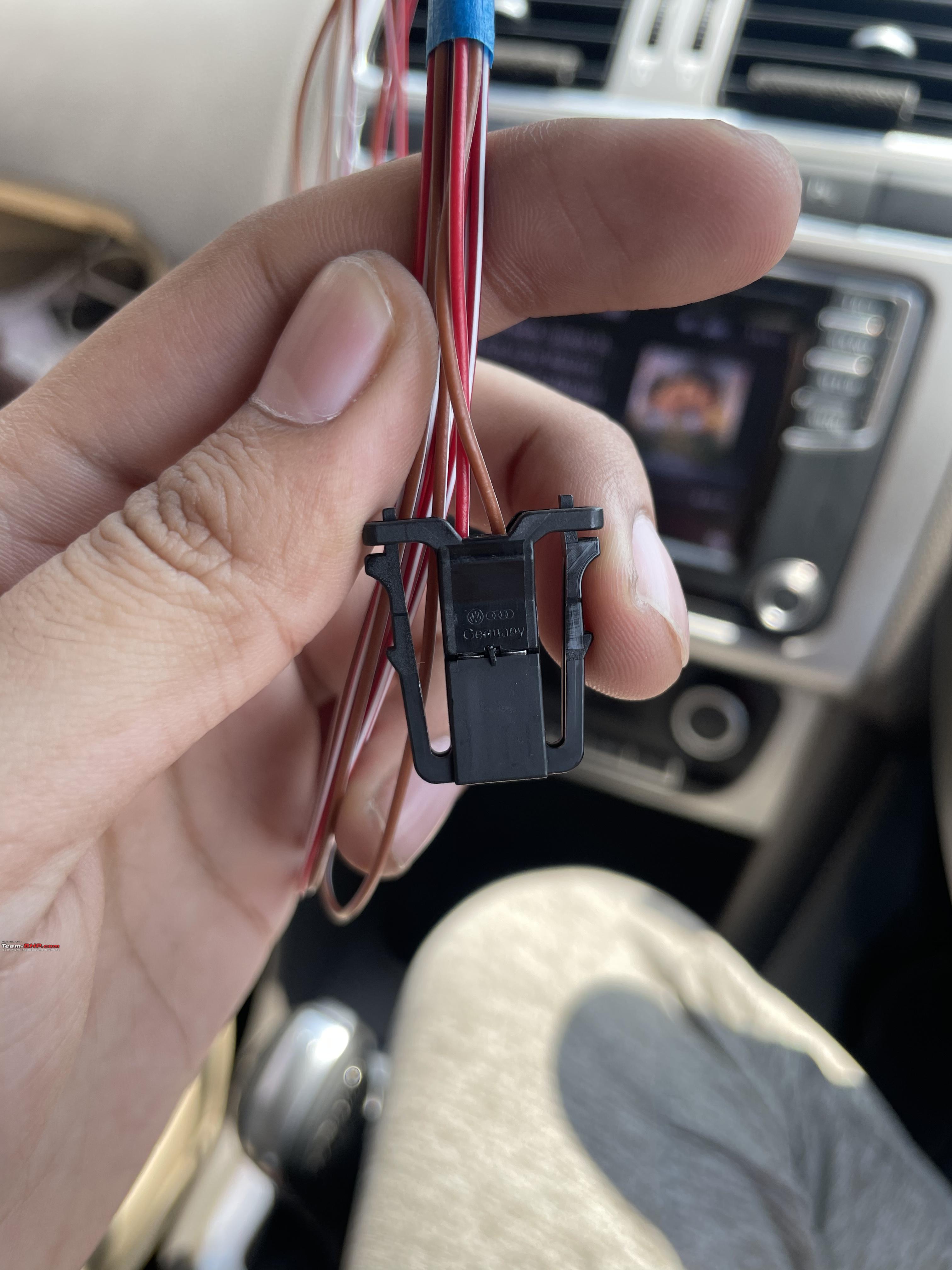

Plug and play wiring to piggy back on the front footwells to power the rear footwells.
Ownership Review : Journey with my VW Vento 1.2 TSI Highline-238d9549079c40bda730ad3056b18a36.jpeg
Ownership Review : Journey with my VW Vento 1.2 TSI Highline-f3cc5730cdff4c72af44c14f33b1dd22.jpeg

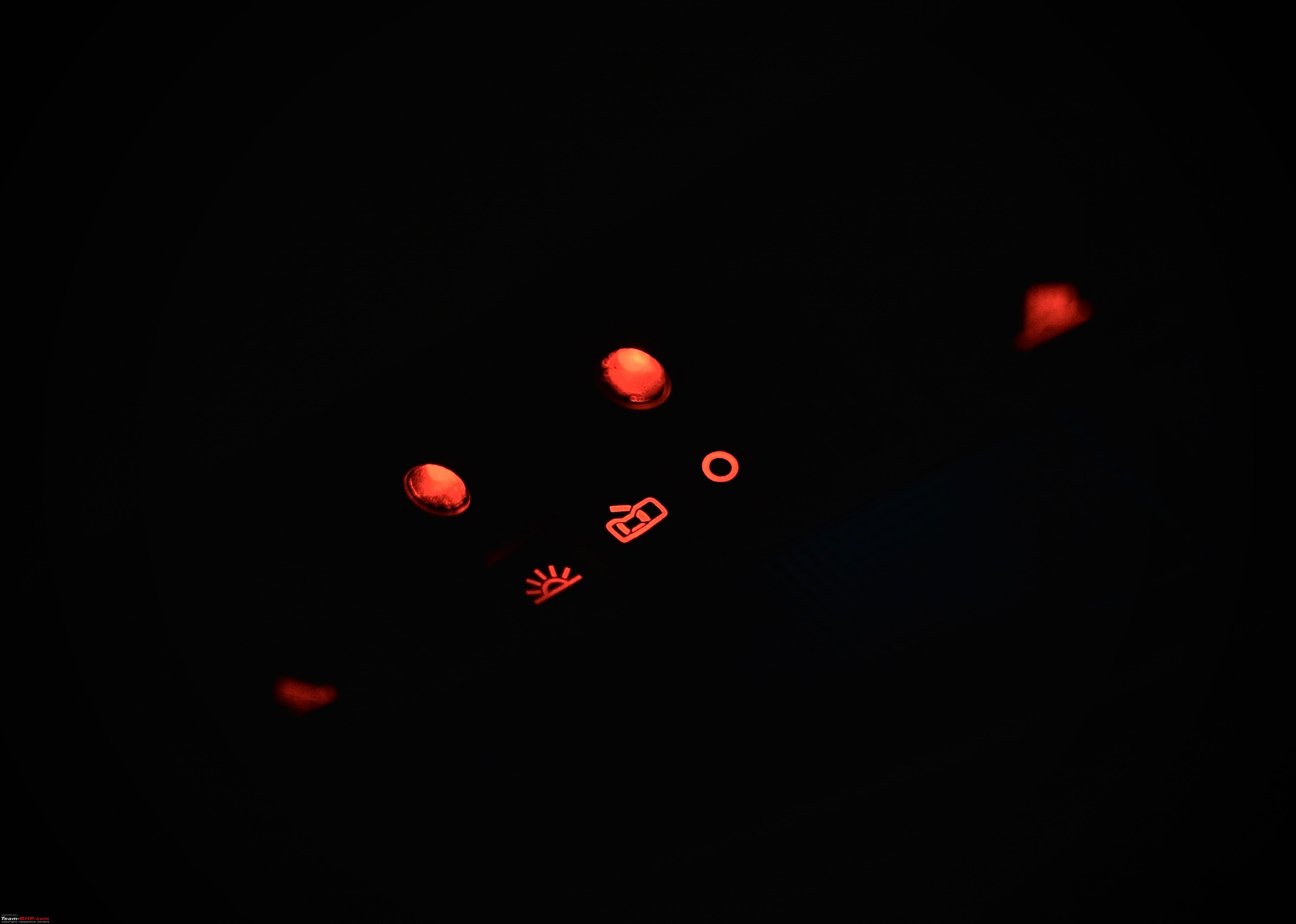

As these lights are just 0.1 watts, they aren’t too bright. But they definitely look premium and serve the purpose.

2) Passat Style Cabin Light upgrade
I had the 3 bulbs/buttons cabin light earlier, but it felt pretty normal. I thought, since I have done quite a few upgrades, so why not do this once again and get the best in business? Red backlit buttons on the cabin light and those two faint red LED’s feel very premium from the passenger’s seat and rear seat.
Ownership Review : Journey with my VW Vento 1.2 TSI Highline-da52ce0c11a540a79bea1c12e182bd50.jpeg
Ownership Review : Journey with my VW Vento 1.2 TSI Highline-db538355603a475493ecf1f829807d70.jpeg
From the driver’s seat, the red ambient LED’s are barely noticeable since we almost never look at the centre console or the gearbox while driving in the night. I prepared a plug and play harness to install this, and have made 0 splices and taps. It is an entirely reversible retrofit which would leave absolutely zero traces.
Ownership Review : Journey with my VW Vento 1.2 TSI Highline-87c617d257e7470a92a49240529f5c98.jpeg
