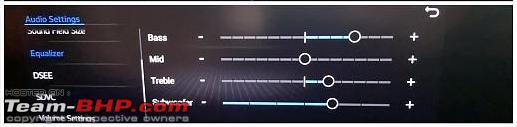

1. I find the subwoofer setting in equalizer absolutely useless, have tried a wide range of music and it really doesn't make any difference to the listening experience whether subwoofer is at - or + extreme. I have reported this to Mahindra but no response yet.
Check with someone sitting in the 3rd row - I could please my daughter when I reduced specifically the Subwoofer volume but yes it didn't make any difference to me on the front seat.
Thanks for this. I thought the subwoofer didnt work only in my car. I tried the little experiment in 3rd row, and you are right, the change is at miniscule level.
My AX7L was delivered this week. I am also observing the same. Changing the subwoofer setting does not seem to make any impact. Were you able to figure something out?

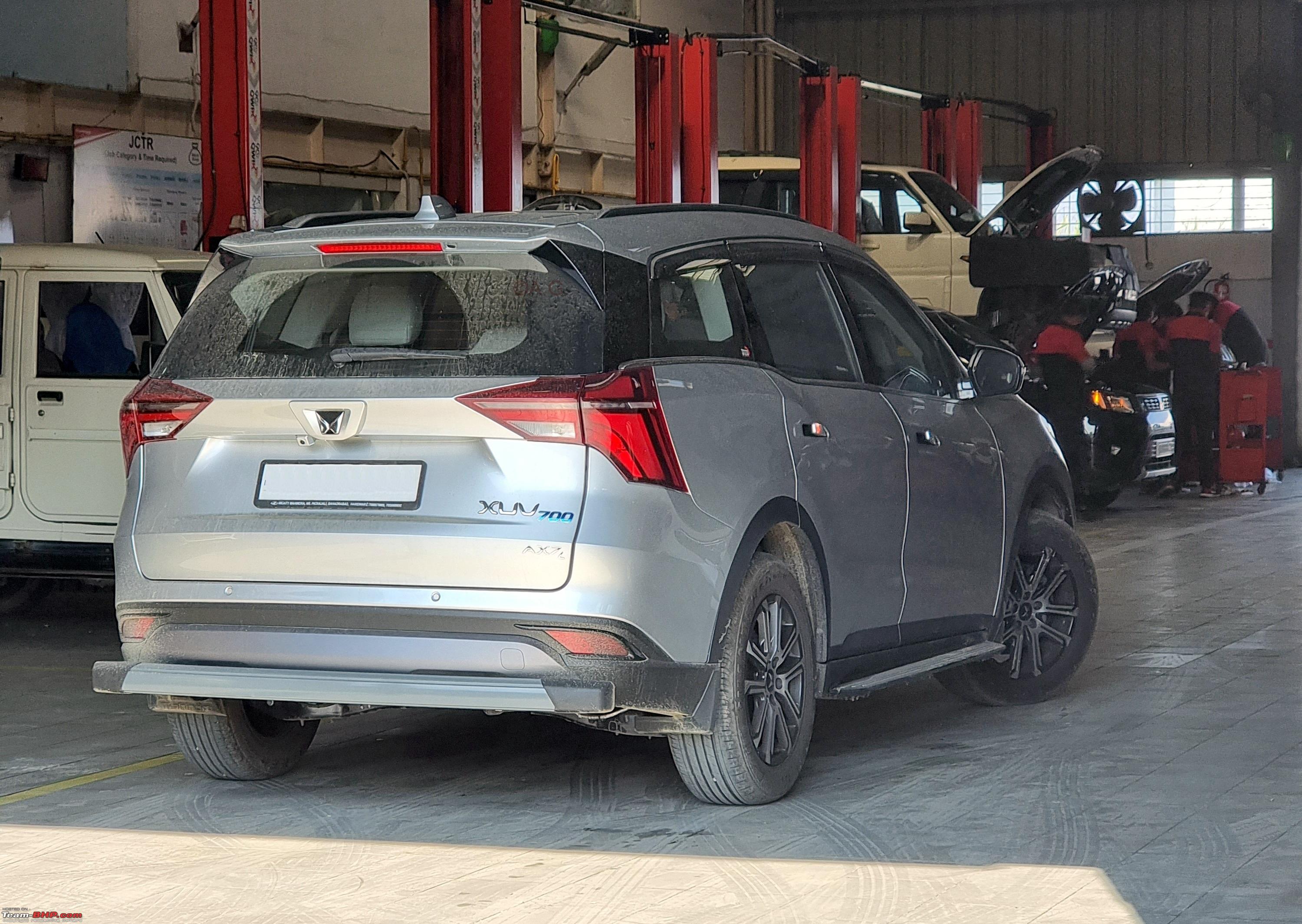

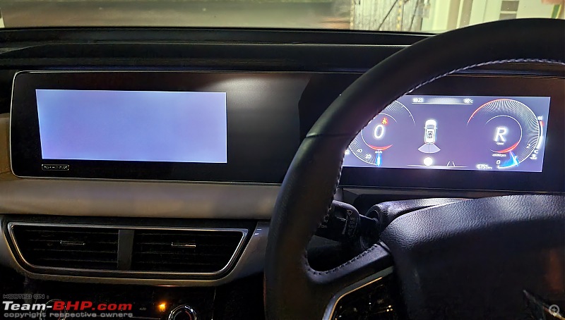

Frustrating AdrenoX experience
It is shocking to see Mahindra releasing half-baked software without any proper testing even in this day and age. While earlier the Wireless Android Auto connection had a 50:50 chance rendering Google Maps useless when needed the most, on 10th December encountered a new issue where-in the built-in Navigation Maps also stopped working. An ignition restart after 5 mins didn’t solve the issue but magically this issue was not there when restarted after a couple of hours. But this time there was a new issue of crackling sound from the speakers whenever there was any notification or any music was played.
Video of in-built Navigation Failure
Video of crackling sound
The vehicle was inspected the following day and while this was the primary issue, the suspension noise took priority as it was heard and confirmed in the test drive while demonstrating the Navigation / Android Auto issue. Parts availability meant the replacement would be done immediately and it didn’t take long for replacing both the lower control arms. The only thing that was odd was no alignment check was done post replacing the suspension components and there is no pull, I am not happy with the slightly heavier steering feel now.
Comparison of sound before and after lower control arms replacement on the same patch
For the Navigation / Android Auto issue, the general scan via the dedicated software was done before handing over the vehicle. Apart from this, thinking that the next visit would directly be for the 10K Kms service had got the DEF also topped-up and it took around 7.5 Litres (accounting for some spillage) to take the level from 60% to 98%.
Have covered more than 1200 Kms over the span of 6 days out of which there was a single trip of 1000 Kms in 2 days and these have been the most frustrating drives as whatever I did including praying to the almighty, restarting, delayed start till Engine light going off or even starting after overnight halt, there was no guarantee that the center screen would even turn-on, let alone limiting the issue to just Navigation or Android Auto. Since last evening the center screen has not booted-up and goes completely blank after displaying the responsibility disclaimer. Even basic features like Camera while reversing doesn’t work, HVAC works but you don’t know the fan speed or temperature set, you cannot listen to music and handsfree calling doesn’t work. In the afternoon both the screens went completely blank but the cluster screen came back to life after a minute.
The subwoofer is located approximately over the left rear tire in 3rd row. Unfortunately, the factory settings for subwoofer doesn't really change the experience for the front row, and a very miniscule difference for 3rd row. I am not sure if anything can be done for now, unless Mahindra tweaks the subwoofer along with the software setting. The guy responsible for software update at the service center was clueless about this.

Frustrating AdrenoX experience (continued)
Finally I was able to time and capture the AdrenoX ‘Silver Box’ reboot sequence which happens every 5 minutes post the last reboot.
Till the ‘Disclaimer’ screen is visible, pressing the camera button activates the camera. After that, nothing works and a count-down for 5 minutes starts internally repeating the reboot cycle over and over again. Hill Hold Control Error also appears out of the blue.
Without the Center Screen, there is no way to play Music, no Radio, no phone connection even for basic calling let alone Android Auto / Carplay, no Camera, no navigation, no way to change the Drive Modes and no way of knowing the Fan speed or the temperature set.
Upon reaching out to Mahindra, it became clear that this is not a software fix which resulted in ordering of the ‘Silver Box’ for it’s replacement. Surprisingly the remote features of the currently installed unit had been disabled upon ordering of the part itself with today / tomorrow being the clarity for part arrival.

The ‘Silver Box’ replacement
Despite the dealer procuring the part from a near-by dealer which should have been an overnight delivery, somehow it took them 2 days to arrange the same.
The actual process of removing the glovebox, removing the old unit and reversing the sequence with the new unit hardly took any time – probably 45-60 minutes for the entire mechanical swap. What took most of the time though was availability of the right person both at the dealership for sharing the relevant details back to Mahindra and then at Mahindra to finally approve the release of vehicle – the whole process dragged the timeline from an hour to 4 hours. Thankfully it was less than the requested entire day for replacement.
