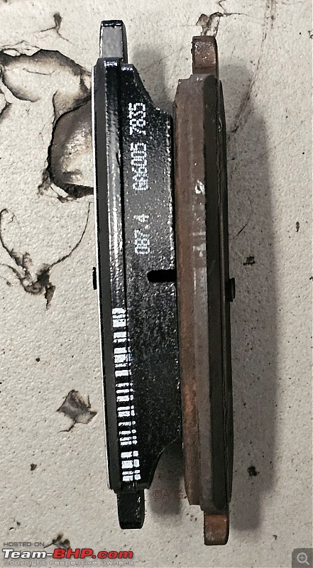

The rear brake pads were at end of life with one of the wear indicators almost going to touch. Along with the replacement, the Brake discs were also skimmed to even out the minor undulations.
New vs Old Rear Brake pad
The Silver Surfer | Mahindra XUV700 (AX7L D AT) | Ownership Review-mahindra-xuv700-service-6.jpg

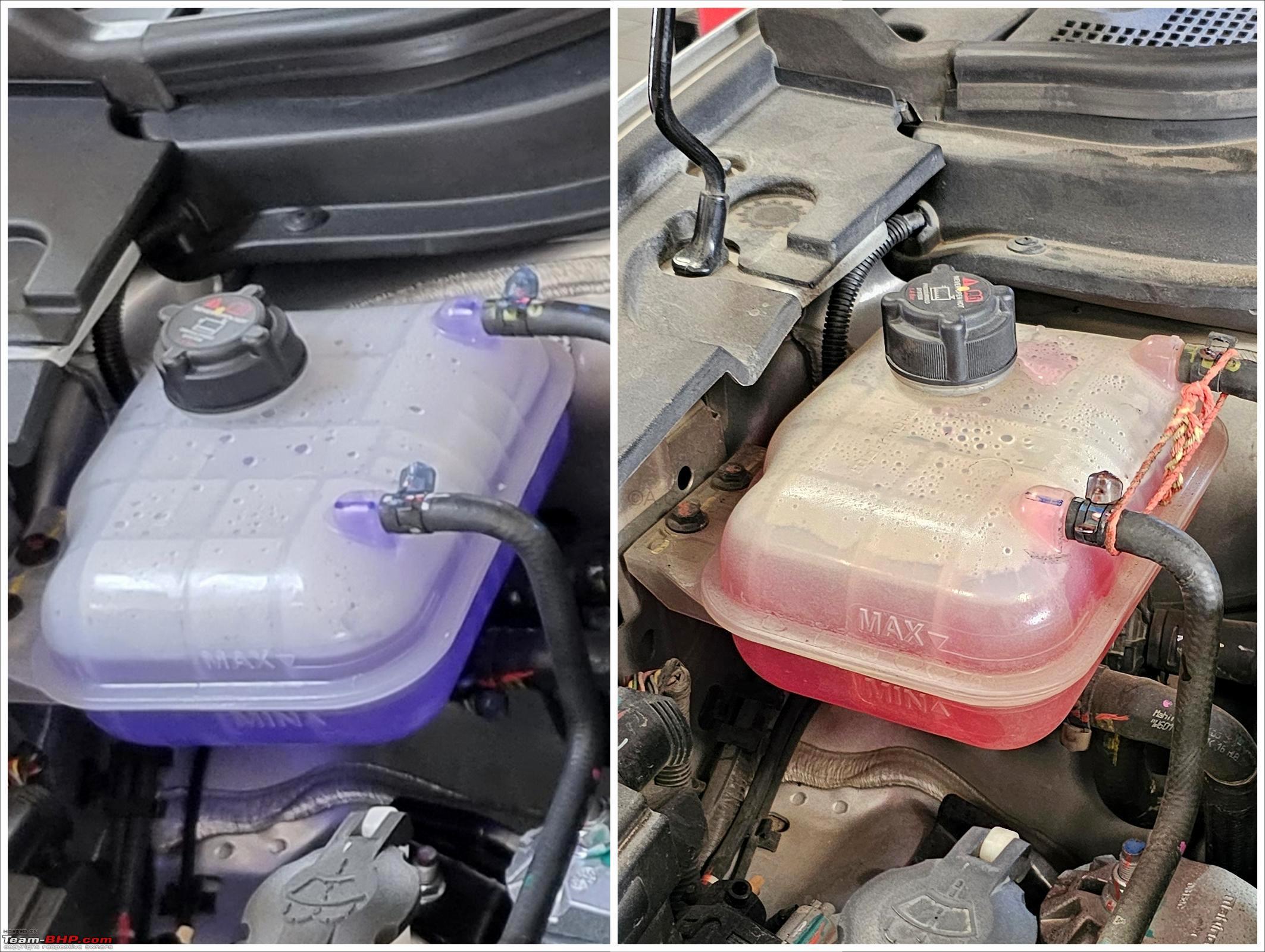

During a recent TLC session, noticed that the Coolant in the expansion tank was way above the Max mark.
Current Coolant level
The Silver Surfer | Mahindra XUV700 (AX7L D AT) | Ownership Review-mahindra-xuv700-coolant-1.jpg
Missed mentioning in the 70K service that 1L Coolant was also billed. While I was not convinced with Mahindra’s procedure to exchange 1L coolant (by draining 1L old coolant and adding 1L new coolant during the 70K service), it seems weird that the level is above Max mark now.
Also, the Coolant 2 years back was Violet in colour and is gradually changing colour over the past 70K Kms.
Before (Sept. 2022) – After (Dec. 2024)
The Silver Surfer | Mahindra XUV700 (AX7L D AT) | Ownership Review-mahindra-xuv700-coolant-compare.jpg

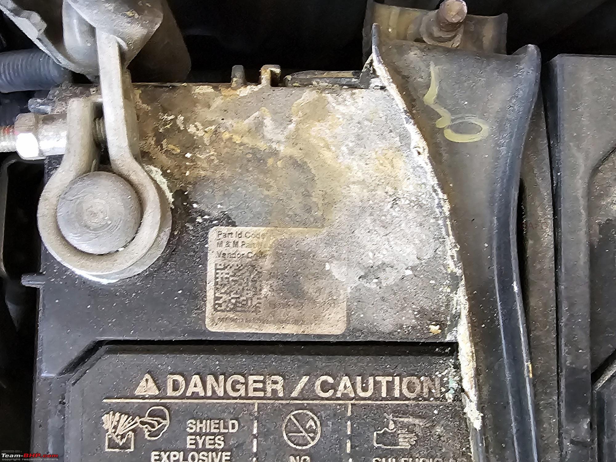

Noticed during cleaning that the positive terminal side of the battery was having sulfation. Removed the intake and saw that the area not usually visible has prominent sulfation marks.
Suflation marks
The Silver Surfer | Mahindra XUV700 (AX7L D AT) | Ownership Review-mahindra-xuv700-sulphation-battery.jpg
