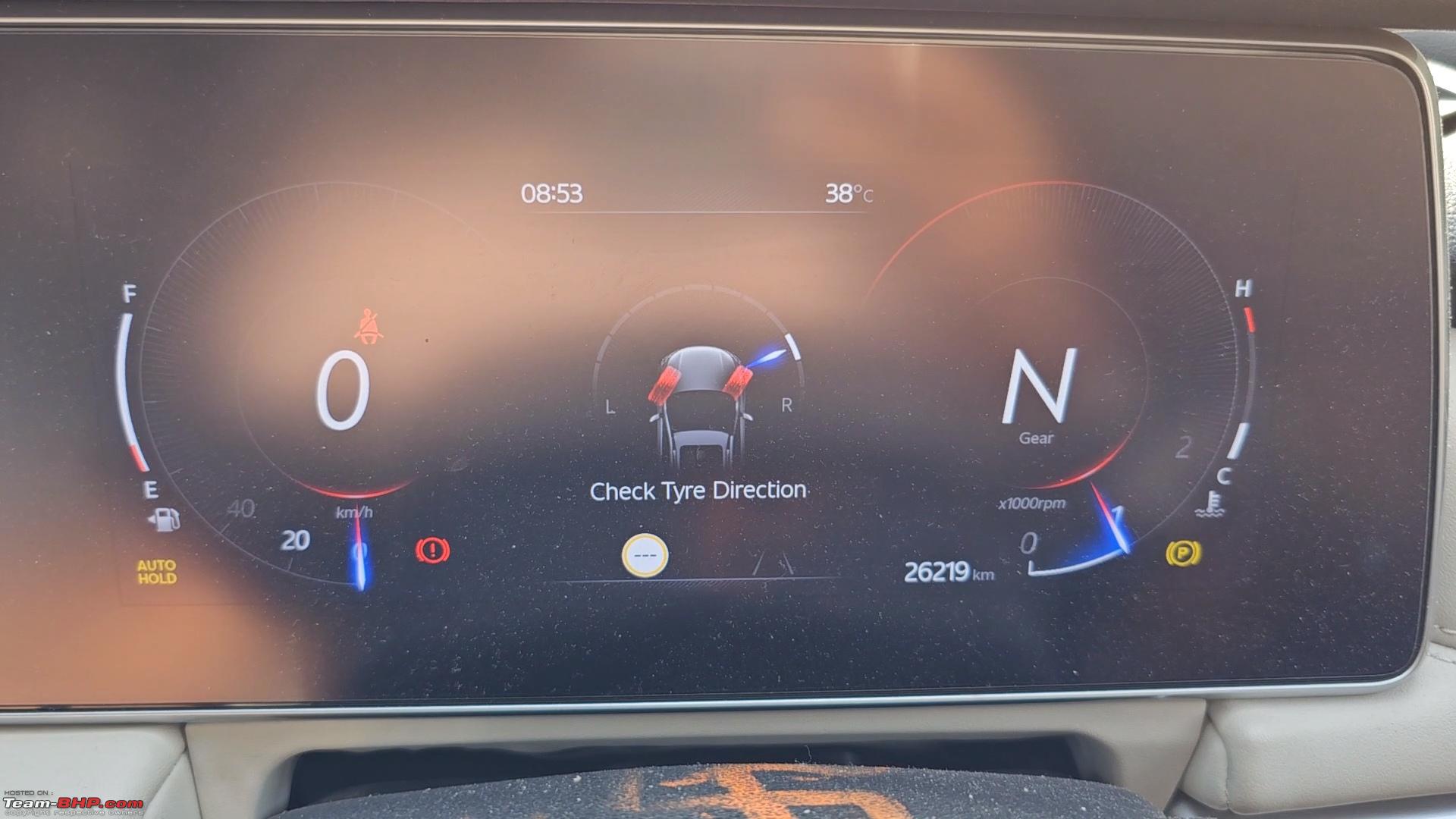

Auto Hold and Electronic Parking Brake Malfunction – Another day, another niggle
Everything seemed normal and just like any other working day had parked the vehicle outside the main gate and after closing it when I tried to move after pressing the parking brake release button, the vehicle did not move. Looked at the cluster and noticed the Auto Hold tell-tale was ON in the cluster which was weird since I never used Auto Hold – probably never using the Auto Hold made it throw tantrums. Recalled from a previous reading of owners manual that these features either have the tell-tale in white or green and yellow / red meant issues. The Parking like indicator in yellow meant it too had a malfunction.
The cluster
The Silver Surfer | Mahindra XUV700 (AX7L D AT) | Ownership Review-mahindra-xuv700-parking-brake-error-1.jpg
Tried the usual ignition cycle with door open/close and lock/unlock but nothing worked. The only option left was to disconnect the battery and this time used the in-vehicle spanner. After restarting, everything was back to normal as if nothing had happened.
Software niggles are nothing new in Mahindra but such niggle(s) hampering drivability is simply unacceptable.
In all these years of driving, for the first time I have had to open the bonnet on the road, even if it was right outside the house
The Silver Surfer | Mahindra XUV700 (AX7L D AT) | Ownership Review-mahindra-xuv700-parking-brake-error-2.jpg

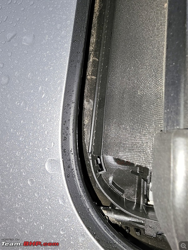

Rain and it’s after effects
The second week of July had erratic rains and one fine morning I was greeted to the sight of water touching the rims (which became the norm for the next 3 days), all thanks to election promises going down the drain instead of water.
The Silver Surfer | Mahindra XUV700 (AX7L D AT) | Ownership Review-mahindra-xuv700-rain-1.jpg
Unfortunately I had parked the XUV7OO in the open overnight and the first thing I checked was if there had been any water entry in the cabin due to this heavy downpour – I am happy to report there were no signs. Opened the sunroof and found that only the channels were wet and the drains did their job as they were supposed to do.
The Silver Surfer | Mahindra XUV700 (AX7L D AT) | Ownership Review-mahindra-xuv700-rain-2-sunroof.jpg

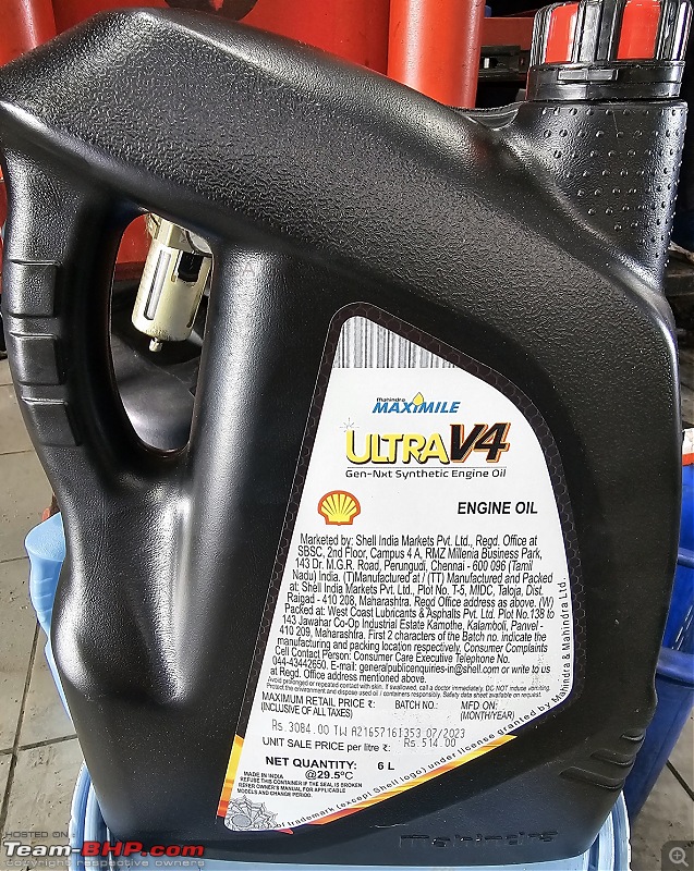

The new Ultra V4 Oil (again no specs on the oil can)
The Silver Surfer | Mahindra XUV700 (AX7L D AT) | Ownership Review-mahindra-xuv700-3-v4-oil.jpg

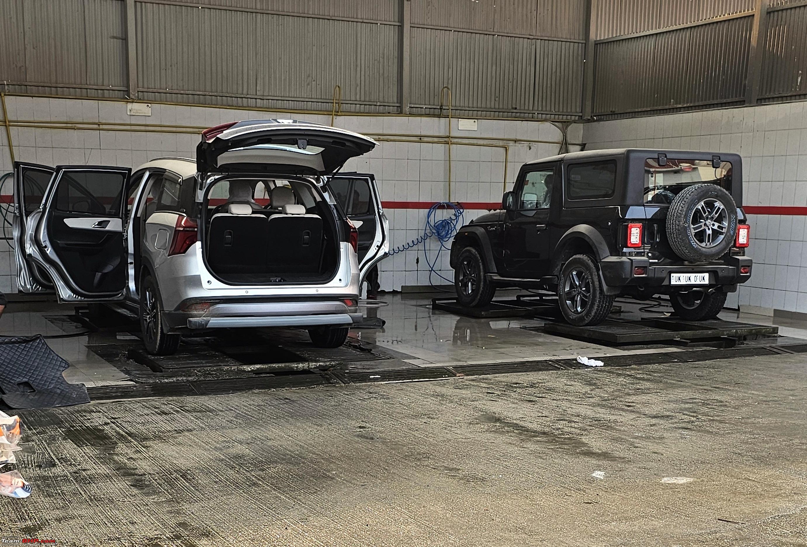

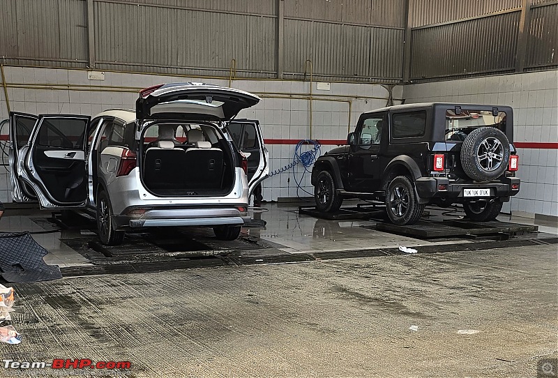

Finally reached the lift for washing
The Silver Surfer | Mahindra XUV700 (AX7L D AT) | Ownership Review-mahindra-xuv700-4-washing-bay.jpg
