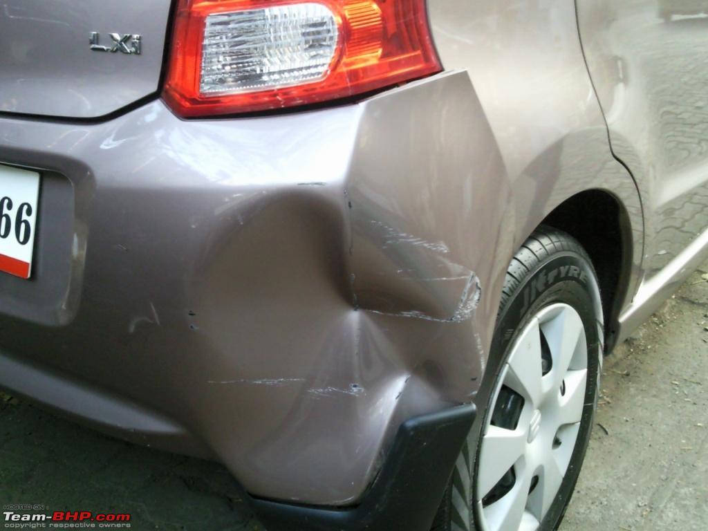

Unfortunately, just a few days back, my neighbour rammed into my car from behind. Here is what happended: My car was parked on the road along with my neighbour's car behind mine. He is new to driving, so he rammed his Hyundai I-20's front LHS while hitting the road. I have attached pics of my car after accident. In the evening I did catch hold of him and he has agreed to pay for the expenses.
I have approached a MASS at Andheri Kurla road, and they have said that the bumper can be repaired, but wont look as good as new. So i have opted for a new bumer along with painting. I have a doubt over here, and want some people who have experience with A**. He said that the code in the User manual will be the most probable match for sure, but for an exact match, he will need my fuel LID. So far, I have been going to Sai Service, but they have never asked for my fuel Lid. Then why are these guys asking for it?
Is that since it is a small MASS, they will source the paint from a MASS with a bigger setup?so they require the fuel Lid?
I am jus worried as I do not want some cheap after market spray or poor quality spray or a poor paint job. The MASS that I have spoken with has a paint booth and I have told them that I want to see the painting procedure take place in their booth (just making sure that they do it in the paint booth and not out in the open).
Guys,I want your experiences with A** especially Maruti Auth. Service Stations with thier painting procedures.

They're asking for the fuel lid to get the paint mixed and matched from somewhere else. To make sure that the mixed paint matches with the paint on your car. There is nothing wrong about this procedure.
Sankar is offline

@Karan - I replaced the rear bumper of my A- star twice and MASS never had problem of matching the colour. IMO , please don't get job done from SAI their explanation of exact colour matching looks dubious to me.
Get the bumper replaced from different Authorised Service station.
What is the total cost of work the MASS is quoting?It should not be more than Rs 4500(inclusive of labour , painting of bumper and the bumper and taxes)

I got the work done and will post the photos tomorrow!
The cost of:
A-star MGP Bumper - Rs. 980 + Taxes = Rs. 1113
A-Star MGA Bumper Corner Protector = Rs. 490
Bumper Painting Charge @ MASS = Rs. 2250
The paint matching is almost as good as the factory's. However, I noticed some dust particles stuck on the painted bumper. Have reported it to the MASS and they have requested me to re-visit them after 3-4 days and they will polish and buff the bumper. I liked the finish and would rate the quality at 3.5 on 5.
