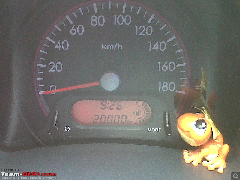

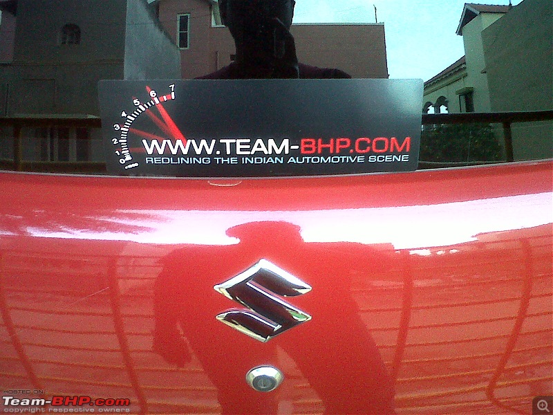

I've received your PM, I don't have an ownership thread, posting some pics of my ride as requested.
Experience A-Star (Read: Experience a star)-img00096201107191619.jpg
Experience A-Star (Read: Experience a star)-img00095201107191618.jpg
Experience A-Star (Read: Experience a star)-img00067201106191814.jpg
Experience A-Star (Read: Experience a star)-img00070201106240925.jpg
