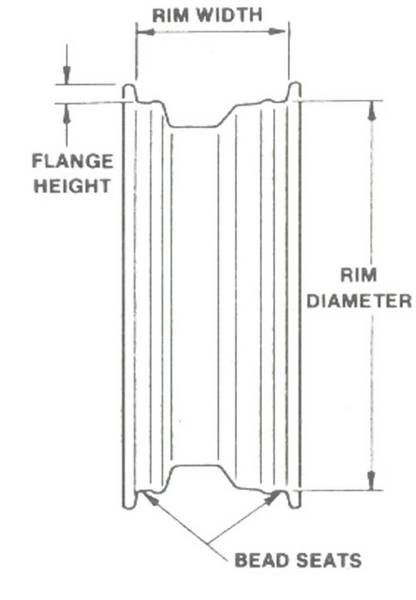

Originally Posted by zenren View Post
I'm yet to see a good explanation mentioning the difference between a 'J' rim and a 'JJ' rim.
"J" and "JJ" denote the codes for rim flange
Ref #3 in this post, to get some visual perception.
Then look at this post to see implications of flange height variation on the tyre bead size.
Then finally look at this post, to see the actual flange dimensions corresponding to "J", "JJ", etc.
