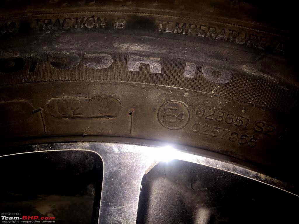

changed my stock bridgestone tyres to Apollo's alnac4g tyres (195/55/r16). Been using them for 4 months now.
Done 5k+ kms on highway and city.Tread is as new as it was,they work fine at higher speeds and no issues faced till now.
