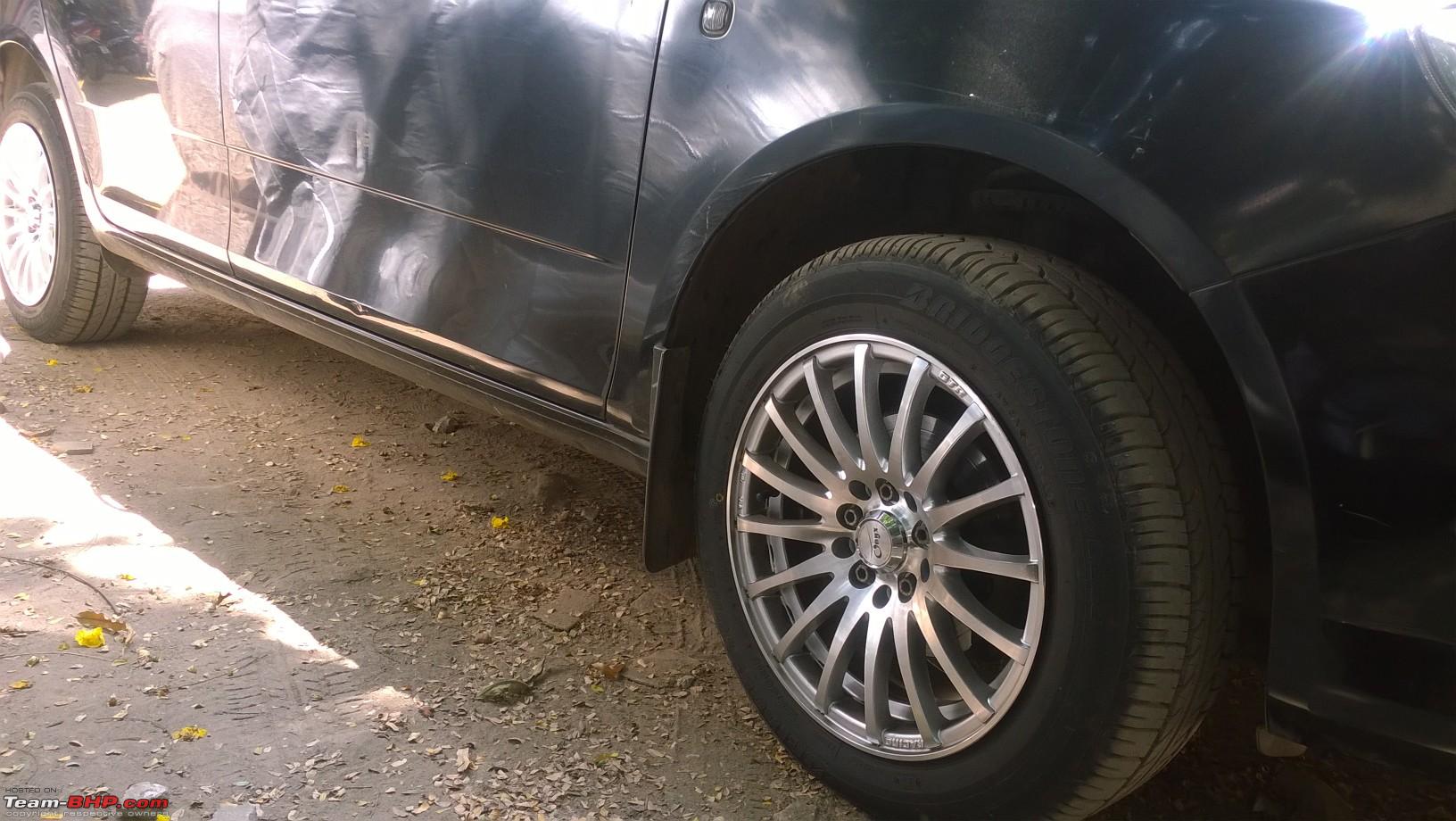

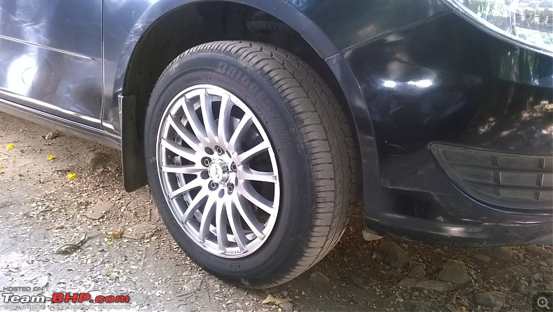

Friends, thank you for sharing information and your experiences.
My long standing wish for fitting alloy wheels to my fabia (petrol) got fulfilled. Bought 15 inch alloy wheels (onyx brand), costed 22k. Tyre is Bridgestone B250...
