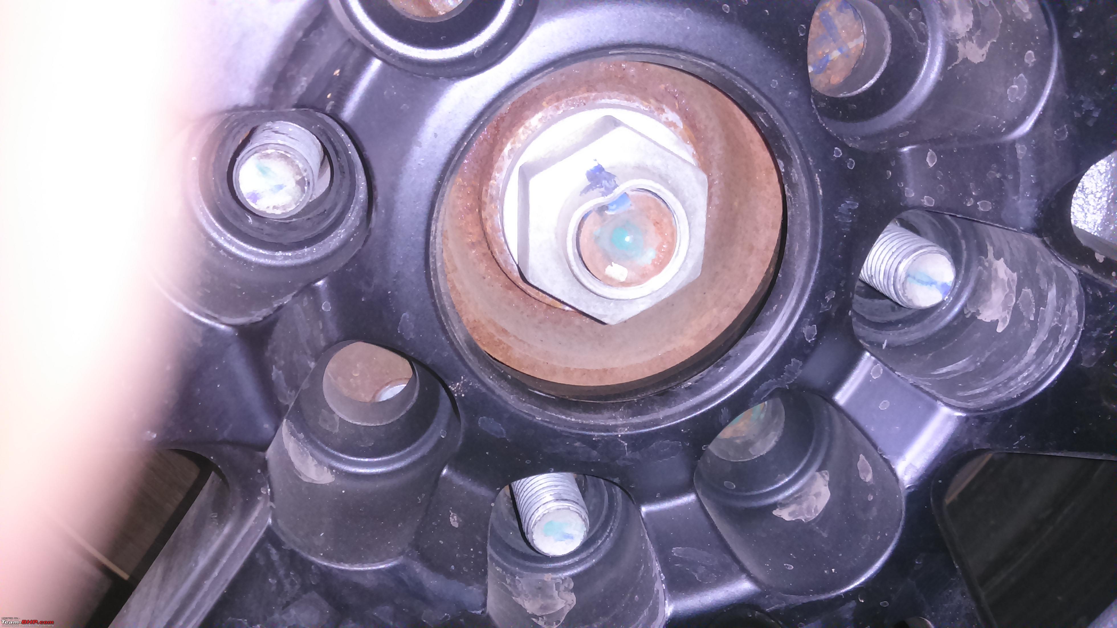

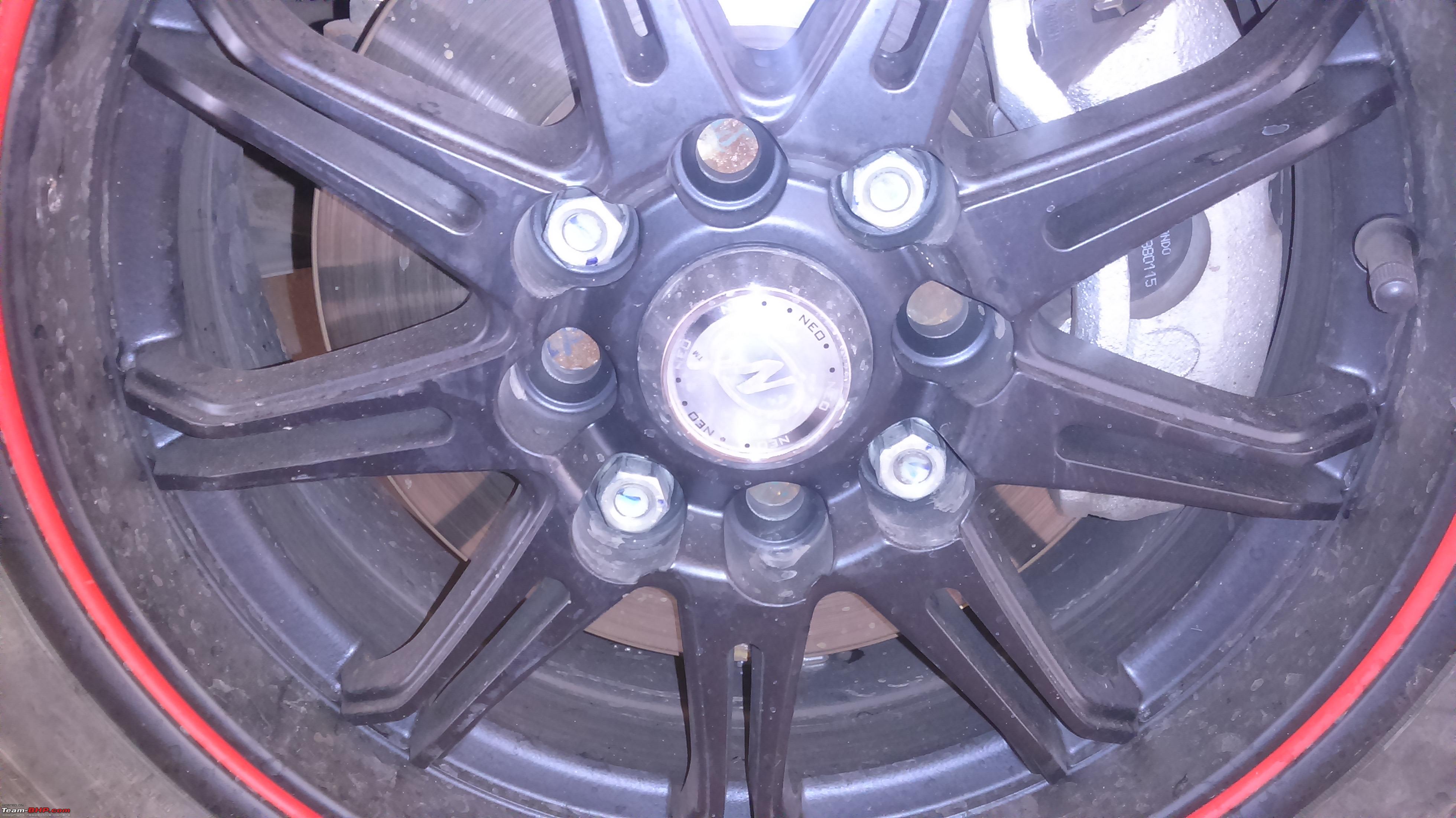

I think my car has got lug nuts. Please see the pictures and provide your feedback, as in one of your post you said if it's lug nuts then not to worry.

Took some pictures at Ashoka and they confirm hub rings not required for 2mm gap. Metal rings would break anyways
I doubt if plastic or rubber ring can withstand such temperature
