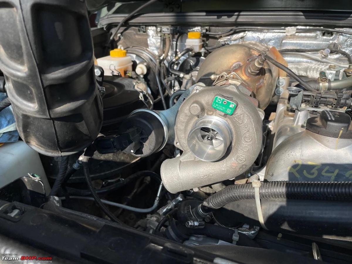

Turbo: Turbo Oil leak via PCV returned, so concluded issue is not oil level related. Cleaned the turbo again and disconnected PCV, will update how this goes.
