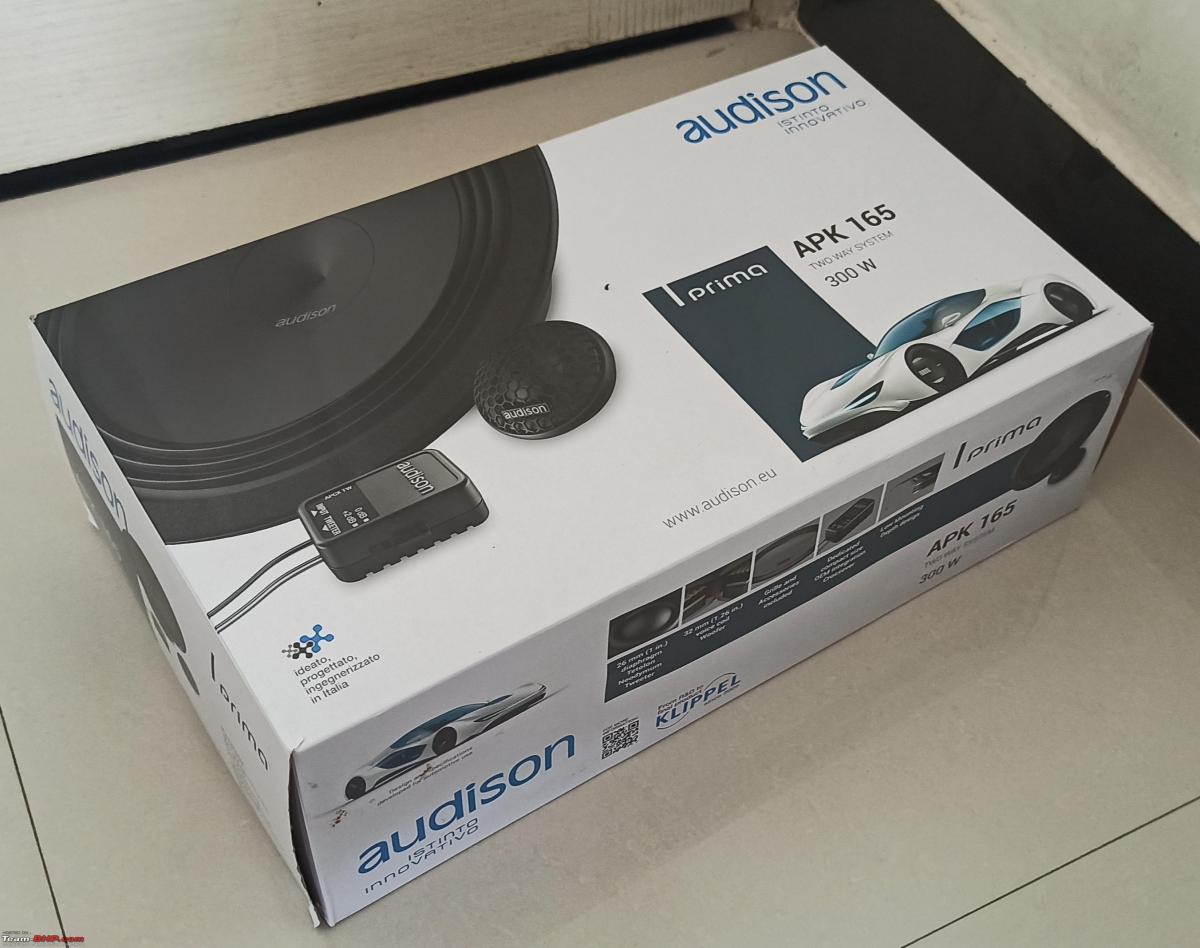

Hence I decided to slightly change the set-up to the below one:
  1. Audison Prima APK 165 Components on front
  2. JL C1 650 Components on the roof
Rest all remains the same.
Audison components were not a direct fit, had to trim the plastic panels a bit to accommodate the same. Took away the JL co-axials and stock tweeters from the roof and plugged in JL C1 650 components and tweeters on the roof.
Audison tweeters are nicely integrated into the A-Pillar.
