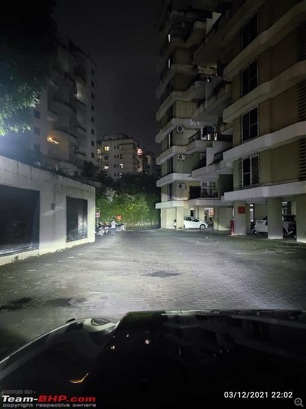

Re: Mahindra Thar : Official Review
Originally Posted by ph03n!x View Post
Can you post some photos, details of the install, cost, etc. please? Thanks!
Posting pics of Genome performance bi-xenon headlights. It was 60 W and 5000k. Cost around 21 k including installation. Front bumper and grill needs to be taken out for installation. Mostly plug and play except splicing needs to be done for connecting to indicators. That is a watch out area to be done properly using scotch lock or equivalent. This is made in India product with 1 year of warranty. Genome has got good information about them on internet. They manufacture in Pune and it helped that my car dealer and installer got me on phone with one of the owners.
