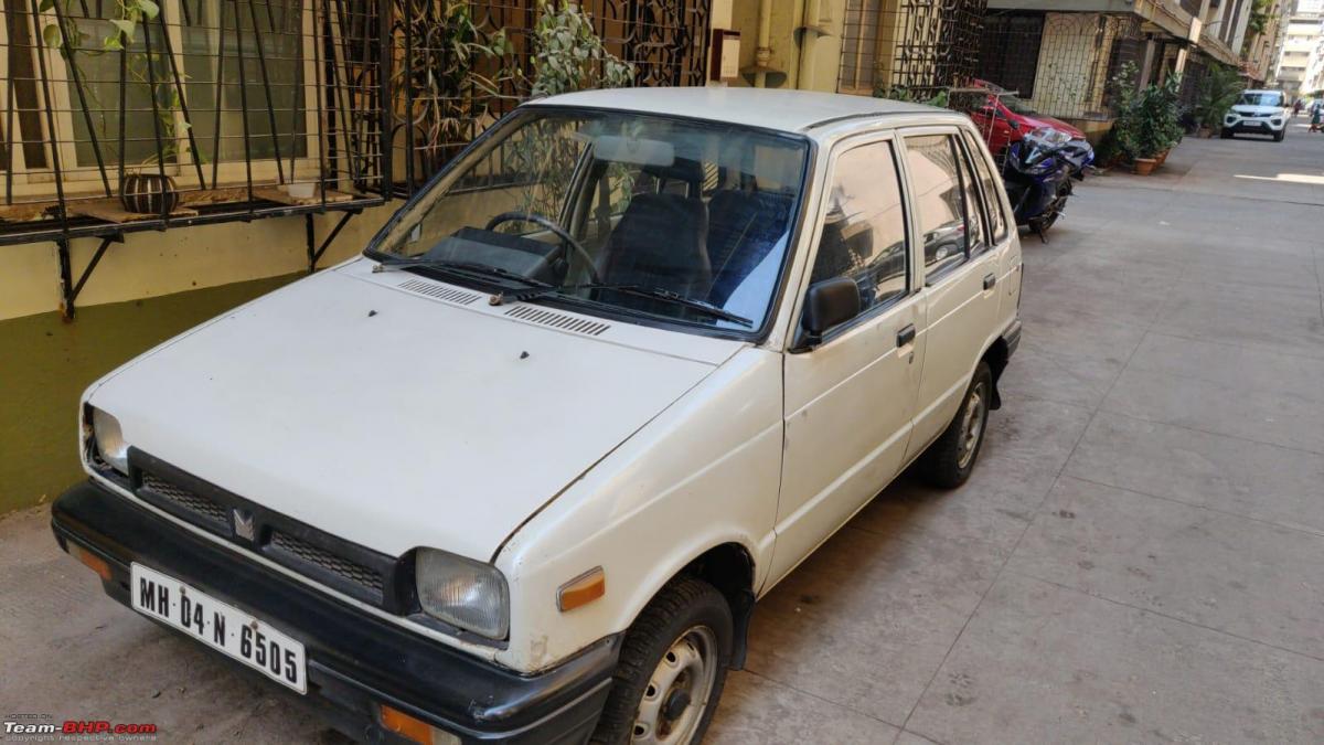

We saw a few cars listed online and a few more in person but none of them seemed to tick the right boxes. They were majorly rust buckets with multiple owners and expired paperwork. The fact that we wanted only an SB308 (Sold between 1986 and 1997) narrowed down the search greatly. One day while scrolling through a Facebook group I came across an ad for a 1995 Maruti 800. The Ad proudly mentioned that the car is a FIRST OWNER vehicle, being posted by the owner himself. It had its fitness and documents in order and was asking for a very reasonable price. There was only one picture in the ad. The car seemed pretty decent going by that one image. I decided to send it to Chetan and he contacted the owner.
Purists would notice that the rims aren't original to the SB308 and are from the Type 2 model. But otherwise, the car seemed fine from this angle at least.

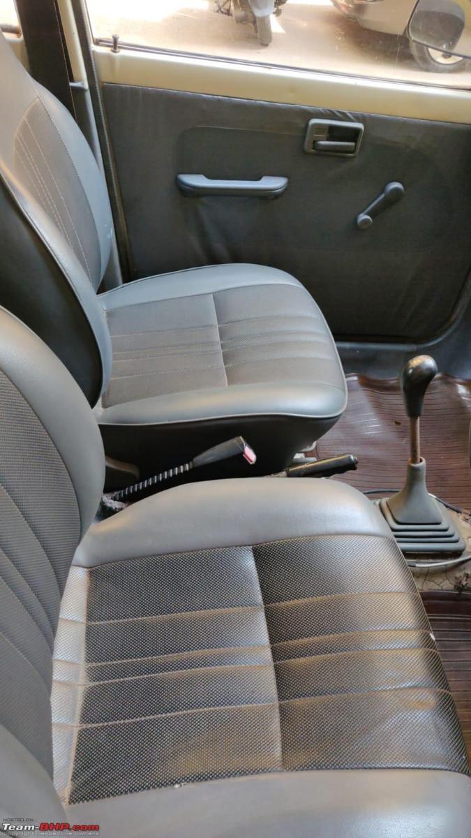

The car did look tired. It was dull, the interior had its share of wear and tear. The door trims were from a later model. But at least it was honest, unlike some of the others we had seen which had fat layers of filler putty painted over the rust to hide it and other hidden surprises. Note that this car was largely still on original paint apart from one of the doors and the bonnet which had been replaced at some point due to a small fender bender.

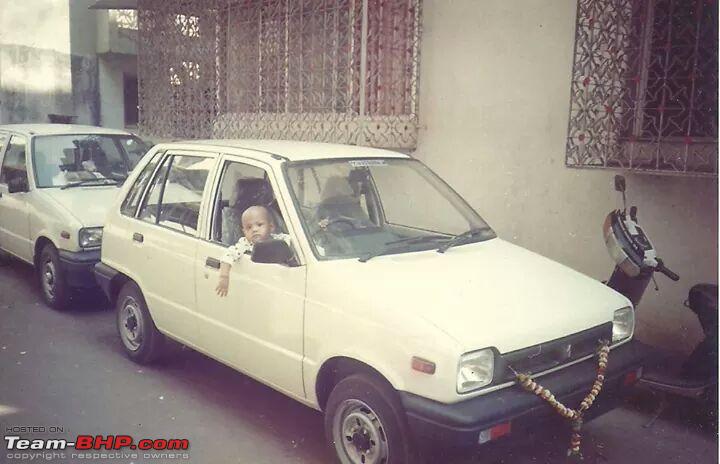

A photograph of the car on the day of purchase, shared by the First Owner. This photograph would remain the ultimate aim for our restoration project as we wanted to get the car to this shape!
