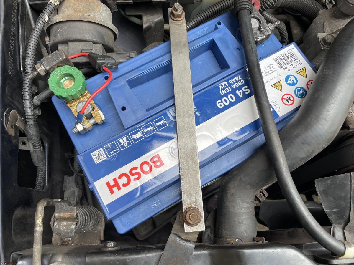

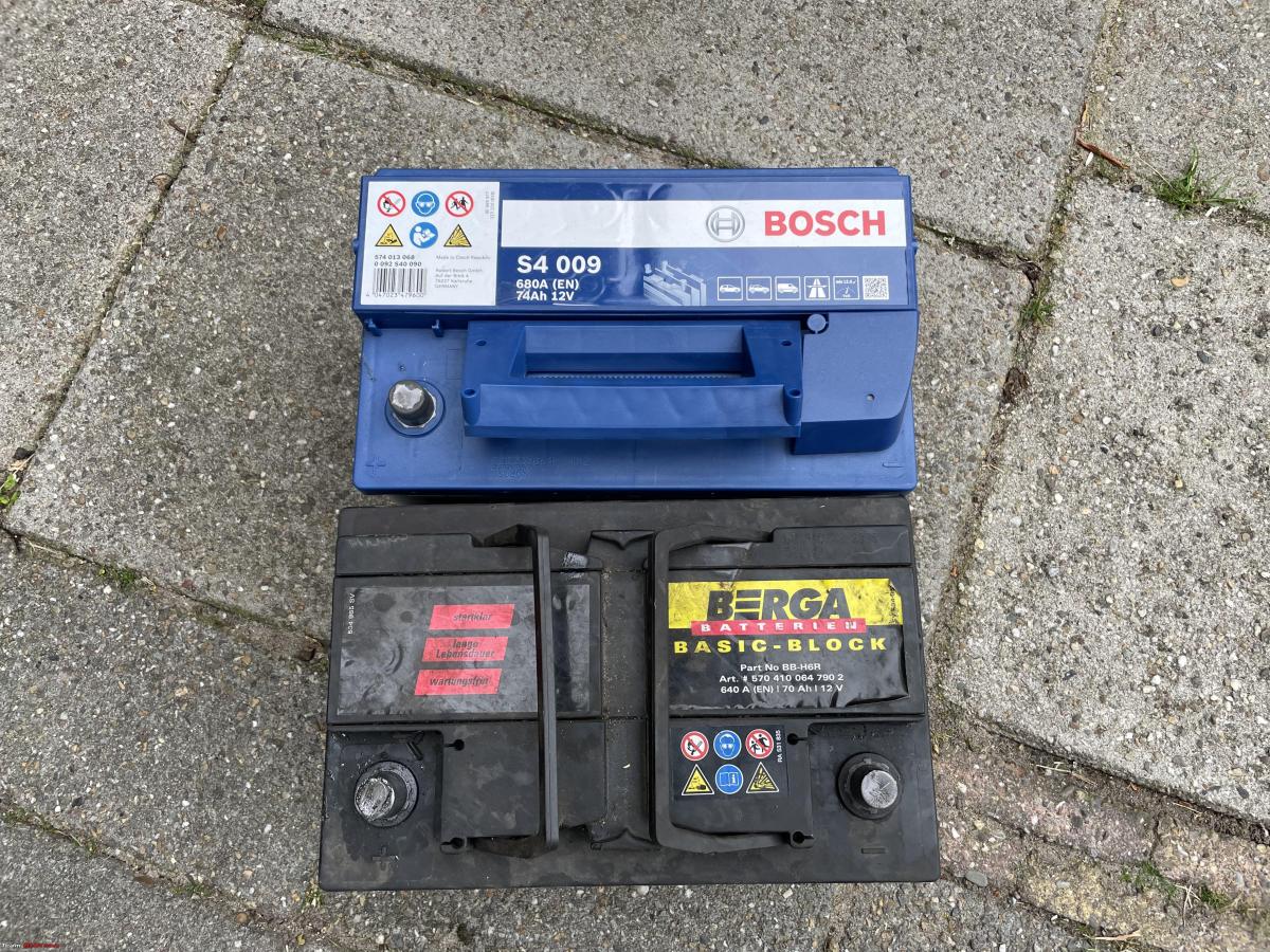

Unfortunately, they did not stock this type of battery, but a car parts store a few kilometres down the road did. The plus and minus are swapped compared to regular batteries. And the cables in the Jeep are too short to fit, so you have to have one of these batteries with swapped poles.
Old and new battery

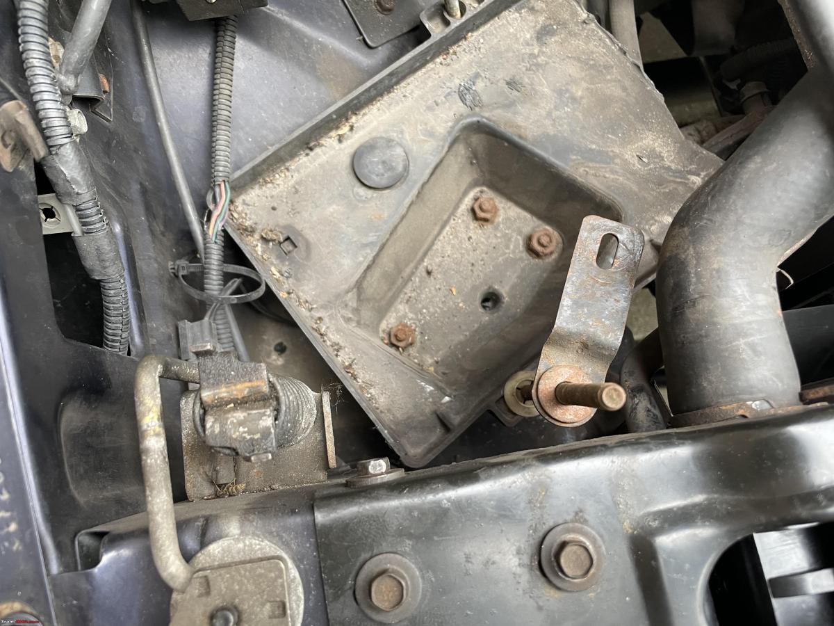

I checked the battery tray, typically you will find a lot of rust here. Not so much, well it's plastic, there might be rust beneath it.
But I did notice that the old battery had pinched some of the wires! Not broken yet, but I will keep an eye on it.
New battery installed, the engine fired up right away, and all looks good.

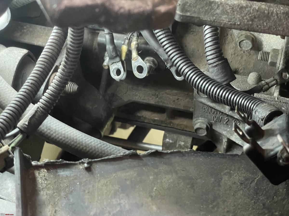

I spend the afternoon cleaning up bolts and wires. I also took off the ground connection and cleaned them.
It is these two studs behind the loose wiring in from of them.
Poor grounds can cause all sorts of problems, so better safe than sorry. Once everything was clean I applied di-electric grease liberally.
The di-electric grease works better than just vaseline I find. Especially in this spot as it is likely to get a bit wet. We will see. Hopefully, the new alternator will arrive tomorrow!!
