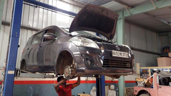

Servicing of the brakes
The car was put on the hoist and the wheels were removed to check the condition of both the front and rear brakes and also replace the brake fluid and caliper pins. The condition of the stock rotors definitely is noteworthy even at 235,000 km.
The pads were in good shape including the rear brake shoes. The handbrake mechanism was adjusted as I had complained that it had become weak.

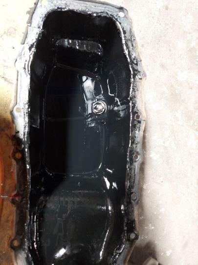

Cleaning of the oil sump
Oil sump was removed with an aim to clean it before fitting in back. The condition of the oil sump was absolutely acceptable, thanks to the periodic replacement of engine oil. The mechanic didn’t have to spend much labour to clean the sump.

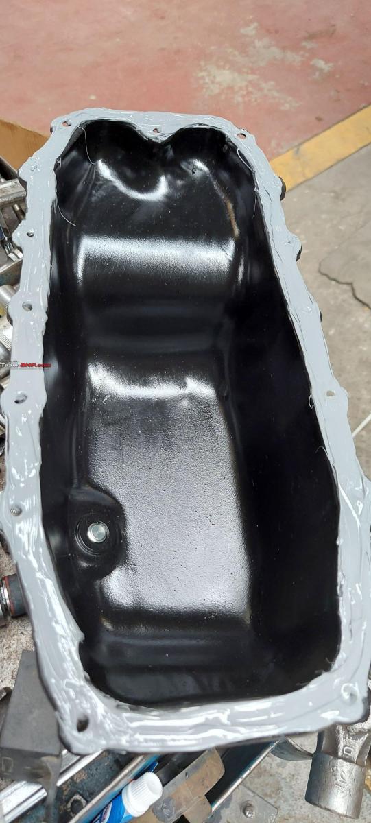

After cleaning the sump, adhesive was applied along the boundary of the sump before it was fitted back. Note that the oil sump doesn’t get a gasket and hence applying the bonding adhesive correctly and fitting the sump back and ensuring to torque all the mounting bolts are very important to prevent any oil droplets from leaking out of the sump.
