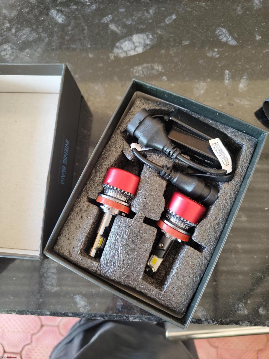

Got a set of Tri-color H11 LED Fog lights from CNSUNNYLIGHT Store and a friend hand-carried them to India. 3000K,4300K, and 6000k is what these LEDs output.
