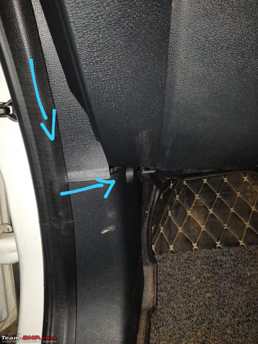

This is yet another simple mod provided if we know the right fuse slot. Just route the wire to the Shotgun's side foot-well and remove the two black screws which are visible. This way, we can access the fuse box without touching the glovebox.
I used this for hardwiring my 70mai Dashcam
Note: Use only a micro fuse tap because other fuse tap sizes will not fit in the fuse box slot.
Pull the Rubber part on the body frame for the wire to pass, the plastic trim can be gently pulled using hands. The trim needs to be removed so that the wire can pass through easily. Then route the wire through the exposed cover and connect the fuse tap to Fuse# 6. Use a nose plier to remove the existing fuse from the fuse box
Wiring routing bottom
Wiring routing from top (inside the car)
Wiring from the side
Fuse box after removing the foot-well cover (use only the yellow coloured box marked for Dash cam fuse tap)
Fuse Tap
A scary moment for me was when I had used the fuse tap in the wrong fuse slot and the dashcam was on. Then Naveen came to the rescue by calling me up and telling me to switch the fuse tap to fuse# 6 so that the dashcam will turn off when the ignition turns off. Plus I had used a different tap which was not slotting at all. Then I tried with the micro fuse tap and it worked. The ground is not fixed properly and vehicle loses communication with the BCM while I'm trying to start the engine. Then, I had changed the position of the ground and everything was working as usual.
