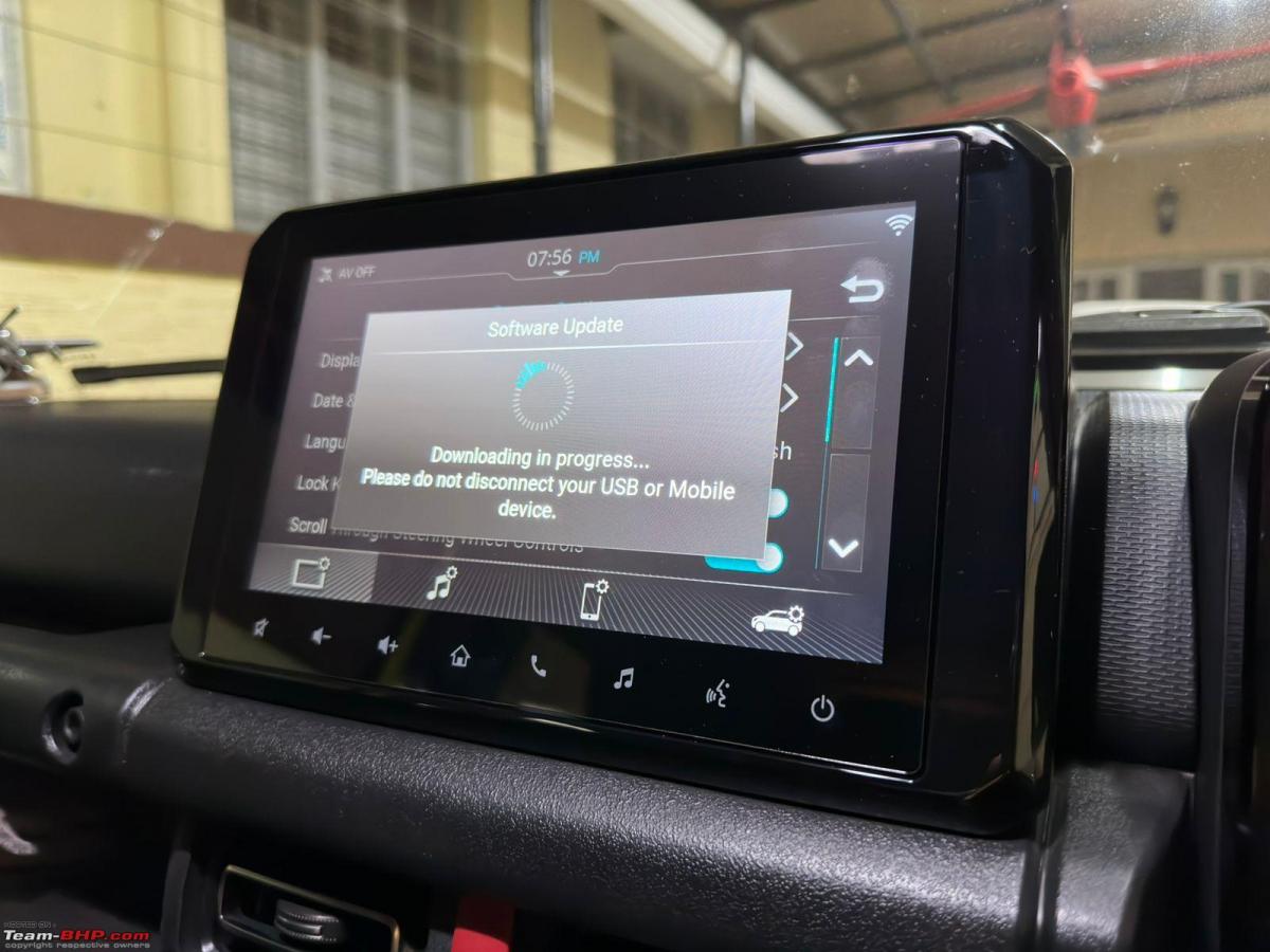

The minute the USB is plugged in with Update.pkg file on it this is what will be seen on the screen. Press Yes for software update :
It will show downloading in progress. Then it will go it verification - boot automatically and finish in about 10 - 12 mins total.
