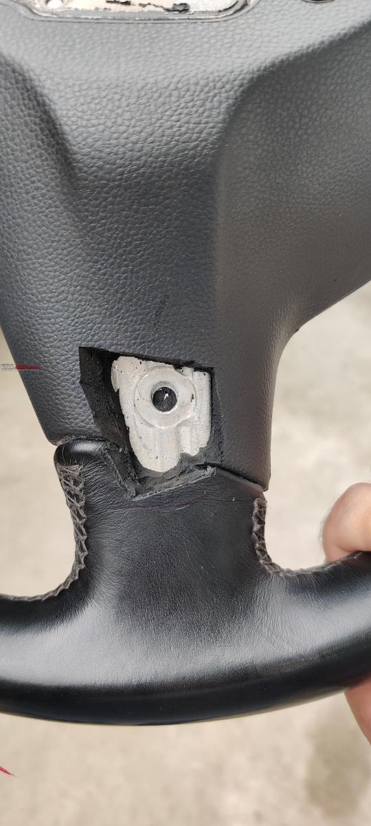

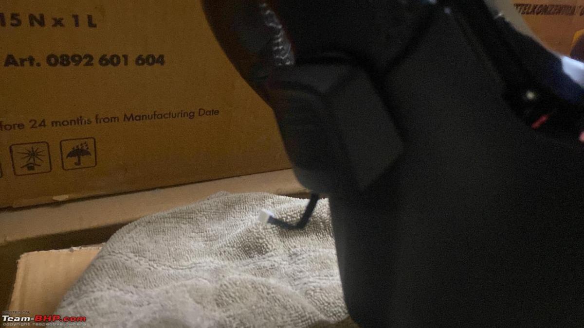

Methodology:
  • Remove standard wheel.
  • Make cuts on the back of the wheel where screw provision for paddles already exist (happy surprise for me). Cut throught the soft rubber like material and leather where needed to seat the paddles properly.
  • Remove standard switches.
  • Screw the new paddle shifters into the provisioned hole in the steering wheel.
  • Plug the 3 wire socket of both the paddles into the new switch assembly
  • Install the switches
  • Install the now upgraded wheel and enjoy the DSG shifting as it was intended.

  • I used the Chinese OEM paddle shifter wheel borrowed from the ever so kind Mr. Barman at eurocar_retrofits to use as a template.
  • I wasn't aware before this mod that standard Indian switches also have the pads for the socket on the back side for paddles, just not the socket. You can potentially install sockets or directly solder the paddles saving some $60 for the switches.
Some pictures. Apologies was too excited to finish up so forgot to take detailed step by step installation pictures.
