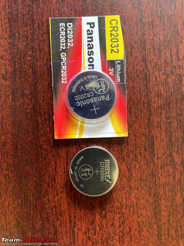

Now that it is open, replace the battery with a CR2032 battery, I paid 50₹ for my replacement Panasonic one. The original was by Maxwell. Positive terminal is labelled.
My replacement battery had a textured negative terminal, it isn't an issue.
