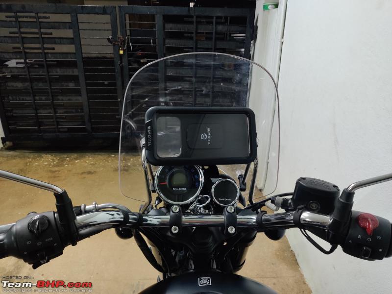

The mount received seems to be of good quality and finish. This mount must be fixed on the headlight bolts. As there is only one bolt on either side there is a possibility of movement while riding. So, they have provided additional connector which will be connected to the bolt below trip meter. Which makes the overall structure 3-point joint and restricts the movement in any direction once it is fixed.
Being DIY enthusiast, I tried to install it myself. But without the understanding of headlight assembly design, I kept on trying to loosen the bolt with Allen key for 15 mins only to realize the nut inside the headlight was also rotating along with . By that time, I had lost the energy and patience and took the mount to local garage and instructed him how to install it. After that it was just a 10 mins work for him. Mount is quite sturdy and not touching my speedo meter or the windshield.

Liked their attention to the details, contours are exactly matching with the shape of speedometer.
Final product
