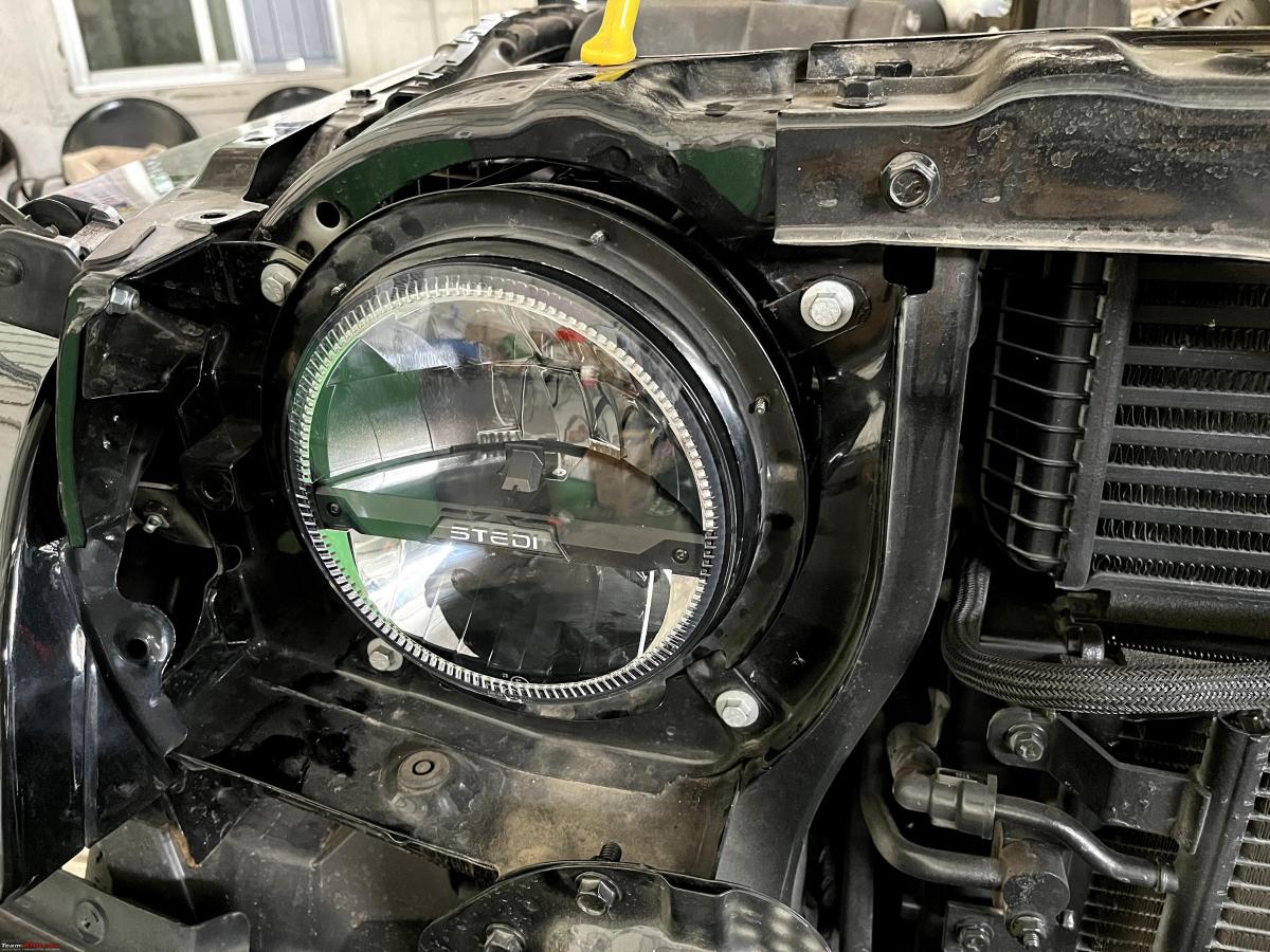

Fitting :
It is a direct swap except the frames which the headlight sits needs to be filed a little bit. Did the fitting at my friends place. The technician helped with aligning the lights as well.
