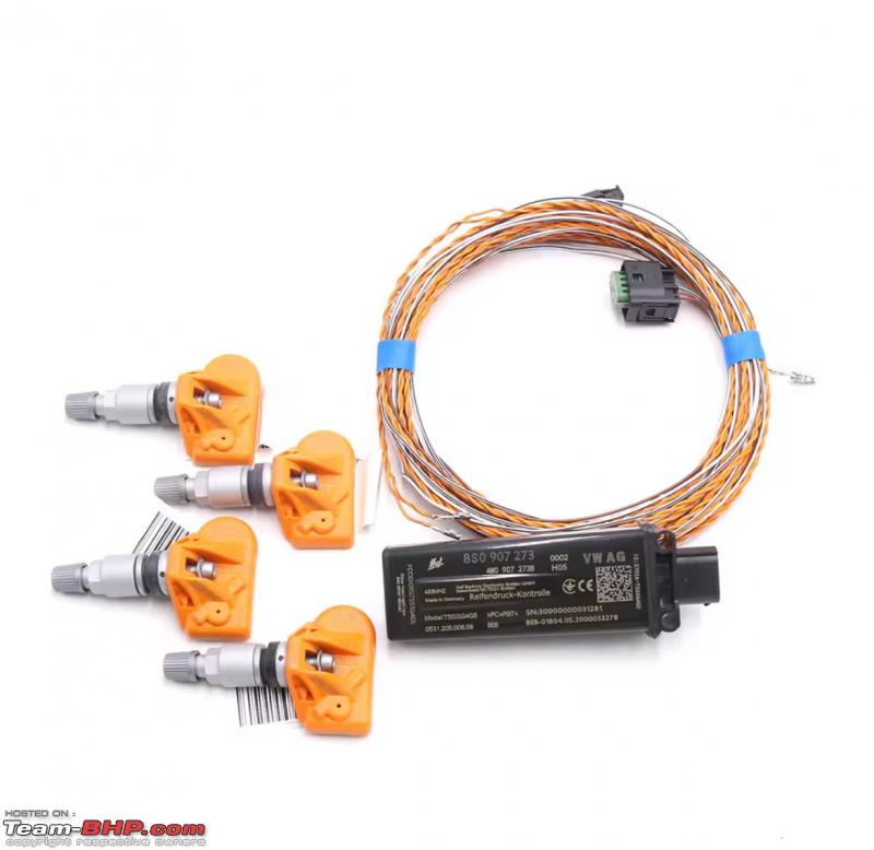

The kit is like this:
Contains four wheel sensors and a central antenna. My first trial wiring the controller to the car was unsuccessful since the controller had communication issues with the car. Then again took the plunge and ordered a spare controller from a different seller and this worked. The wiring is very simple, you need a positive, ground, CAN L and CAN H which was initially connected to comfort CAN. But I couldnt find any option in the cluster to get a live display of pressure, leave alone readings.
Got the wheel sensors mounted in the beginning itself since even if they wouldnt work, the valve stems were rigid and looked much better compared to the rubber stems present earlier. After different experiments with coding and wiring, I realised that there was no possibility of a TPMS menu appearing in the cluster. Left the setup as it is and declared the experiment a failure.

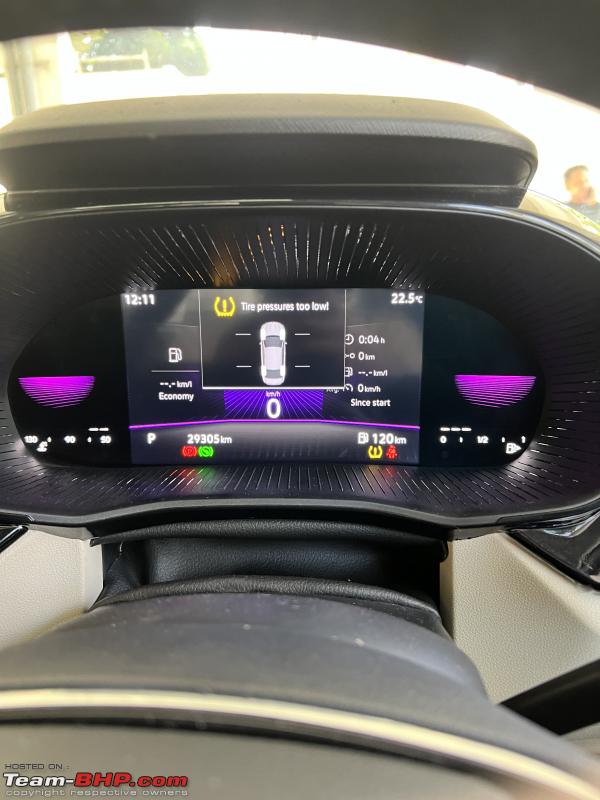

Last week decided to conduct another experiment, I intentionally started deflating one tyre to see at least if I can get a legit warning from the car and this is what I got:
I saw this type of pop up for the first time ever, whereas the earlier warnings were different. So now it was guaranteed that the 8 inch VC can actually show individual tyre pressure readouts. However I couldnt see the tyre pressures nor the indication of which tyre had lost pressure. This was one step forward with more to go. But in diagnostics, the TPMS reported the correct values:

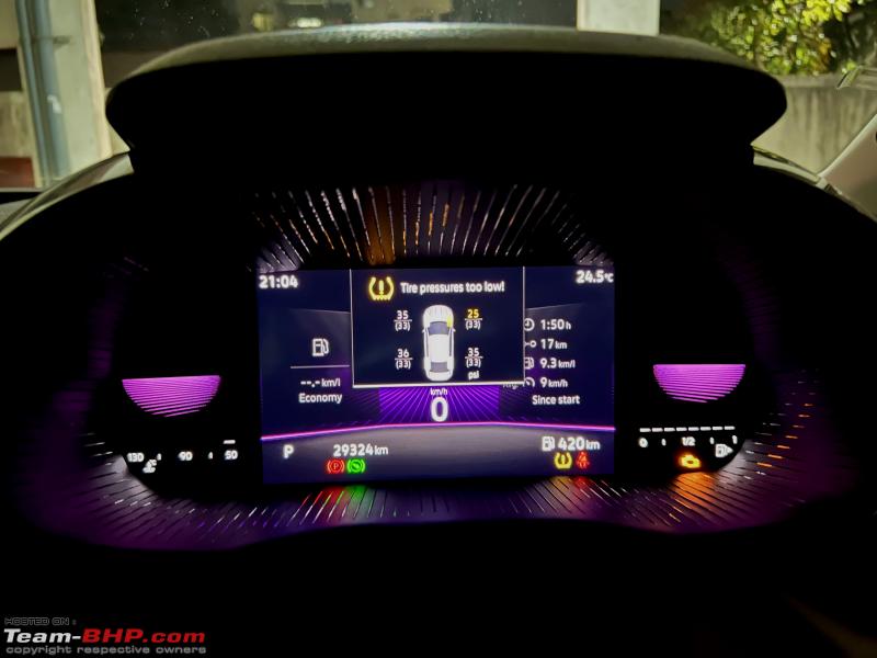

Then it meant two things - Either the cluster isnt coded properly, or a potential network gateway limitation on this car. But if it worked on the high end cluster, it should work on this as well. Hence, tried one last thing - created a customised dataset and reflashed the TPMS ECU and voila:
This menu pops up during ignition ON and can tell which tyre has low pressure. This itself was an achievement after all the experiment. I also tried deflating other tyres and checked it worked accurately:
