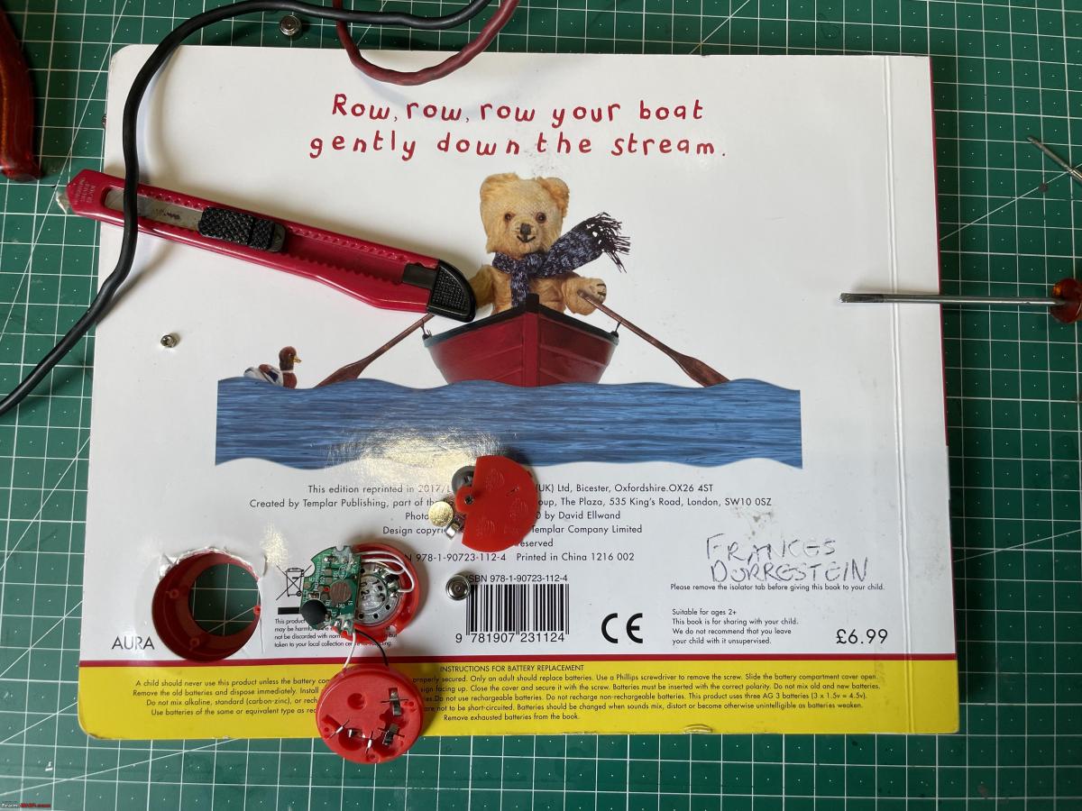

A small, but very important, repair job popped up. Our grandson's favourite talking/singing book stopped singing!! Opa to the rescue. The batteries needed replacing, but then it still would not sing! So I took the little electronic music box apart, checked and cleaned it, popped it back in and now it works fine again!

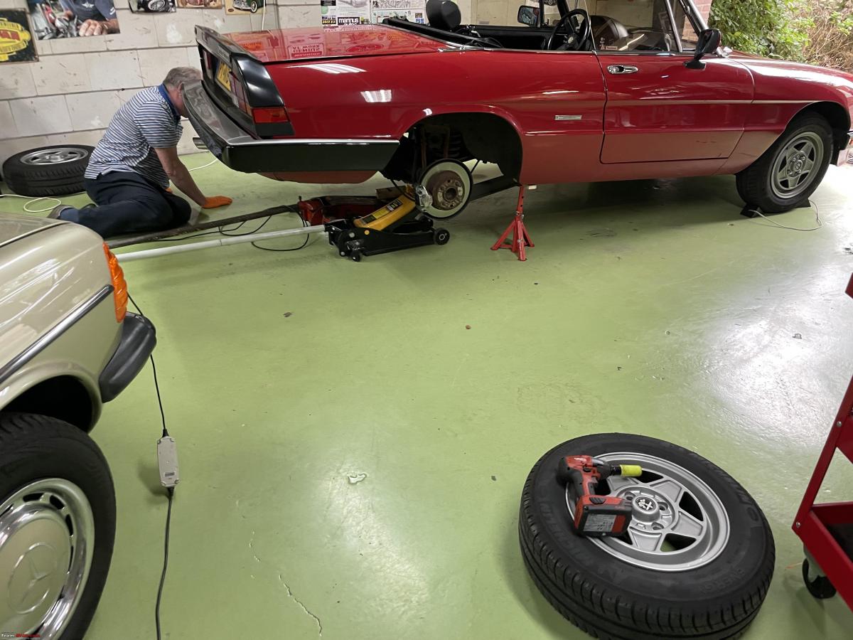

Moved the Jaguar out of the way and positioned the Spider so we could easily work and walk around it.

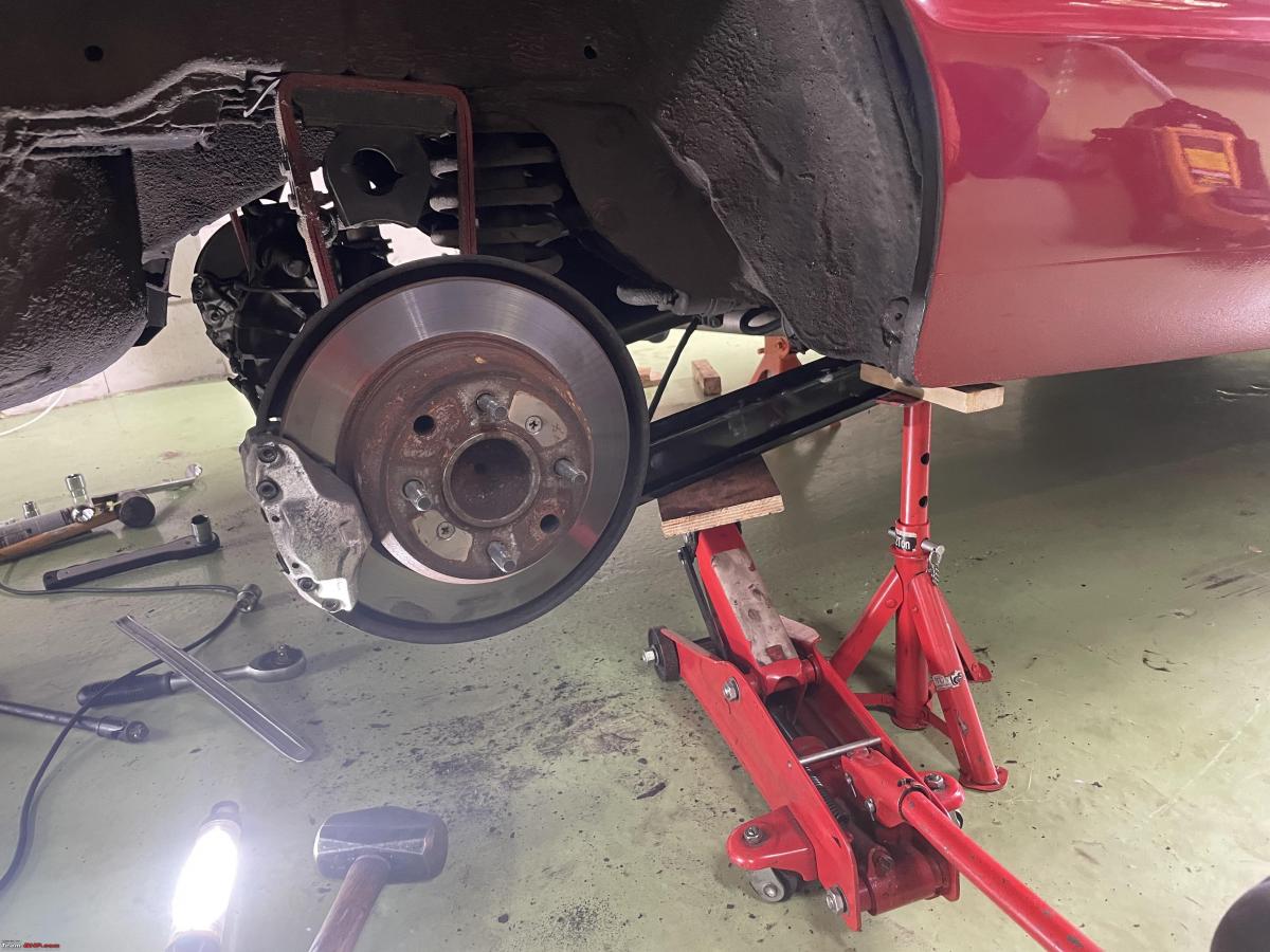

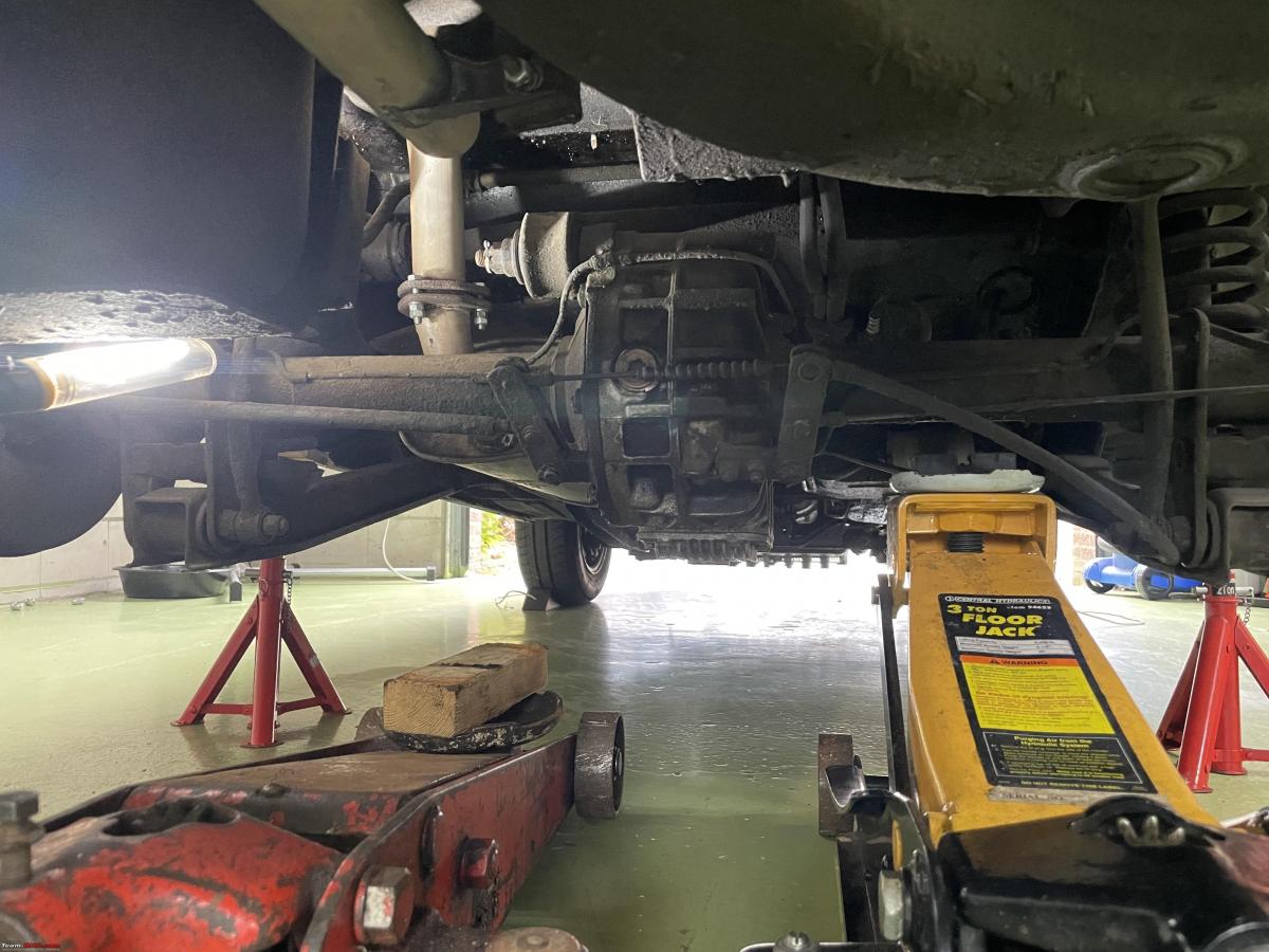

First thing. With two jacks we raise the rear of the Spider quite high and put the chassis on axle stands.

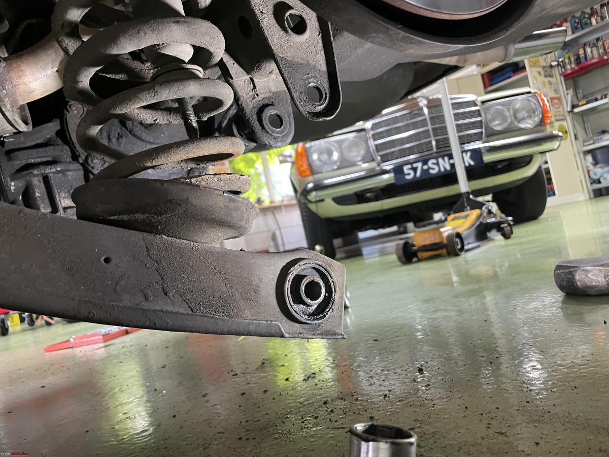

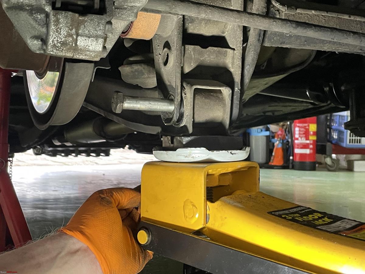

Next, we place a jack underneath the trailing arm (Because it is still compressing the spring!) and undo the large bolt holding it and the stabiliser bar in place.
Next lower the jack carefully, so the spring unloads and then remove the forward bolt holding the trailing arm to the chassis.
All went pretty smoothly.

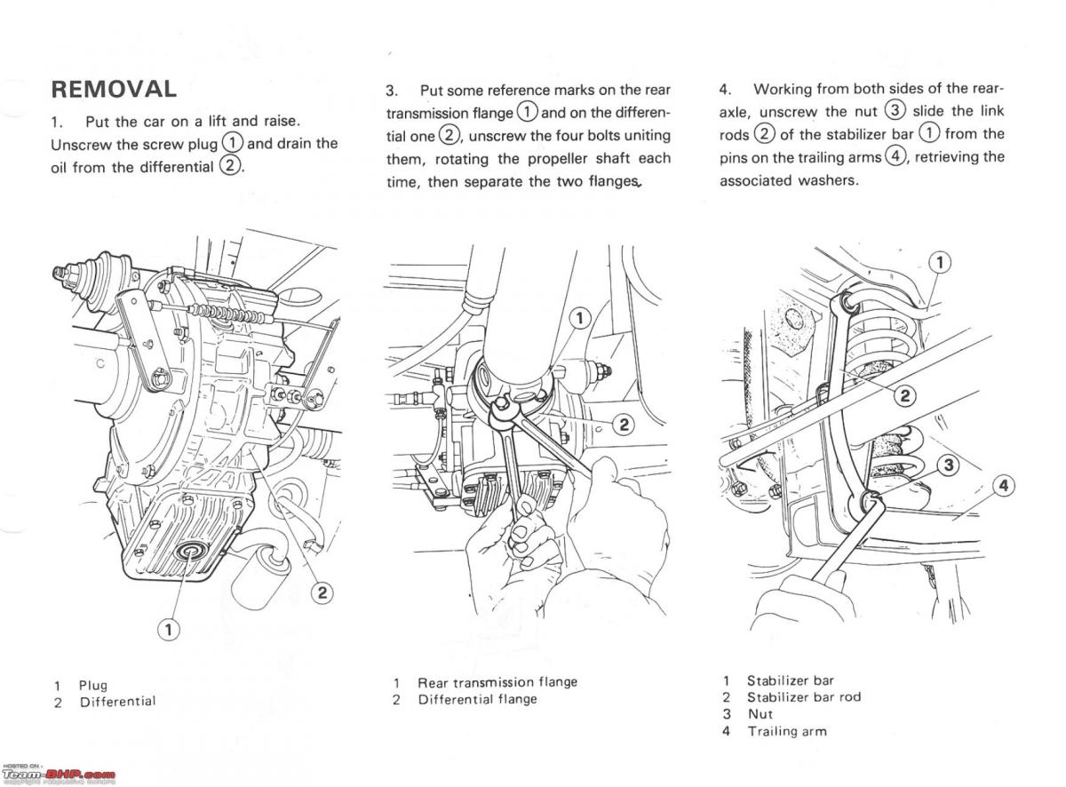

With the trailing arm removed, the rear axle and differential hang in the rebound strap. We thought we could just push the whole axle to the right to get the second part of the Diabolo out. We put a jack under the differential for easy manoeuvring, but eventually found we also had to loosen the prop shaft. Always make sure to mark the flanges, because they need to go back together in an identical orientation!!
With the prop shaft disconnected we could easily manipulate the whole rear axle and push it so far to the right we could extract the other Diabolo half.

Peter doing some technical!! At our age, this sort of work is not impossible, but we are not as agile as we used to be. So it does take a bit longer!!
