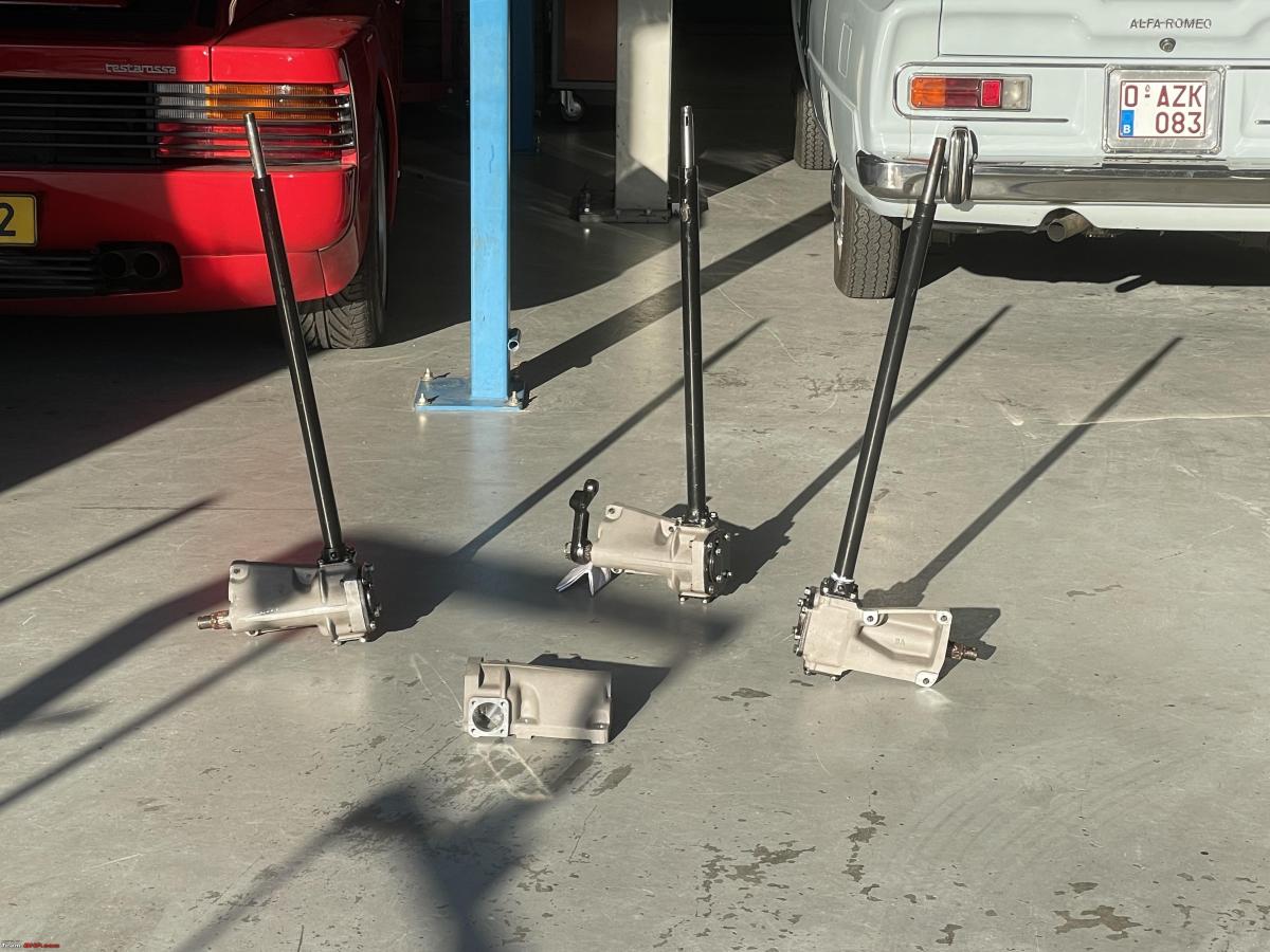

I picked up my overhauled Burman Steering box from Alfa Spider specialist Marc a couple of days ago. When I arrived at his workshop this was the sight that I walked into.
Marc always does a batch of these steering boxes together. Mine is the one with the pitman arm installed. I thought it looked odd, but Marc confirmed he only loosely attached the pitman arm in this 180o incorrect position, for transportation.
I am glad he left the pitman arm off as it will be easier to re-install the steering box without it.

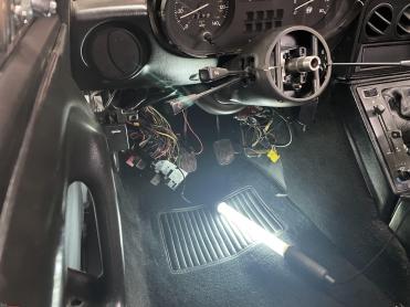

With the steering box bolted back onto the chassis, there was a lot of work needed to get everything sorted and back together under the dashboard. Literally back-breaking work. Especially at my age!
Aluminium support tube all aligned underneath the dashboard.

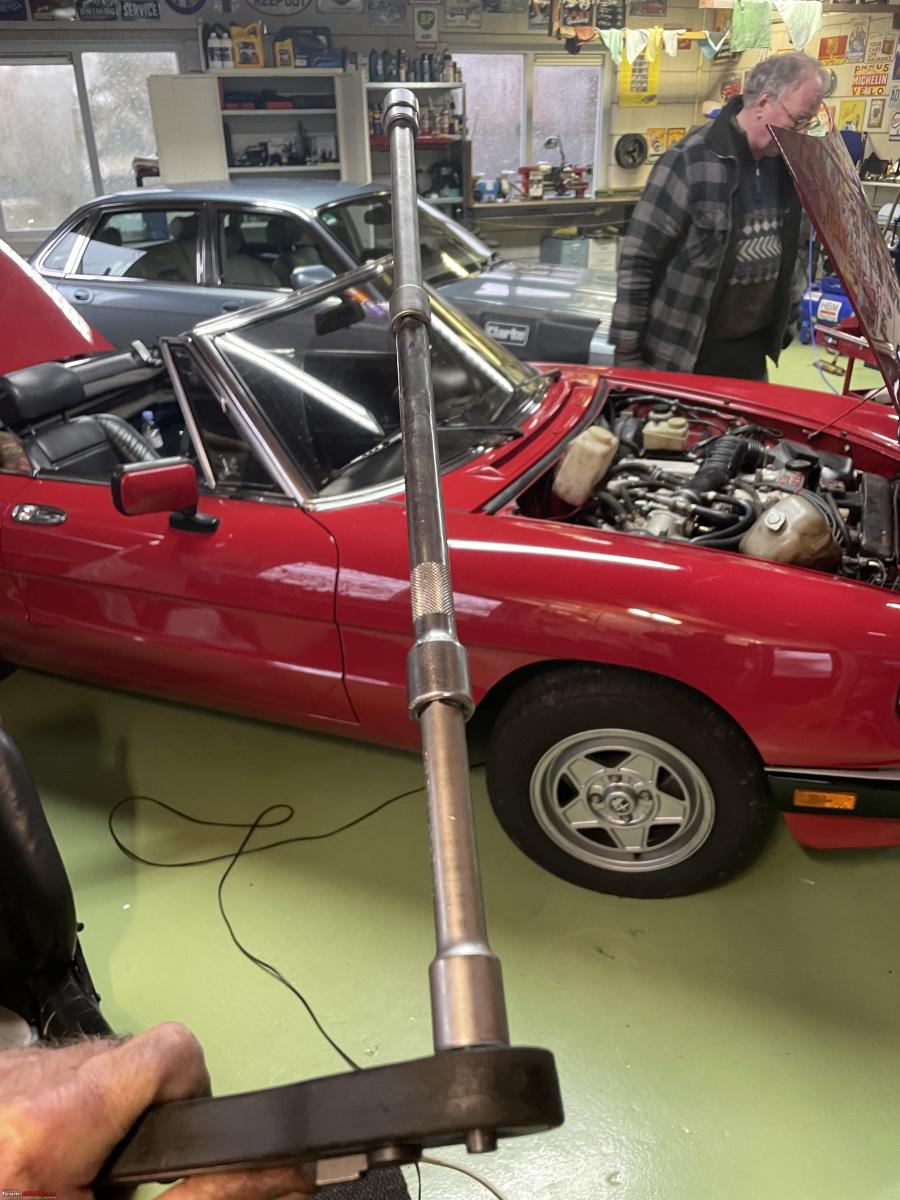

When he got back we decided to attach the steering rods to the pitman arm.
Luckily you have easy access from above to the self-locking nuts off the ball joints. But I needed three extenders on the socket to reach.
