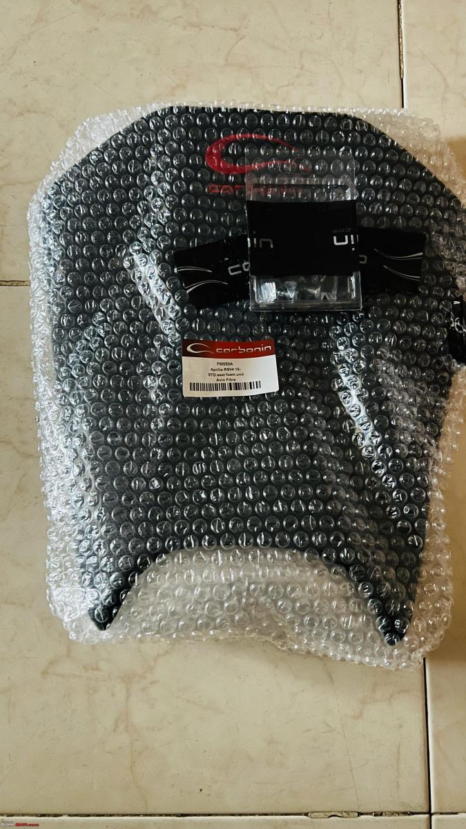

The bike was parked all this time as there were no track days coming up. We were supposed to have one this month, but that fell through due to the unavailability of dates and then the rains in South India also put things on the back foot. So I thought of using this opportunity to do some work on the bike. I finally took the plunge to get a set of race fairings - I got them from Carbonin, a Slovenian company that makes fairings for various race teams including the BMW WSBK team. They offer two kinds of race fairings - one called Avio fibre (which is supposedly lightweight when compared to the traditional glass fibre fairings) and then carbon fibre.
I would've loved to get the carbon fibre one, but that was very expensive and I wasn't really looking at the last gram of weight savings. Also, the thought of getting it repaired in case of God forbid a crash was in my mind. They have a distributor in the US - Hustle Hard racing and I placed my order through them. The whole thing took about 10days to reach me. The shipping was done via FedEx and they handled the customs for me. All I had to do was receive the shipment at my home and pay the FedEx guy the amount of the custom. Can't get any better than this.
I got the fairings installed at IndiMotard's GreaseHouse yesterday and the whole process was finished in a few hours time. The fairings came with pre-drilled holes and Dzus quick turn fasteners supplied as standard. They had also fitted the appropriate rivets for the quick turn fasteners. They are extremely lightweight and come reinforced with carbon fibre in the pressure points and flex areas. The build quality & overall fitment was top notch and except for two areas, we did not have to touch the fairings in any way. The seat pan & the belly pan had to be trimmed a few mm in order to fit flush. The guys at the shop had fitted race fairings by another brand recently and they mentioned how much work it took as holes had to be marked and drilled and this installation was such a breeze compared to that.
They helped pack the OE fairings neatly into the same container and this should result in losing a few more kilograms of unsprung weight from the bike. The fairings come primed ready for painting and I intend to replicate the OE colours onto the fairings.
