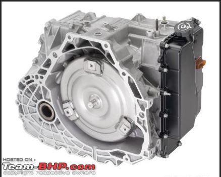

The torque converter in an AT is used to maintain the fluid coupling between the engine and transmission. This fluid coupling helps in the transfer of power from one shaft to the transmission shaft.
The transmission shaft leads into the automatic transmission where the planetary gear sets are placed. For a 6-speed transmission, two planetary gear sets are working in combination, while for an 8-speed, you need one more gear set and so on. The clutch discs help in moving the gear sets, while the Transmission Control Module sends signals according to the throttle input and driving conditions. The movement of the clutch discs is operated through the valve body (the black color part) or sump placed at the bottom/side of the AT.
The torque converter automatic gearbox is one big marvel of engineering. The tolerances involved in the AT are so minuscule that even a 0.1mm change can lead to oil leakage and performance loss.
In short > throttle Input > Transmission Control Module > sends signal through actuators to valve body > releases fluid to engage or disengage the clutch > planetary gear set moves to increase or decrease the speed.

A typical complete Automatic Transmission consists of various individual sub-assemblies like:
  • Standalone Torque Converter aka fluid coupling which receives mechanical power from engine crankshaft/engine flywheel via external ring gear being part of Torque Converter assembly.
  • It is a fluid coupling in itself with or without lockup clutch component transferring power from engine flywheel to input shaft of epicyclic gear set(s) adjacent and outside of Torque Converter assembly.
  • Torque Converter output shaft would receive mechanical power from fluid coupling (with no lockup clutch in operation) or from lockup clutch set (as and when lockup clutch is put into operation), hence, splined to and transfer mechanical power to the input shaft of epicyclic gear set(s).
The above 3 sub-sets of components is housed internally in one complete housing/assembly as pictured.
  • Epicyclic gear set(s) whose input shaft receives power from Torque Converter Output shaft.
  • This incoming power is controlled and directed by sub-assemblies within Automatic Transmission Housing like Clutch/piston set assemblies for varying speeds of 1,2, R, N etc., and control valve and its actuator system.
The above 2 Sub-sets are housed internally within the transmission housing proper adjacent and bolted to Torque Converter Housing/assembly.
  • In varying transmission speeds of 1, 2, R, N, etc., the output shaft of the epicyclic gear set delivers mechanical power to the propeller shaft(s) in the case of a RWD or to Front axle half-shafts in the case of FWD.
Just my 2 cents.
