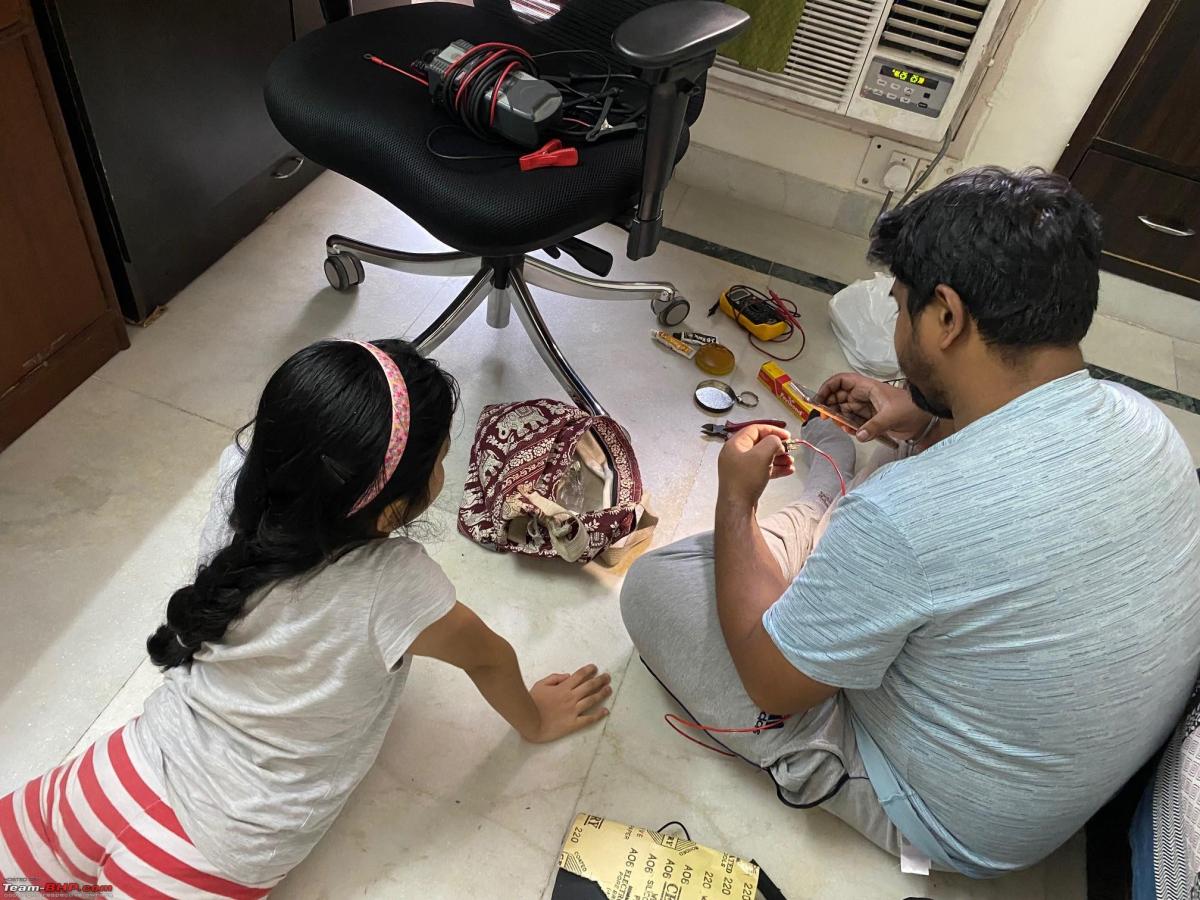

The customer cooling mod is basically bypassing the factory trigger for fans to start kicking. The biggest issue with the R1 is that the fans trigger at 105 degrees which is too high. We wanted to bring it down to around 95. So in the cooling circuit, a new temp sensor was fixed and it was connected to the fan and headlights, so that it only gets on when the bike is started.
This time around, 2.1 to 2.2 litres of coolant went in:
 The new temp sensor on the outflow side of radiator:
My daughter got a new victim whom she could pester:
Overall, I think the new coolant flush helps. I do feel that now the bike does take a bit longer to reach its peak temps. However, it is only a bit longer. This bike still heats up a lot pretty fast. One traffic light is all that is needed. You need to keep moving and at a good pace to keep it around 80-90 degrees.
The cooling mod did help us bring down the fan trigger point to 101 degrees. I think we would need a different sensor which has an even lower trigger point for our goal. Arjun told me he has found one, we just now need to change the sensors. Earlier the highest I had seen the bike go was 110 degrees, now it does not go above 106. Tested it in full afternoon, in almost an hour of stop and go traffic.
