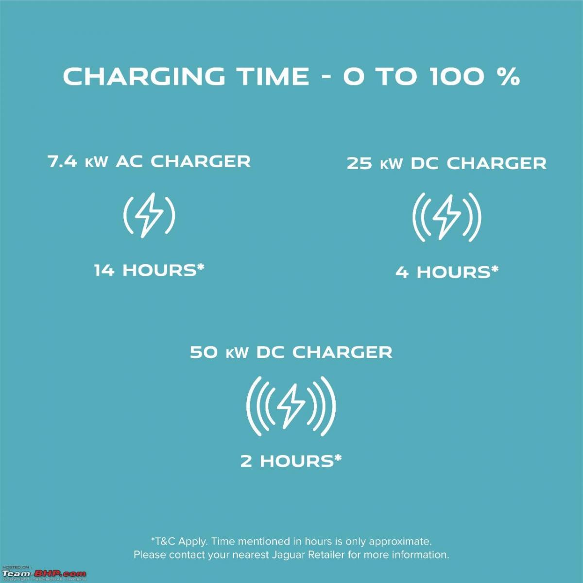

Now, the I-Pace comes with two home chargers, a 7 KW charger from Tata Power that they will set up, and a charger unit that I can directly plug into a 16A home power plug.

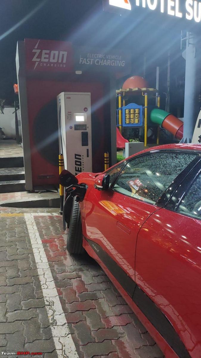

On the way, I charged at the Zeon Chargers, which was a wonderful 50KW charger. I made multiple long trips and Zeon chargers continue to help me.
