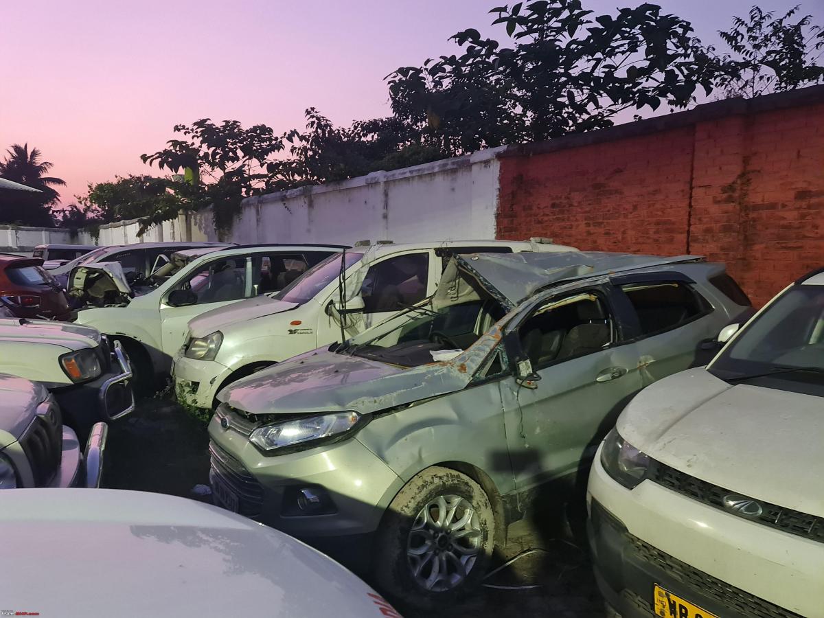

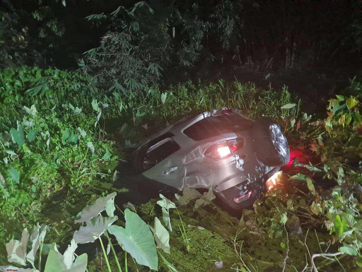

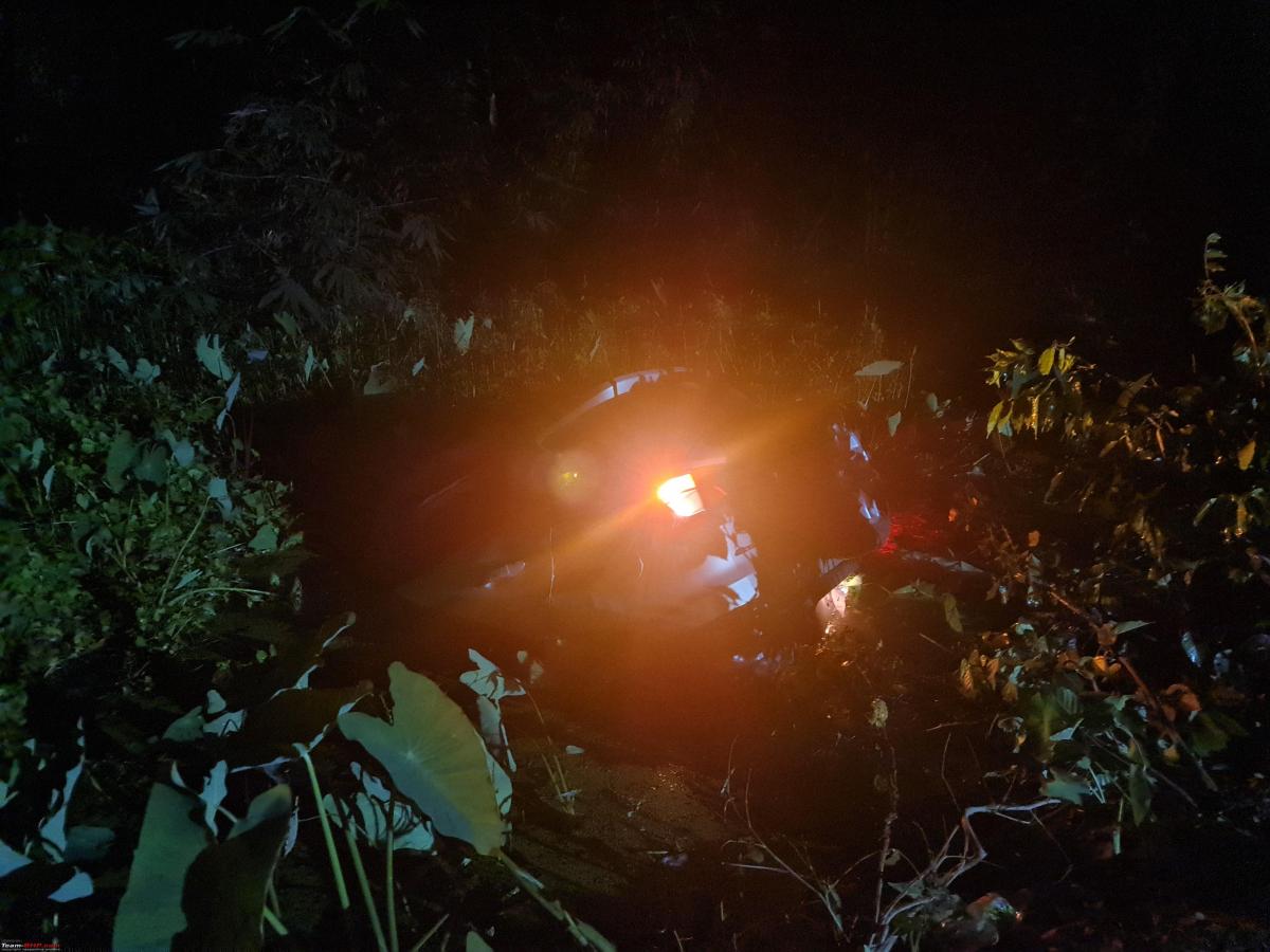

We were 3 friends returning from a marriage and the car was driven by my friend, while I was on the passenger side and one more friend on the rear seat. We were traveling at around 80 kmph on a state by-pass road at around 3 am, when a Tata 407 came head on which made us serve left and off the road completely with all 4 wheels outside the road surface and almost into a roadside pond, which was at least 4 feet lower than the road itself. Our car tilted left with left wheels touching the water, while still at 80 kmph, when my friend swerved right to get back up on the road but couldn't as the wheels couldn't grip. He kept on accelerating with the wheels spinning, hoping to bring the car up the road and avoiding getting submerged in the pond. The car was still probably at 80 kmph when suddenly the tyres gripped somehow and made the car jump up from the pond and on the road resulting in the car toppling on the left side and rolling at least 8 times and hitting a light post and breaking a wall after hitting it and God knows what else. Finally the ordeal stopped, with the car plunging into another pond couple of hundred metres down the other side of the road, just giving enough time to get out before getting 80% submerged. Luckily it was 3-3:30 am in the morning and there was no traffic.

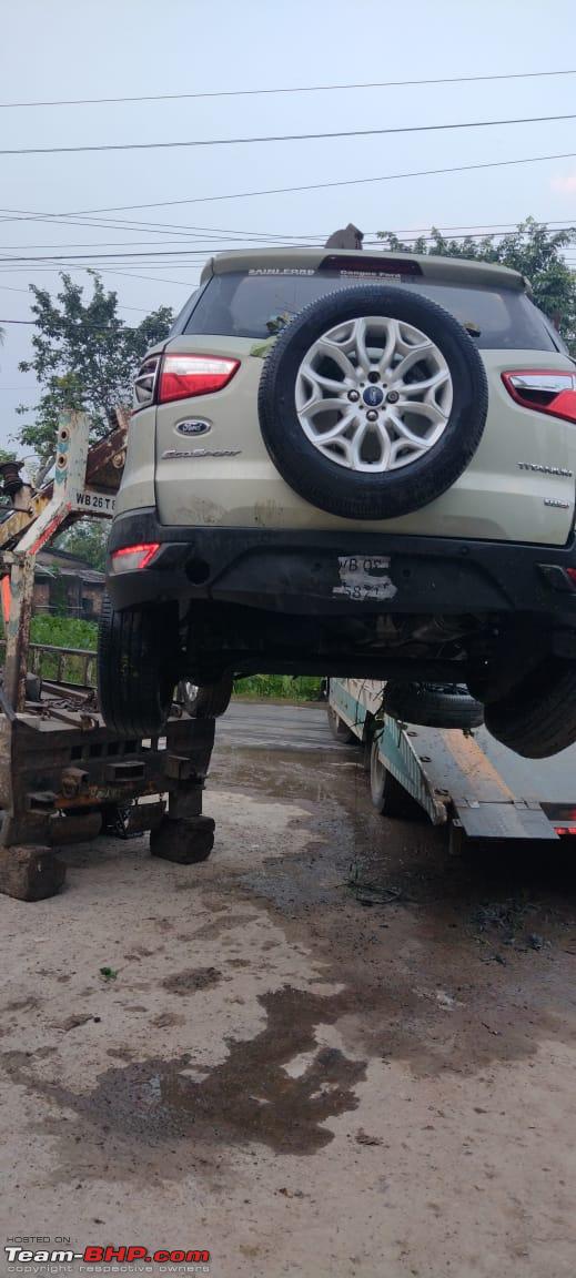

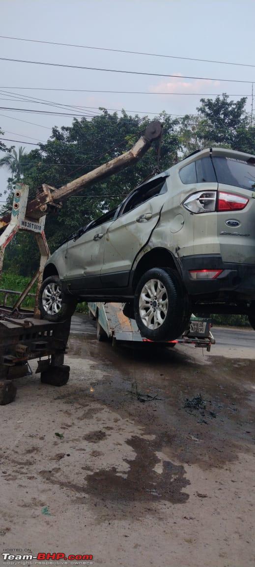

My car is a TDCI TITANIUM PLUS with 6 airbags and NOT A SINGLE AIRBAG DEPLOYED. NOT EVEN THE SIDE AND CURTAIN AIRBAGS. Yes, we were having our seat belts on.
The front windshield glass also shattered (on first impact with the road) like cheap glass which it is not supposed to. The glass is supposed to be laminated from both sides as far as my knowledge goes, to prevent it from shattering and falling off and becoming like armed splinters(which is actually what happened and injured us, specially me with glass pierced on my whole body).
While the build quality of the car saved our lives with just bruises from the flying glass splinters, from the horrific accident, I'm still in awe as to how not a single airbag deployed.
The Ford workshop is giving lame excuses that the car was not hit from the front. WHAT HAPPENED TO THE SIDE SENSORS FORD? They said side sensors get activated after the front sensors are triggered which i found to be a lame answer. When I showed them a video on YouTube on Ecosport crash test from side with the side and curtains deployed, they didn't have an answer.
Before I take it up with Ford, I thought of getting valuable inputs from this forum and getting myself armed sufficiently so as to not look like a fool when Ford gives me another lame excuse. I would now let the pictures do the talking.
