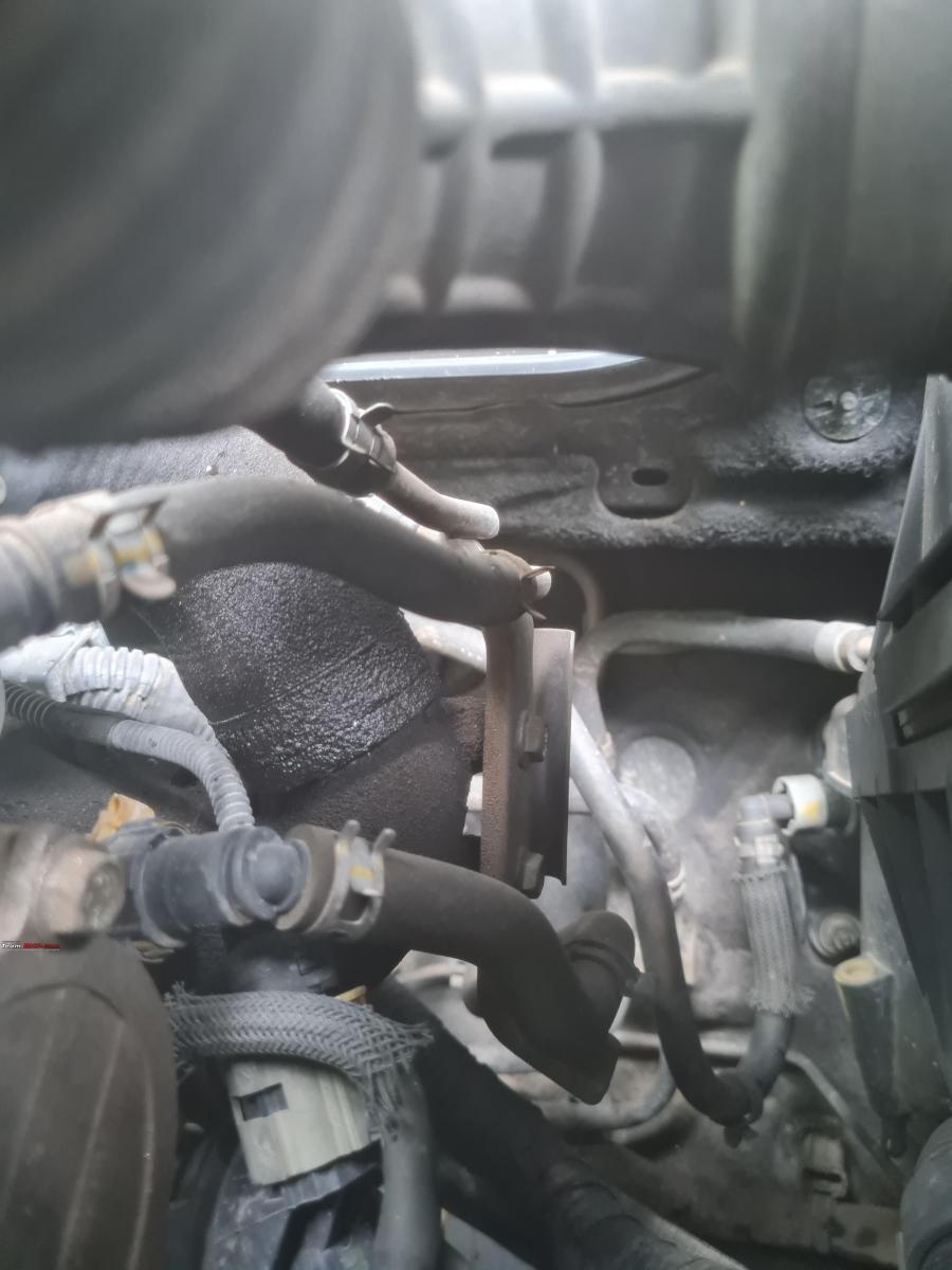

Come the Nov-Dec time frame, post a Calicut trip, the front strut started making the classic link rod sounds. kat-kat over uneven roads. Dr.N had just given the links to his upgraded Monroe link rods and I just ordered a set for myself as well. In one of the Coimbatore trips, went to shell and got a can of 5w30 at a premium price that I later regretted.
By Jan mid, the classic glow plug warnings started and I also noticed a leak from the EGR area.
I went in person to book the service yesterday and then today morning headed over to Nexa service centre with a boot full of parts.

Requested jobs:
  • Front Suspension
  • Link rod replacements
  • Front brake disc
  • Front brake pads
  • EGR cleaning
  • Intercooler cleaning
  • WA /WB as the link rods/suspensions are getting changed.
I was at the service centre till about lunch and then returned home. The SA did a great job and WhatsApp'd me the below pics.
