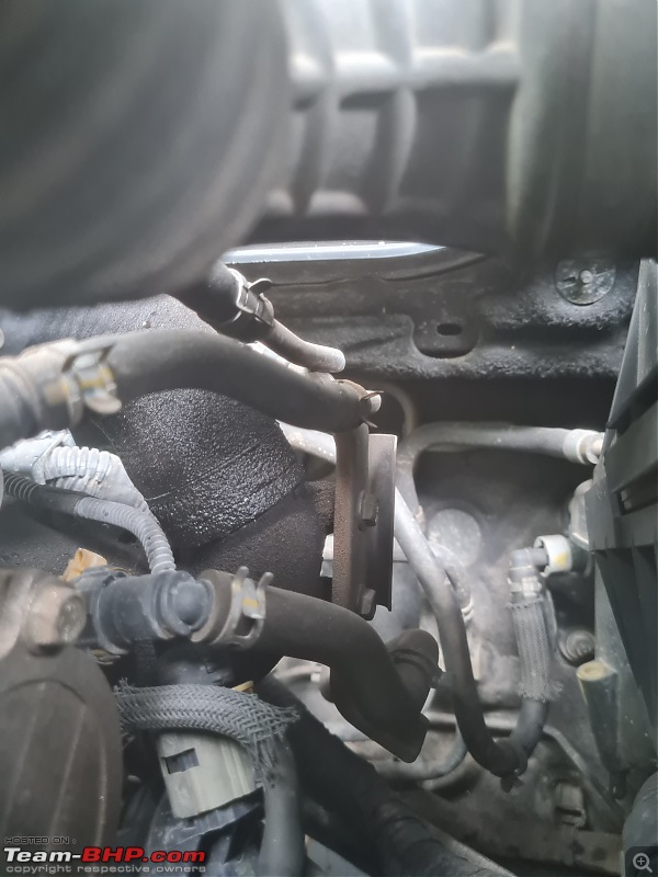

Come Nov-Dec time frame, post a calicut trip, the front strut started making the classic link rod sounds. kat kat over uneven roads. Dr.N had just given the links to his upgraded Monroe link rods and I just ordered a set for me as well. In one of the coimbatore trips went to shell and got a can of 5w30 at a premium price that I later regretted.
By Jan mid, the classic glow plug warnings started and I also noticed a leak from the EGR area.
Maruti S-Cross : Official Review-20230202_153013.jpg
Maruti S-Cross : Official Review-20230202_152826.jpg
I went in person to book the service yesterday and then today morning headed over to nexa service center with a boot full of parts.
Maruti S-Cross : Official Review-20230209_095705.jpg
- How was the EGR leak taken care of?
- And the glow plug warning? I had replaced one glow plug about some time back, but the error has returned.
- Have you gotten your timing chain replaced too?
I am also seeing an intermittent "Clean Parking Sensors" message on my MID.

1. EGR assembly was removed which contained the solenoid. The solenoid was then removed from the assembly. All the metal parts were taken to a dedicated parts washer and cleaned using (assumed) degreaser. There were some hose clips and some small hoses that were replaced. The EGR was chocked full of carbon.
2. The glowplug error was for the glowplug in cylinder 4. Got that replaced. Since I live in a tropical area, where the coldest it ever gets is low 20s. I am not too bothered. But, since it has failed for Cylinder 4, I know that it is bound to fail for other cylinders too. I have planned for this, and know that in the next 1 year other 3 glowplug will fail too.
3. Till now, there is no tell tale 'bell-ringing' sound which points to a timing chain replacement. As far as I am aware no one has yet done a timing chain replacement on the s-cross. I have not decided on how to proceed and when to plan for this. If other bhp-ians can advice it would be great.
4. I usually got clean parking sensors before the sensor actually went kaput. I have narrowed it down to the way in which I take my 2 wheeler out, it sometime fowls with the rear bumper and that might have caused the premature failure of this part. As far as I remember it is about 600 and is just a plug and play as the part has a connector built-in.

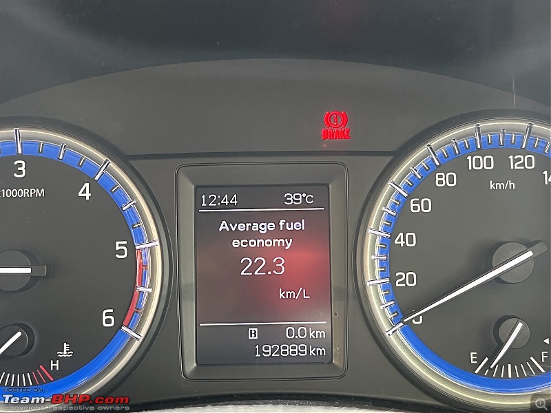

6.6 years with almost 193K on the odo, sold her to Cars24.
Maruti S-Cross : Official Review-ecf0448c83dc4c80b51cbae0890231cd.jpeg
Maruti S-Cross : Official Review-bb7739d8c0df41698548b5677ac3ee3a.jpeg
sinharishi is offline   (8) Thanks
