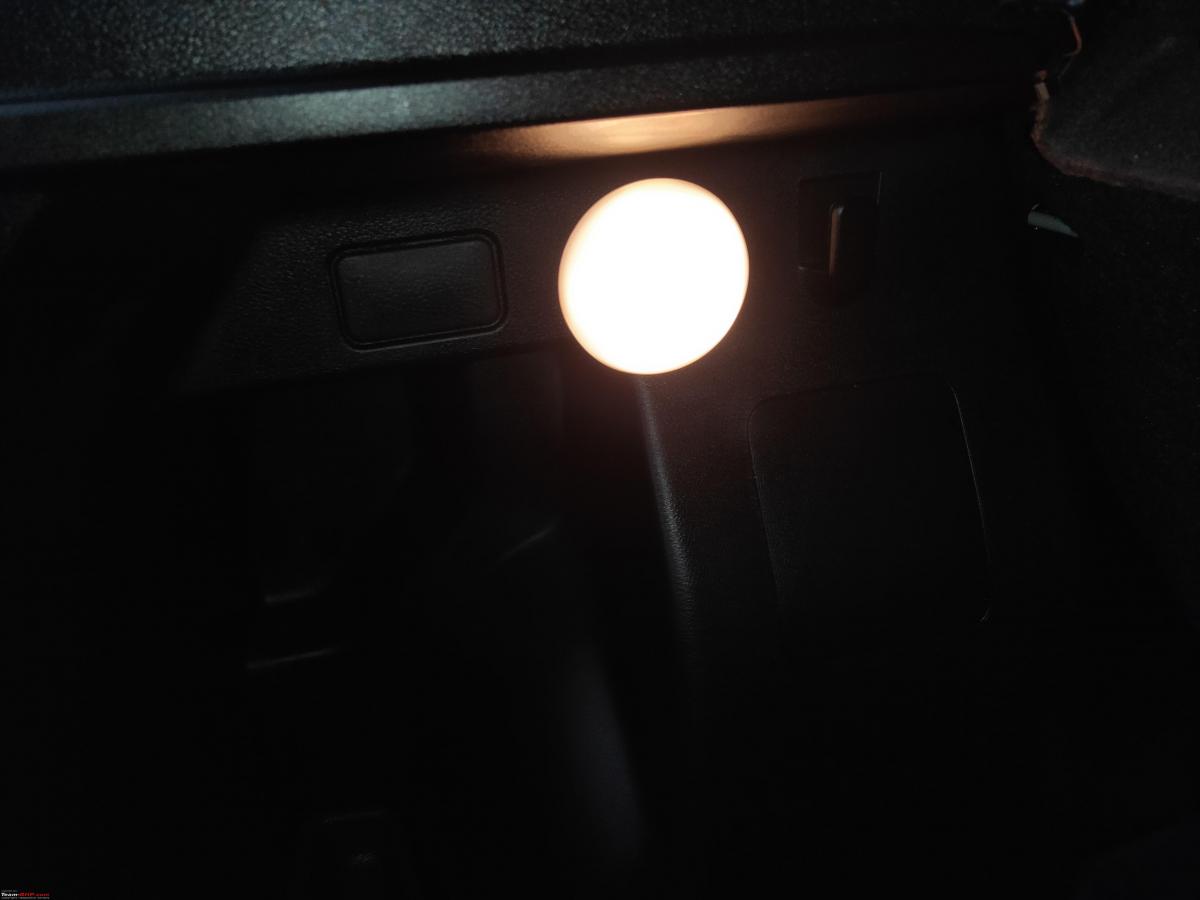

Below are the photos during daytime after fixing it:
How it looks like in the night time:
Now every time I open the boot the lamp comes on automatically because of the motion sensor.
